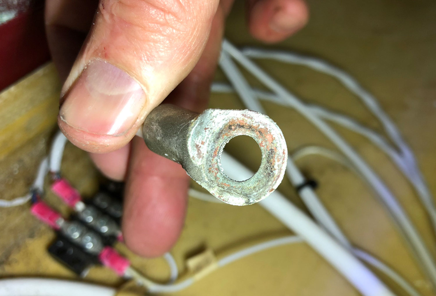

Turns out, though, this GlaStar also has a separate ground lead. Dang, I though that was going to be the issue! To eliminate other potential causes, I made sure the battery was fully charged—and it is only a couple of years old—before I pulled the first panel, but once I did, I knew that I’d found at least a partial culprit. As you can see from the photos, there was significant corrosion on the negative battery terminal. (The positive terminal was clean.) Ah-ah. That has to be it.
So I thoroughly cleaned the terminals and mounting post, and reassembled. I used the tried-and-true baking soda/water combination to neutralize the corrosion. I didn’t have any petroleum jelly at the hangar but did have a tube of dielectric grease, which I used instead to protect the terminal. I hit the positive terminal with some of that as well.
Success? Um, not 100%. Better, definitely better, even swinging the prop on a cold-for-Portland morning. But there’s still the hitch in the start sequence that makes the OCD in me go a little haywire. As the annual progresses, I’ll follow the ground path all the way to the engine and double-check all of those connections. Like so many things in aviation, most maladies (real or imagined!) are the result of a chain of things, not one miscue or fault. Bottom line, though: Mind your terminals!
