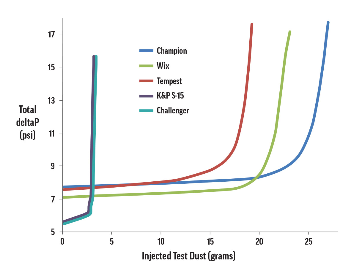

Capacity is straightforward. As a filter media becomes saturated with captured material, its resistance to flow rises rapidly. Capacity establishes the total mass held by the filter when differential pressure (deltaP) across the element reaches a predetermined value. The minimum per ARP 1400B is 15 grams at 8 psi for a filter with a built-in bypass valve, typically identified as xx108 and xx109 series in the GA world. The spec is 15 grams at 20 psi for a filter without a bypass, but the higher pressure has no practical value, because those filters (xx110 and xx011) are installed on an adapter with its own 11 to 13 psi bypass.

The ISO 4548-12 multi-pass method is conceptually simple. A dilution system continuously injects contaminant into a fluid loop at a carefully metered rate. The fluid in the loop (MIL-H-5606, i.e., Aeroshell 4) is dosed with an anti-static and held at 100° F to control viscosity. A constant displacement pump moves it around the loop at 6 gallons per minute, similar to our small flat engines at cruise rpm. A laser-based device (most commonly a Pamas 4132) records particle count and size before the flow enters the filter. Downstream, an identical device counts and sizes the particles that passed through the filter. The flow continues around the loop, where it picks up more contaminant.
As the test progresses, the filter accumulates particles, which hinder flow. The differential pressure, measured across the element, slowly rises but as the element nears capacity, the rate of rise steepens significantly. The test is terminated at some specified deltaP, typically selected to remain well below the opening pressure of the filter’s bypass valve. The total capacity of the filter is recorded in grams; see Figure 8.

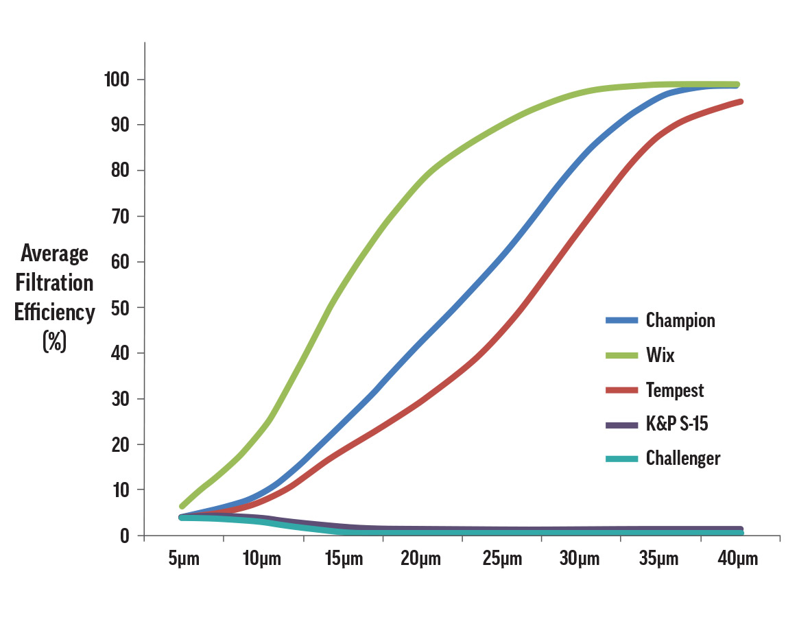

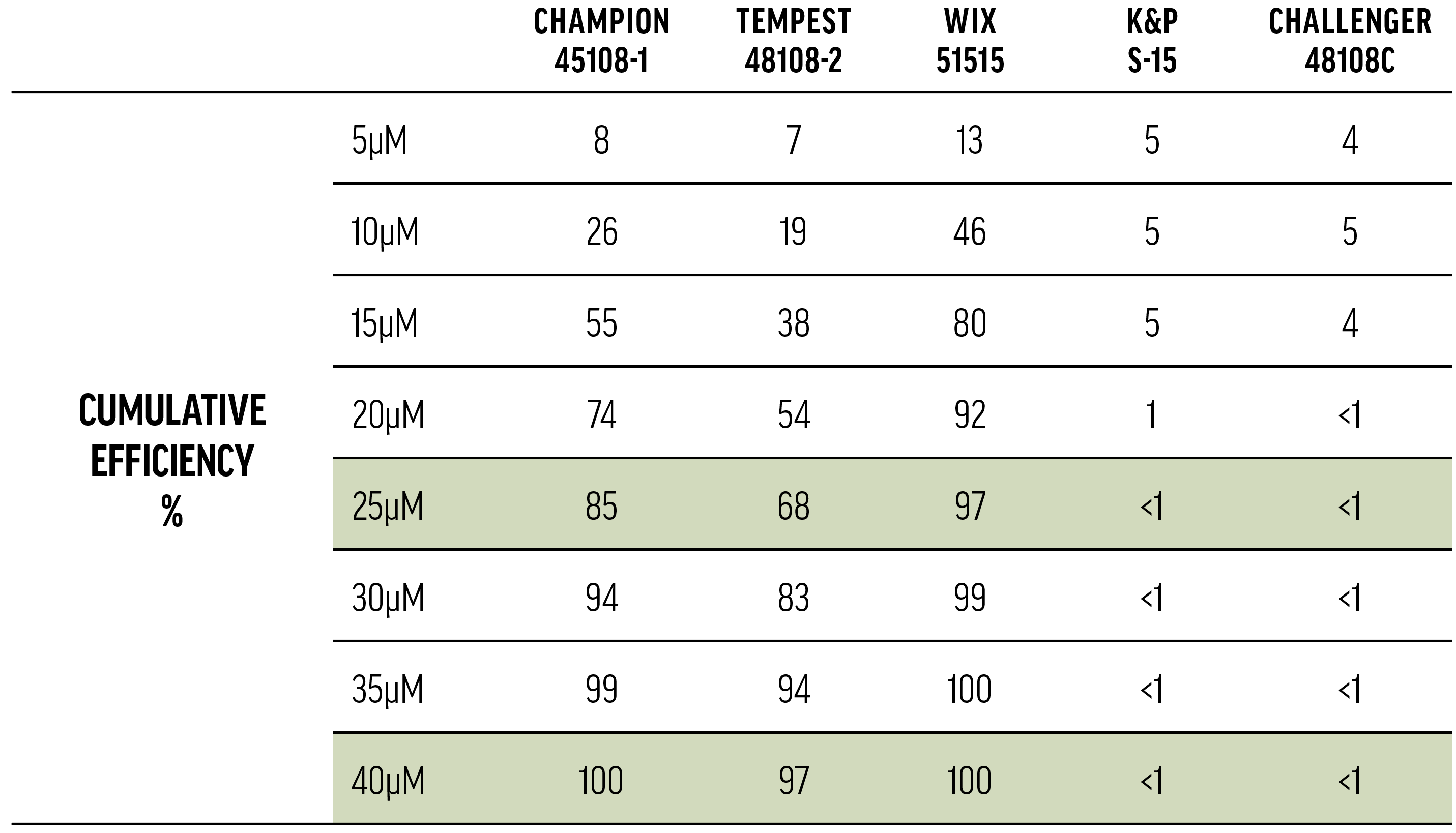

The summary table in ISO 4548-12 format can be seen in Figure 3A. We’ll use the Champion as an example. Efficiency was recorded at 10-minute intervals until termination at 110 minutes, then averaged. Recall “cumulative” means “this size and larger,” so the filter captured 4% of all particles 5µm and larger, 61% of all particles 25µm and larger and 99% of all particles 40µm and larger. Figure 9 presents the same efficiency results in graphical format.
Sharp readers will note neither Champion nor Tempest met the 75% at 25µm standard of ARP 1400B. To be fair, 1400B specifies 8 psig termination, not 10, and efficiency tends downward as the filter collects more trash. An average based on 8 psig termination would look a little better, but we rarely collect even that much dirt. A new, clean Champion meets the standard and a new Tempest gets close (Fig 3B). If you like ’em, use ’em.

Figure 3A: Summary table, cumulative filter efficiency, average clean to fully saturated per ISO 4548-12.
oil filter testing6.31
Figure 3B: Cumulative filtration, near new.
Retained capacity is more than adequate with the Champion, Tempest or Wix. None rise above 8 psig until well beyond the 15 gram minimum of ARP 1400B.

The Wix demonstrated better efficiency than the Champion or Tempest. However, be aware 1400B’s structural standards don’t apply to auto filters. For example, Wix lists the 51515’s burst pressure at 290 psi, well below the 500 psi of the aircraft brands. Although unlikely to be an issue for a user running multigrade aviation oil in a temperate climate, use of 50-weight oil in low temperatures could change the picture. Minor caveats include the lack of an installation nut, no safety wire provision and users must add a nipple if installing on a xx110 application.
As noted, this particular Wix was selected merely because it was representative of a respected auto filter. Quite a few Experimental/Amateur-Built owners already fly it as a replacement for a 48108. However, it’s certainly not the only choice and readers should not consider its appearance here as a recommendation. Readers who wish to go full auto might also consider offerings from Baldwin, Donaldson and Purolator, which like Wix is a Mann+Hummel brand. Read those specification sheets!
The test values recorded for the two screen filters are not misprints. A woven screen offers one opening size across its entire face, defined by the wire size and weave pattern. As such, they tend to act as a sieve or separator, allowing essentially all contaminants smaller than the openings to pass while blocking all contaminants larger than the openings. This is distinctly different from a depth media, a comparatively thick fiber mat with a limitless variety of pore sizes and flow paths. While a screen tends to sort particles in an absolute pass/no-pass manner, a depth media stops some percentage of all particle sizes.

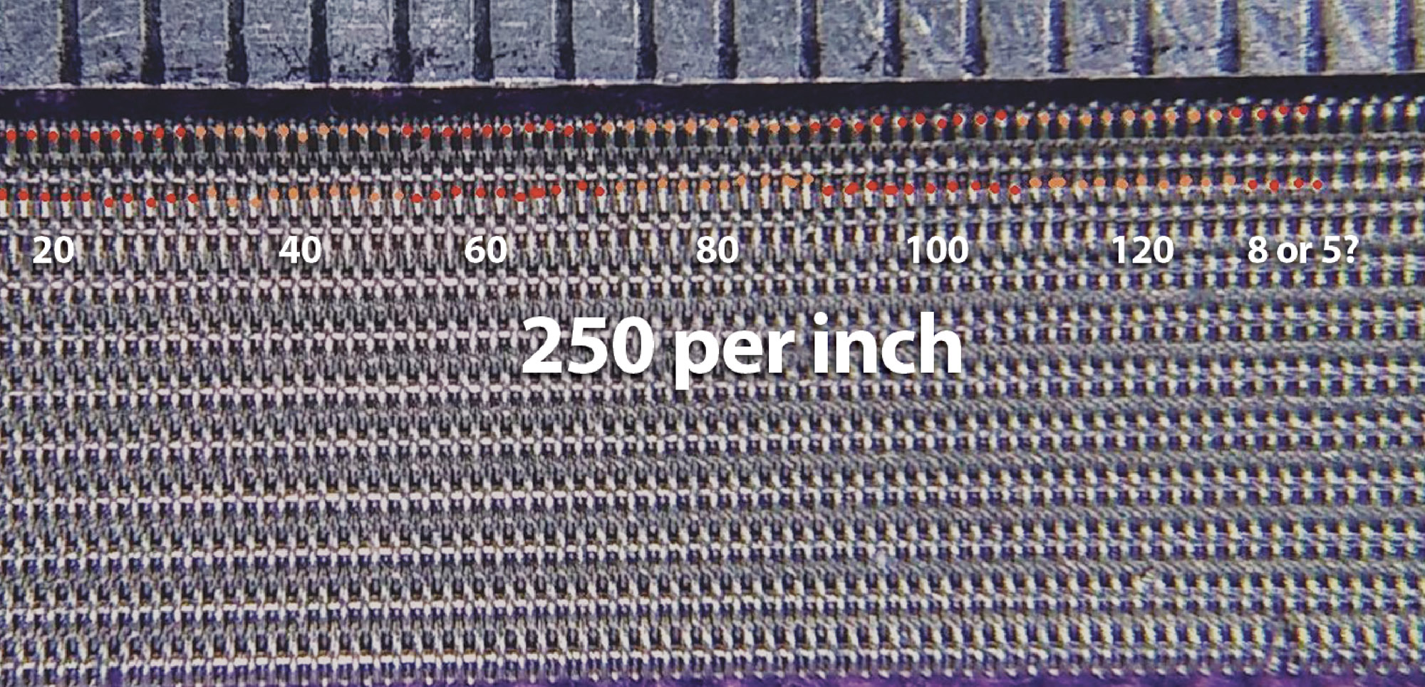

Let’s look at the images. Figures 4 and 5 show photos taken at 10x magnification. These and others identify both the screens as 50×250 plain Dutch weave, a widely used industrial cloth.
oil filter testing weft
Figure 4: Weft count.
oil filter testing warp
Figure 5: Warp count.
In addition to warp and weft counts, the cloth can be further identified by measuring the wire diameters (0.0055-inch and 0.0045-inch, respectively) and a woven thickness of 0.012 inches. A key visible characteristic is the widely spaced warp wires and the tightly compressed weft wires. When viewed perpendicular to the surface, there are no visible apertures. Flow passes through the weave at an angle, as seen in Figure 6.
To ensure accuracy, the samples were sent to a professional wire mesh calibration lab for a second opinion. The lab confirmed near identical counts for the S-15 (51×252) and Challenger (51×252), as well as the fabric type and typical performance.

Note the retained capacity and test time. The screens clogged at 3 grams, well below the 15 gram requirement of ARP 1400B. As they clogged, the deltaP ramped up sharply, rather than exhibiting the more gradual rise of a depth media. It’s a characteristic of screen filtration called blinding—the obstruction of the openings in the filter, which are uniform and limited in number. When operating in a constant-pressure system, blinding generally results in the formation of a filter cake and a drop in flow. However, when operating downstream of a constant displacement pump (i.e., an engine oil pump), the pressure must spike.
The screens did offer less clean pressure drop, a detail often quoted in their favor. However, here it is limited and doesn’t last long. There simply isn’t enough media area. Figure 7 is a visual comparison of a Champion element and a Challenger element, hung together on the shop door. Figure 8 is a summary of pressure drop across the filter elements vs. circulated contaminant.
oil filter testing fig8
Figure 8. Total filter pressure loss vs. injected A3 Medium contaminant.
oil filter testing fig9
Figure 9. Cumulative average filtration efficiency, all filters.
