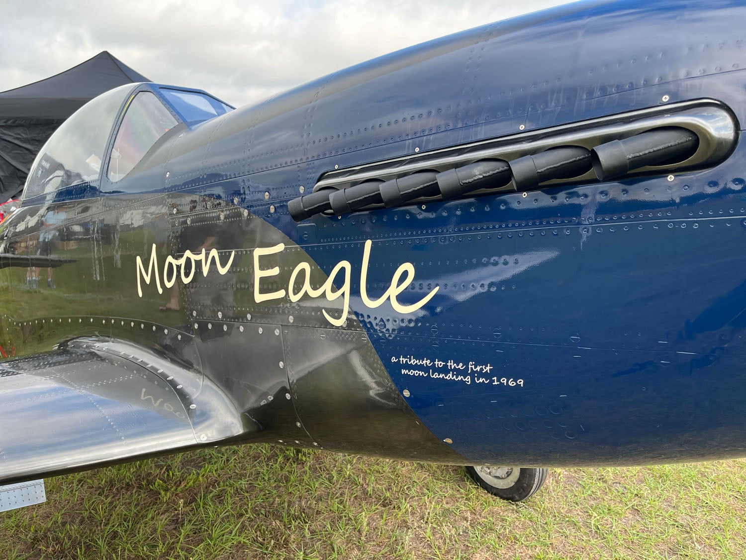

Every year at Sun ‘n Fun one or two planes generate a buzz that sparks everyone’s interest. This year, that plane is the Scale Wings SW-51, straight from Eggenfelden, Germany. What distinguishes this 70% replica of the iconic P-51 Mustang fighter of World War II is the unbelievable attention to detail. The whole airframe is made from carbon fiber composite, but you have to get within 18 inches of the surfaces to see what all the talk is about.

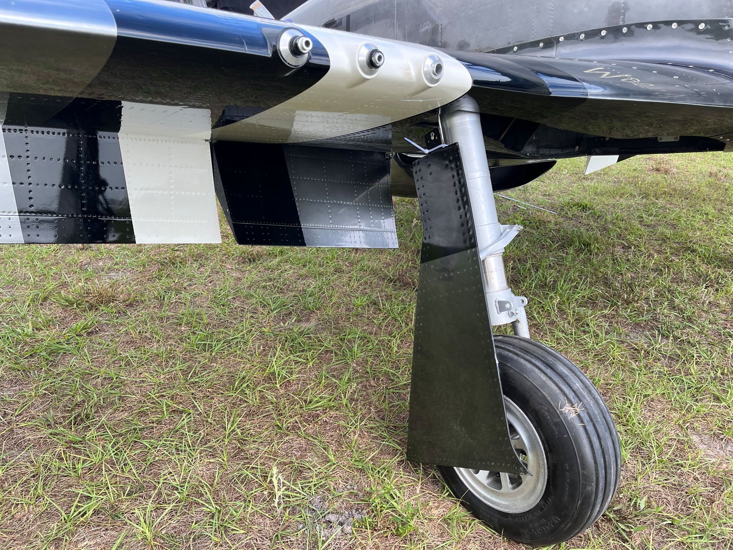

This scale model is truly to scale. Every single skin rivet on the P-51 is reproduced in carbon fiber. Approaching the aircraft, even a seasoned homebuilder would conclude that the SW-51 is a flush-riveted aluminum structure. That observation is confirmed by looking in the cockpit and seeing the shop heads on the rivets. But in reality, it ain’t so. All of the rivets, even the interior shop heads, are molded reproductions of the original Mustang. SW-51 design engineer Hans Schwoellor, formerly an RC model developer, constructed the molds in over 16,000 hours, painstakingly recreating every panel line, every fairing and every rivet to exact 70% scale. The attention to detail is jaw dropping.

One final bit of data will lead any pilot to simply slap their forehead and start to laugh uncontrollably. Although powered by the ubiquitous Rotax power plant, the carbon fiber cowling efficiently masks its normally high frequency buzzing rasp. The most prominent sound coming from the SW-51 on a low pass comes from the scale 4 bladed carbon fiber prop. You will simply not believe it until you hear it for yourself—see the video below. Turn up the volume and you will hear the unmistakeable sound of an Allison/Rolls-Royce V-12.

I wonder how much parasite drag those faux rivets cause? I wonder if they will make one w/o them.
