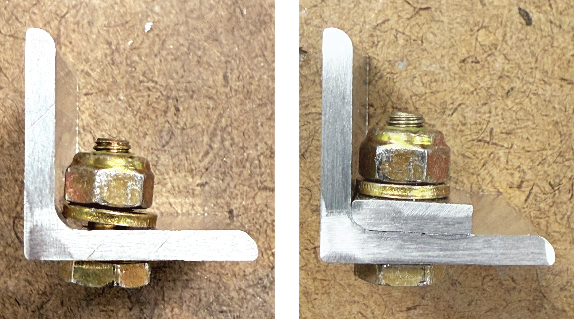

radius washer
The fillet of this extrusion prevents the nut and washer from seating properly. The right photo shows how a radius washer resolved the interference.

radius washers 16

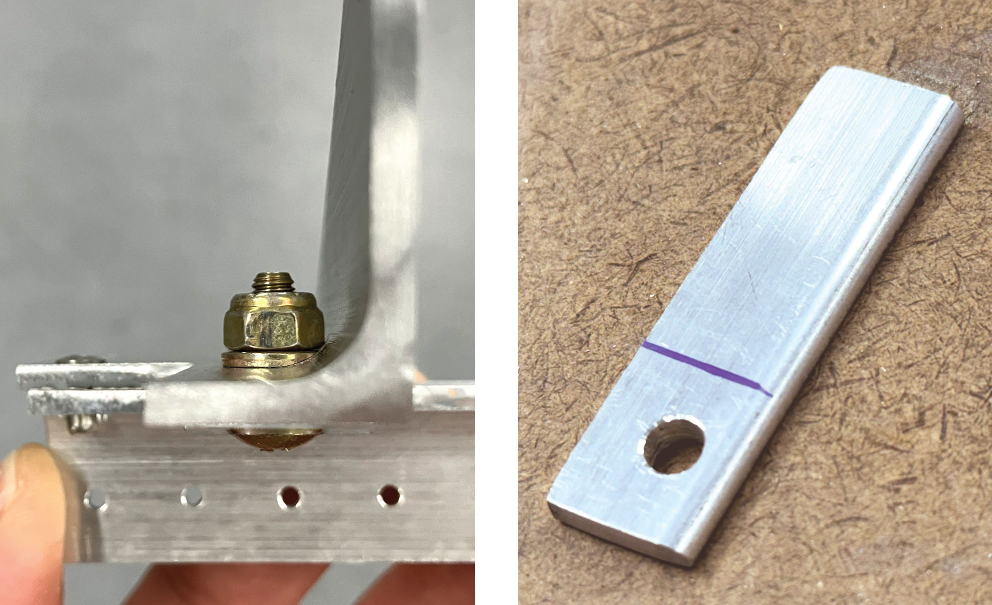

An AN washer can be made into a radius washer, though one may prove too thin. This one barely kept the nut from interfering with the fillet (left). This radius block was made from the edge of an extrusion, eliminating the need to grind a matching radius. I kept the blank long so it could be clamped to the part for match drilling. The last steps are to cut it to length (the blue line), deburr, and install it (right).

Radius Washers
A radius washer is made from an AN washer. One…er, edge(?) is contoured to nest with the fillet, providing a flat surface for a fastener. The benefit of using an AN washer is there is no need to drill a a hole through it it for the fastener. The downsides are it can be difficult to grind the mating radius on a washer, and keeping the radius on the washer engaged with the fillet while installing a nut can be…just as difficult.

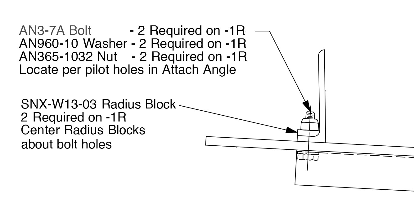

Radius Washer Radius Block DWG FORES
Sonex plans include this use of a radius block.
Radius Block
A radius block made from a piece of aluminum whose thickness is equal to the thickness of the part works well, but the ideal material for a radius block is the curved edge of a scrap of the same extrusion that needs the washer. The reason? An extrusion’s edge radius matches its inside fillet, eliminating the need to grind the radius and guaranteeing a perfect fit. The downside to making a radius block is it can be futzy to drill the hole for the fastener.
To drill an accurate hole, the radius block should be match drilled and step drilled together with the hole in the primary structure. When the need for a radius block comes to light after a fastener’s hole has been drilled, drilling the radius block separately is your only option. My method is to clamp the radius block to the part, mark the hole’s location on the radius block with a drill bit equal in diameter to the hole’s size, unclamp the radius block, and step drill the hole to size. If, following this technique, the hole ends up a little off, the radius block can be incrementally modified until the hole is properly positioned. If that doesn’t work, start from scratch making a new radius block.

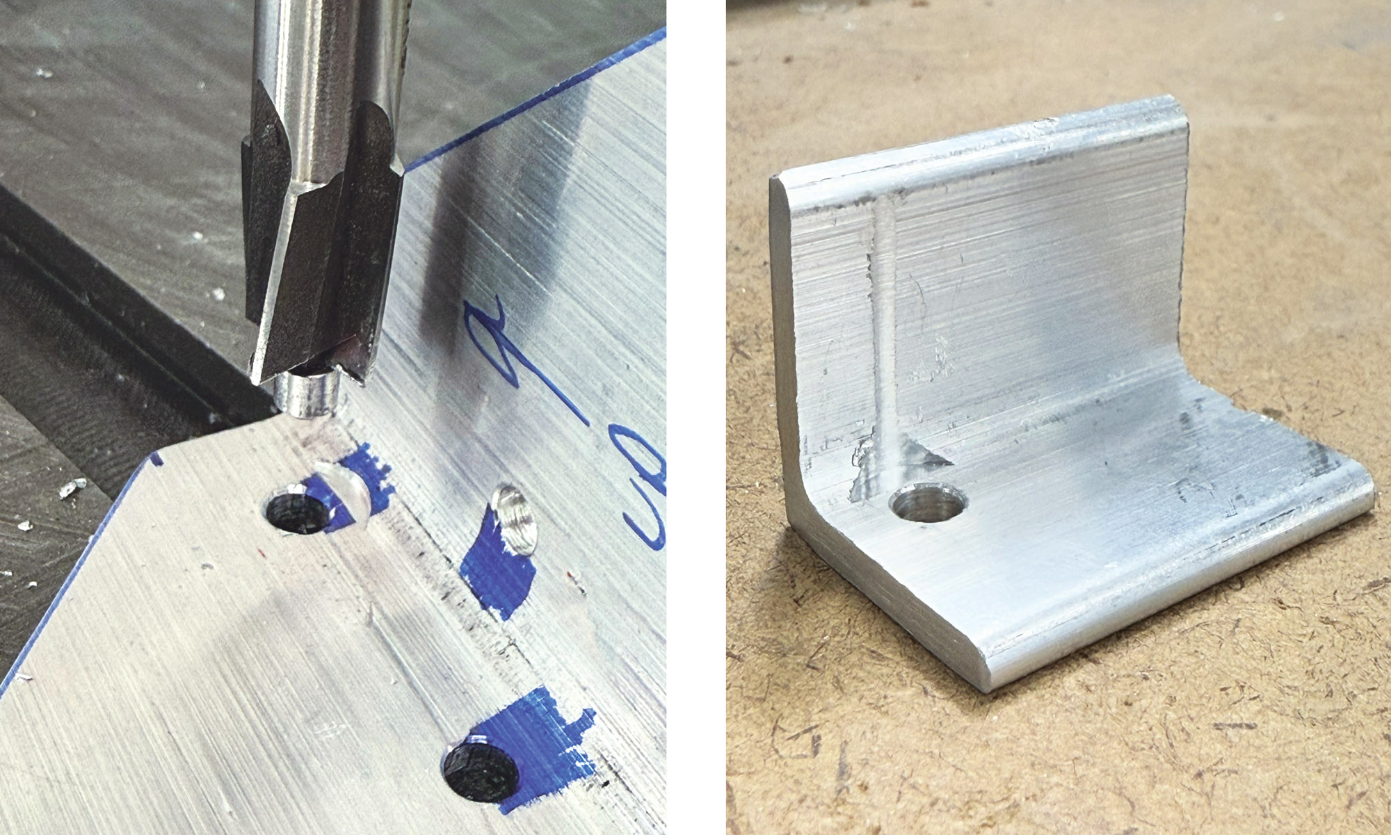

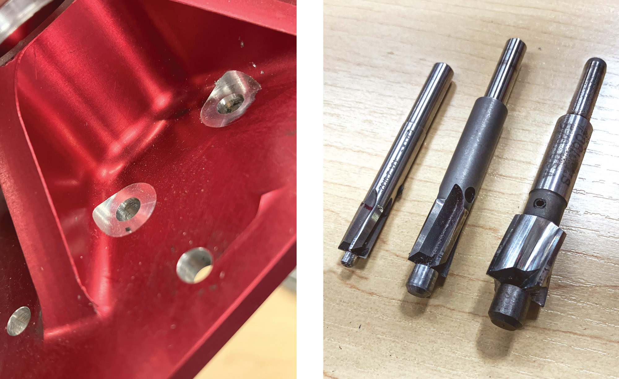

This part incorporates spot-faced holes in the design (left). Counterbores come in any size a homebuilder may need and are inexpensive (right).
Spot Facing
Spot facing is a machining technique that smooths/levels an uneven surface around a hole. Whereas radius washers and blocks add material, spot facing removes material. Spot facing can be employed to remove the portion of a fillet that interferes with a fastener. In a well-designed airframe, the small bit of material that is removed shouldn’t compromise a part’s strength. However, before spot facing a part that doesn’t call for it in the kit’s documentation, contact your kit’s tech support staff.
radius washers 15
I colored the fillet with a blue marker so my spot-facing progress would be obvious. The goal is to remove only enough material so the hardware sits flat (left). This part was irreparably damaged by a counterbore because the hole is too close to the fillet to be spot faced (right). A radius block should have been used.
Spot facing is done with inexpensive counterboring tools. Ideally, parts are spot faced on a drill press because it’s tricky to spot face a hole with a handheld drill—the counterbore is asymmetrically loaded when it engages the fillet, which makes it prone to chatter. Use a counterbore whose diameter is equal to or slightly larger than the width of the washer/fastener that will occupy the space and has a pilot equal to the diameter of the hole being spot faced. Reverse counterbores are available for tight spaces, where the body of a drill won’t allow the use of a standard counterbore and the part can’t be clamped on a drill press.
Though spot facing is accomplished with a counterbore tool, spot facing and counterboring differ. Spot facing removes just enough material to level a surface—maybe a smidge more. Counterboring goes below a part’s surface to meet a dimensional requirement or to place a fastener flush with, or below, a part’s surface. Our goal is only to spot face.
