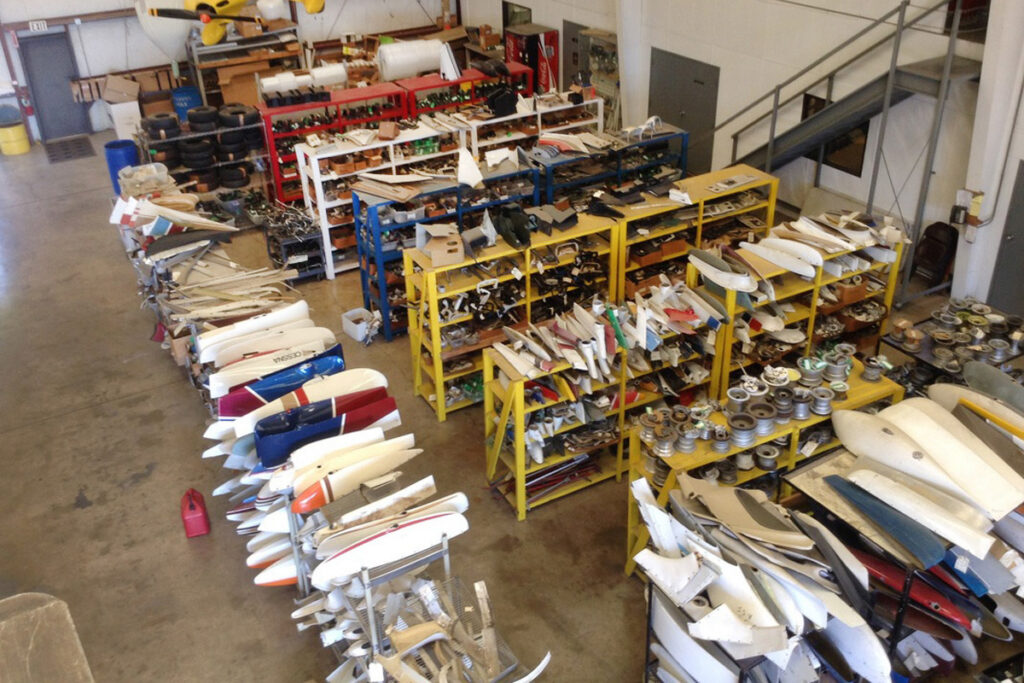

For homebuilders, aircraft salvage yards represent an attractive source of airframe components, engines, avionics, landing gear, instruments, and countless other parts at substantial discounts compared to new. Yet this cost advantage brings questions about safety, regulatory compliance, and practical considerations that every builder should understand before heading to the boneyard.

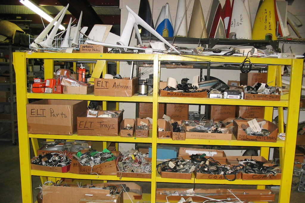

![A large assortment of miscellaneous parts are available. [Credit: Air Salvage of Dallas]](https://www.kitplanes.com/wp-content/uploads/2026/03/1931543_orig-1024x683.jpg)

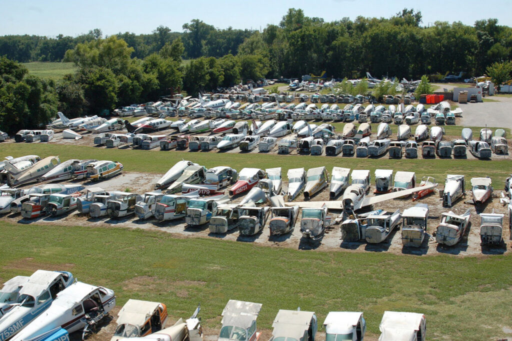

![If an aircraft part has been manufactured and installed on a certificated aircraft, it can be found in a salvage yard warehouse. [Credit: Air Salvage of Dallas]](https://www.kitplanes.com/wp-content/uploads/2026/03/8014815_orig-1024x683.jpg)
