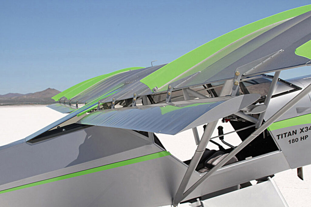

![Aircraft control surface designs may include counterweights to offset and eliminate flutter. The counterweights should not be eliminated to save weight. [Credit: Kitplanes Archive]](https://www.kitplanes.com/wp-content/uploads/2026/03/kitfox-s7-sti-04-1024x682.jpg)

Back when I first began reading this publication around thirty years ago, there were (according to my admittedly questionable memory) a number of incidences with Kitfox aircraft builders omitting the flaperon counterweights due to said builders not seeing the point of all that weight being added. Again, I applaud their weight conscientiousness, but those bits of weight are important in that application. Why?

By counter balancing the control surface, the center of gravity of the combined assembly moves forward toward the hinge line. The aileron will now be much more flutter resistant as the up-down forces are being resolved at or near the hinge instead of in the middle of the aileron. This does make the assumption that the wing itself is rigid enough that there is no (or effectively no) wing flex or twist, which in itself can contribute to flutter.
A 100% balanced aileron or flaperon will be neither nose-high nor nose-down if disconnected and at rest on its hinge (assuming one of the frictionless hinges so prevalent in engineering classes). An under-balanced aileron will be tail-down, and you can figure out what over-balanced is. All of which I mention to say that an aileron does not necessarily have to be 100% balanced, it simply needs to be balanced enough to forestall the onset of flutter below Vne. Also keep in mind that your Vne may itself be a function of anticipated flutter speeds. Of note is that it may be that a control surface is only 75% balanced because that is enough to ward off flutter, and no need to add more weight than absolutely necessary. It all depends upon the control surface and its expected flight regime. If for example, an airplane is drag limited to 120 mph, then the control surface needs to be good only to that speed, plus a bit of safety margin. Again, no need to add weight that isn’t needed.
Go search for photos of a P-38 and you can see the elevator counterweights protruding from the middle of the tail plane, or a de Havilland DH.88 Comet with its rudder counterweight sticking out in front of the rudder. Why? Because balancing the control surface is a tradeoff between a short control arm with more weight, or less weight and a longer control arm. In the case of the P-38 and Comet, the aerodynamic drag of the exposed weights was an acceptable trade-off in packaging and less weight. For the same reason, our various homebuilt designs employ a mix of internal and external counterweights.
A shorter control arm typically allows for embedding the counterweight inside the wing or empennage structure and keeping it out of the airflow. However, this does require a very dense material for the counterweight in order to keep it as small as possible. What to use? Typically lead on our homebuilt aircraft, but often depleted uranium (DU) on large commercial airliners and cargo planes. Why DU? To allow a short moment arm and keep the counterweight tucked out of sight and out of the airflow. For what it’s worth, those DU counterweights are encapsulated in a thick paint and stenciled with explicit instructions not to grind or machine; it may be depleted, but you still would not want to breathe that dust!
