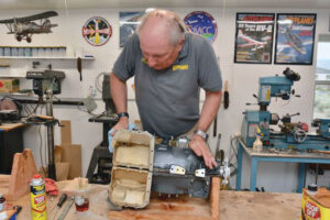

So now it’s time to put things together. For our engine, the crankcase got back two weeks before the steel parts, so we took the time to clean and inspect, then to mask and paint the outside of the case. In its disassembled state, we could shoot paint in some difficult places, and we ended up with a nice-looking engine—even though we just painted it standard Lycoming Gray (Aircraft Spruce has this paint in spray cans).
Here’s one trick to masking the case: If you have the old cylinders lying around, clean up a couple of them so that you won’t get anything greasy or oily, then paint the case halves individually, separation plane (spine) down, the old cylinders just sitting in their locations without any bolts. That way, you’ll get no paint on the mating surfaces, and the paint will go right to the edge of the cylinder bases so that there will be no gap in the paint when new cylinders are installed. It makes for a lot less masking!

Plan on a couple of days for assembly—and don’t be surprised if, indeed, you run into one of those surprising parts shortages, like our rocker-arm thrust buttons. We didn’t let that bring us to a halt—we simply finished installing the rocker arms and shafts, then put two screws in each rocker box cover to hold them in place should the newly reconditioned shafts creep out due to gravity. When the buttons showed up, we finished the job.
Also, don’t be in too much of a hurry to put everything on the engine. It’s up to you if it is easier to put baffles on before or after hanging the engine (we waited until after because we didn’t risk dinging them with the hoist), but until the baffles are installed, you can’t install the dipstick tube permanently. You’ll also probably want to wait on spark-plug wires and maybe even the magnetos—it can be a tight shimmy getting those through the engine-mount ring. We leave spark plugs out because we know we’ll be turning the engine during the installation of the prop—and we’ll be timing it—so no need to crush those washers twice. We did install the starter and alternator, as well as the prop governor, because it is easier to do those when you have more room to work. So, think ahead.

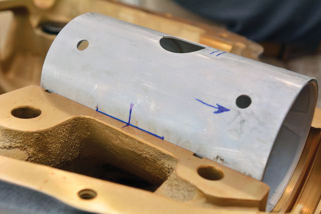

After we had fully assembled the lower end, we put it on the engine stand, added torque plates and brought the through-bolts and -studs up to full torque; this is to ensure that the crankshaft bearings were properly bedded. The engine spun effortlessly (indicating the bearings were perfect) right up until we heard a “clunk.” And then it stopped. Something was interfering internally! We carefully moved rods around and even installed the idler gear between the crank and camshaft to see if it was a timing problem—and the clunk remained, though sometimes it moved beyond that spot and sometimes it didn’t.
Removing one torque plate, we shined a bright flashlight inside and soon found the problem—the rod bolts were hitting the camshaft! The contact was between cam lobes, so it wasn’t timing—the heads on the bolts were actually protruding too far and hitting the shaft.
Phone calls ensued to various experts we keep on speed dial and for whom we have the deepest respect. Part numbers were exchanged and looked up, and we concluded that the part numbers on our rods were not correct for our engine—which, according to every bit of data we had, had never been opened up after leaving the factory. The bolts we had were the right ones for these rods, according to Aircraft Specialties, but they were “big head” bolts, not the shorter ones more frequently used in the O-360. It was clear that we needed the short-head bolts, and Aircraft Specialties promised to have them to us by noon the next day—even though they weren’t at fault in the slightest.
Our next call was to Lycoming. They keep build records on every engine that has left the factory since time began. We were pleasantly surprised to get a live person from tech support very quickly. He listened intently to our problem and promised a return email as soon as he could research the issue. He took down our engine model and serial numbers, and we left him to research while we grabbed some lunch. In about a half-hour, we had our answer—sure enough, a range of serial numbers produced in a row had this part-number rod substituted (probably because of supply issues) for the more common rod, and a service bulletin was issued to memorialize this fact. Bottom line, though: The rods were approved for our use and, yes, they needed the short-head bolts. We took the afternoon to catch up on other things, went four-wheeling in the mountains the next morning and the brown truck showed up so that we could proceed at 11:00 a.m. We didn’t lose much time, and the short-head bolts solved the problem.
