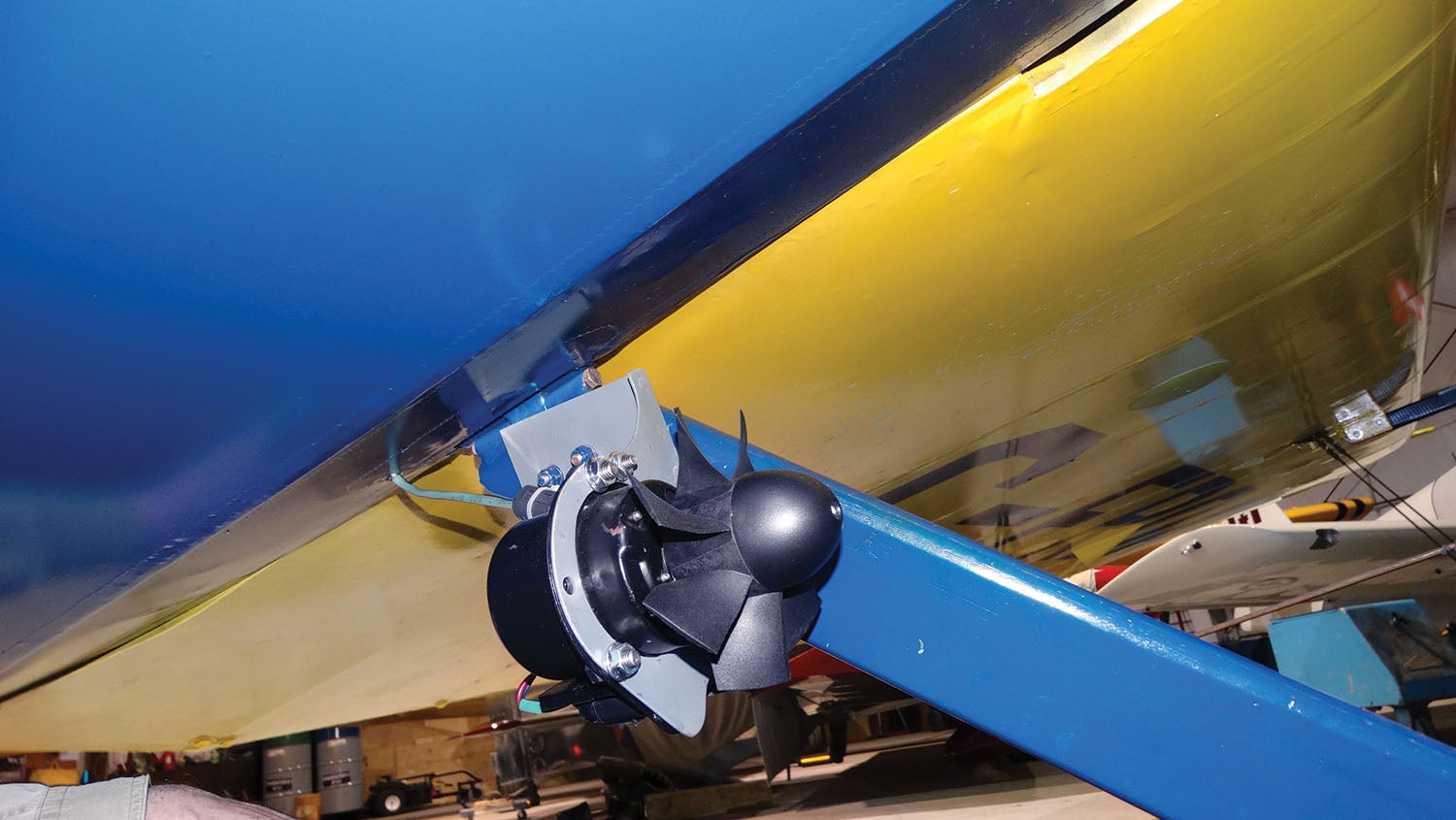

Wind generators are not engine-driven so they meet the exclusion requirements.

If not, though, consider: How much do you need a generator or alternator in your airplane?
I’m not saying to leave off the radios or to steel yourself for a lifetime of hand propping. Leave off the generator/alternator and count on using an external charger between flights to keep the battery topped off.
Retain the starter, even without a generator. A typical aircraft battery will last very nicely through a flying day, even two. Some folks say they can get 10–20 starts from a common Odyssey PC-680 dry cell battery. My generator went bad about 20 years ago, and I flew a whole summer without it. My Fly Baby has an external jack that lets me easily plug in a battery charger between flights. Usually, I plugged in the battery to charge during preflight and again when I got back home for the day. I never ran short of power.
If you’re building, put in an entire electrical system except for a generator. This is how you present the airplane to the DAR: no electrical system. That way you qualify for the exclusion and can fly within the Mode C Veil without a transponder or ADS-B Out. And it’s marvelous how much simpler wiring is when all you have to connect is a battery, switch and radio.
