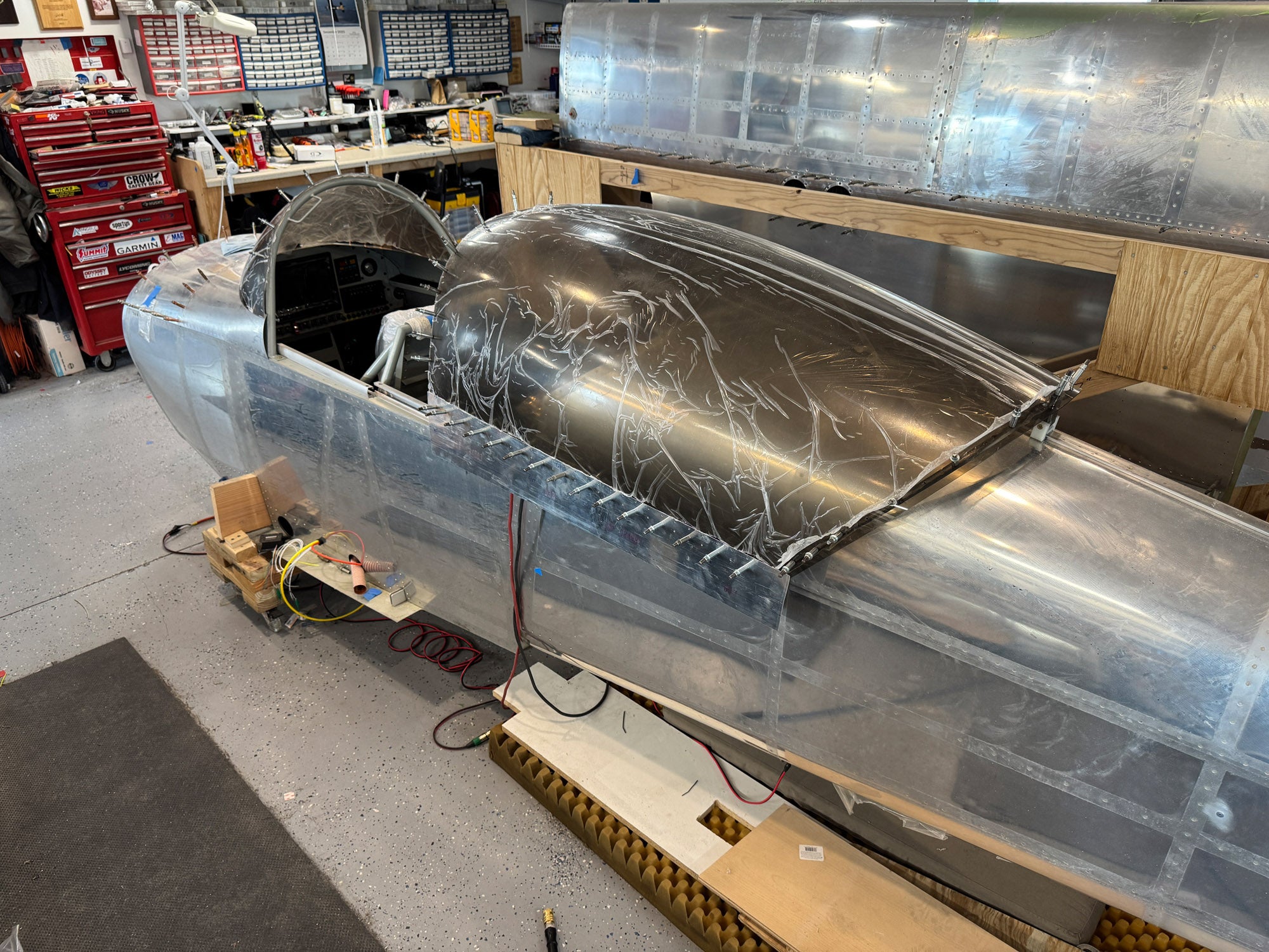

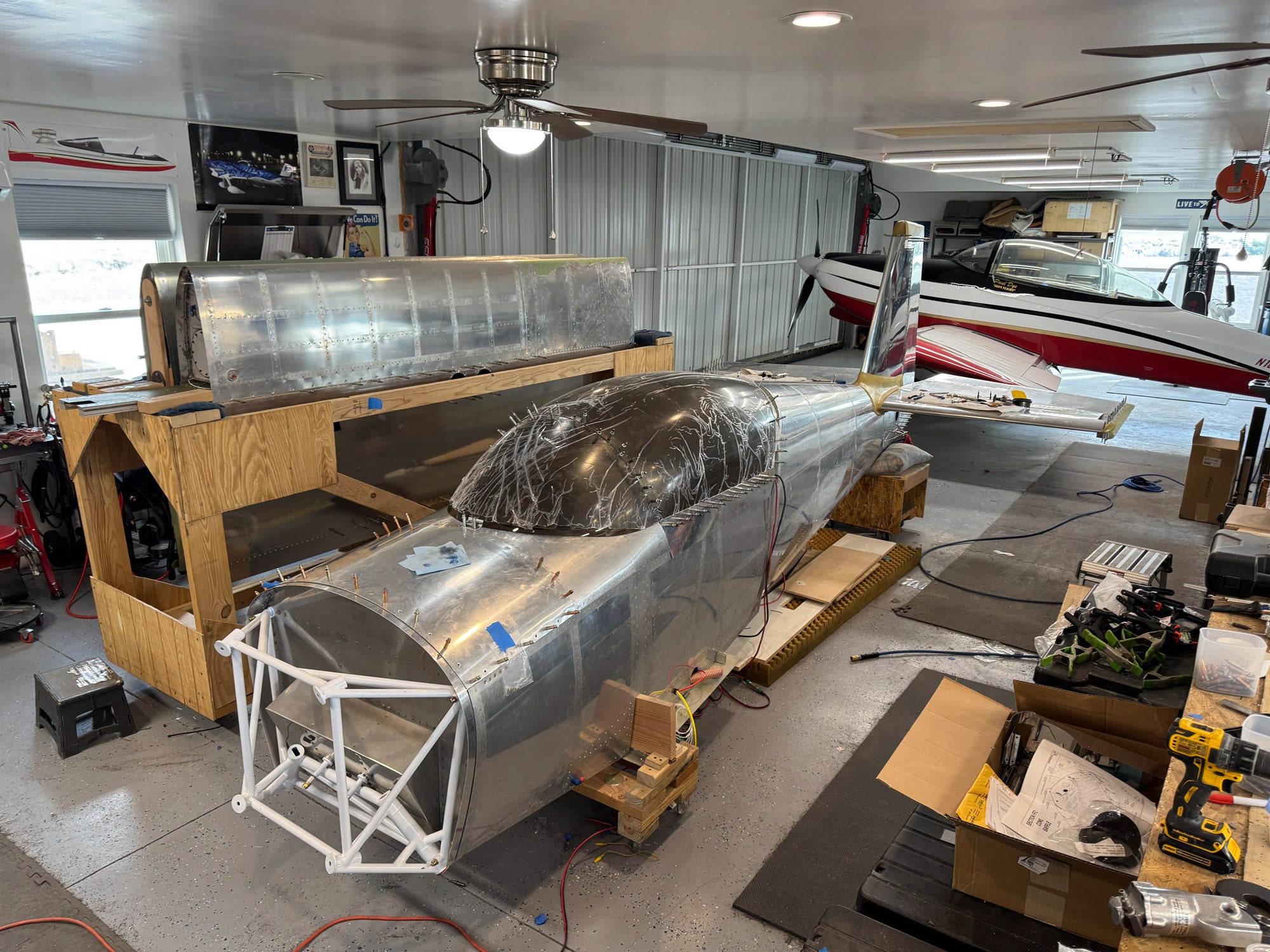

While some of the KITPLANES editorial staff was busy in Florida last week at Sun ’n Fun, I stayed home—because we had some days warm enough to do canopy work! The result: The F1 Rocket project looks much more “airplane-ish,” and I’m quickly reaching the point where it might make sense to put it on its gear and think about mounting the engine.
If we get to that point, it opens up a vast array of work that can be done—firewall-forward connections, baffle work, and installing the cowling. For an RV, that’s about 300 hours of work (most of that baffling and cowling—I can hook up a Lycoming in a couple of days).

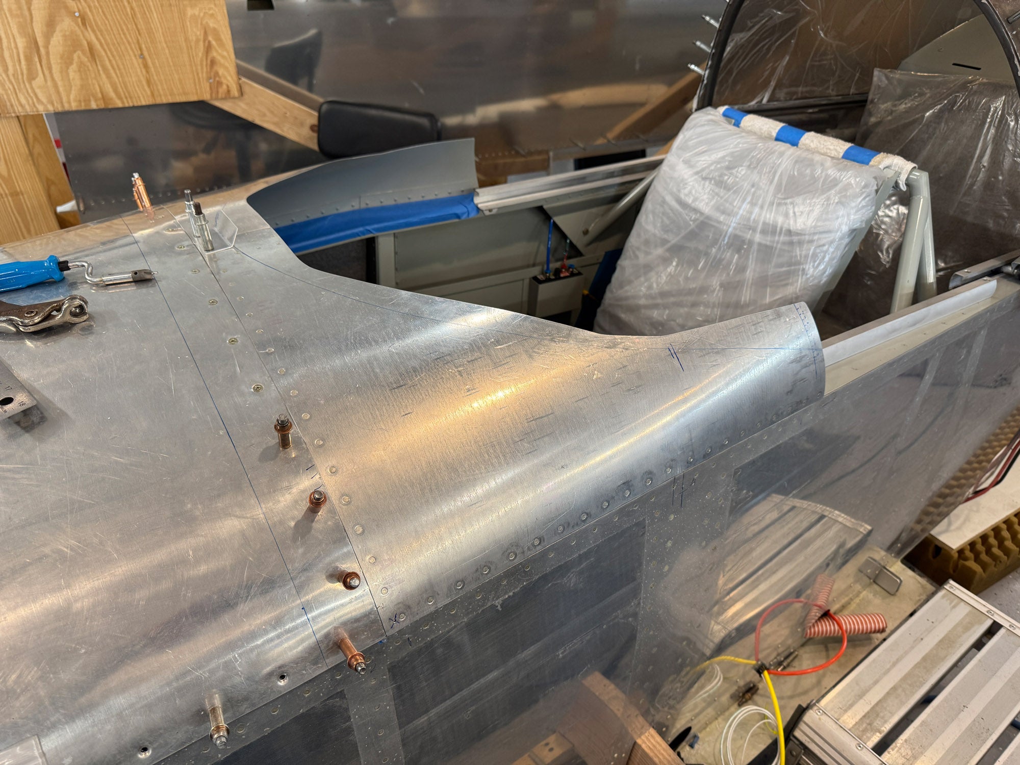

Canopy Status
The canopy and windshield have now reached their final trim states. While there’s still a lot of work to do to make the fiberglass frame for the windshield and build the skirts for the canopy, those items can be deferred as I take on new challenges and stay fresh. It’s easy to get bogged down in something like the canopy—day after day, doing a little of this and a little of that—until you’re so tired of it that airplane progress slows to a crawl. Far better to walk away from the task while your brain’s background processes work out solutions to the jiggling problems that slow you down, and instead go work on something more productive. Solutions will appear when they’re ready!
