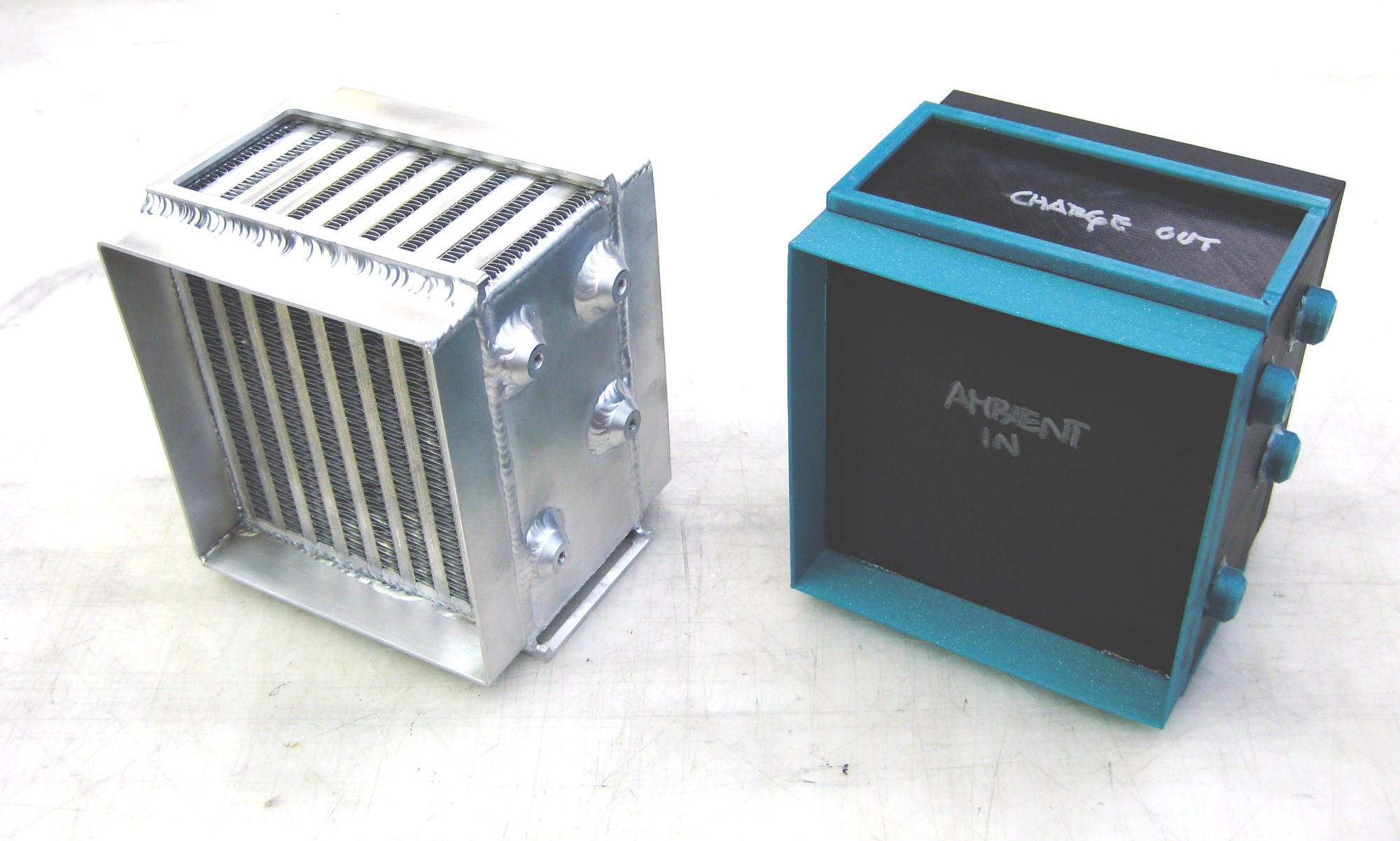

intercooler finished and mockup
On left, the intercooler as received. Beautiful work! It’s a perfect match to the 3D-printed mockup that was provided as a reference to the vendor.

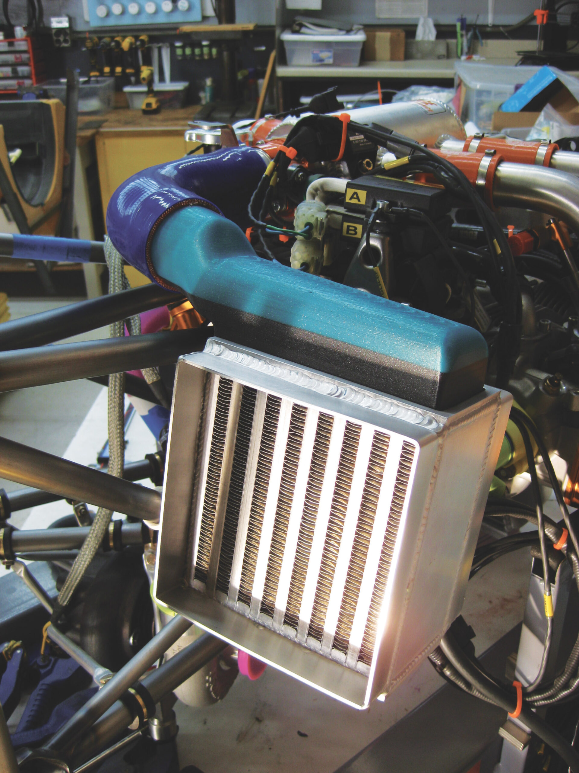

intercooler mounted
Once the intercooler core was received, it was mounted to the engine mount. Intake and exit headers were 3D printed to check for mount clearance and hose alignment before molding the actual carbon fiber headers.

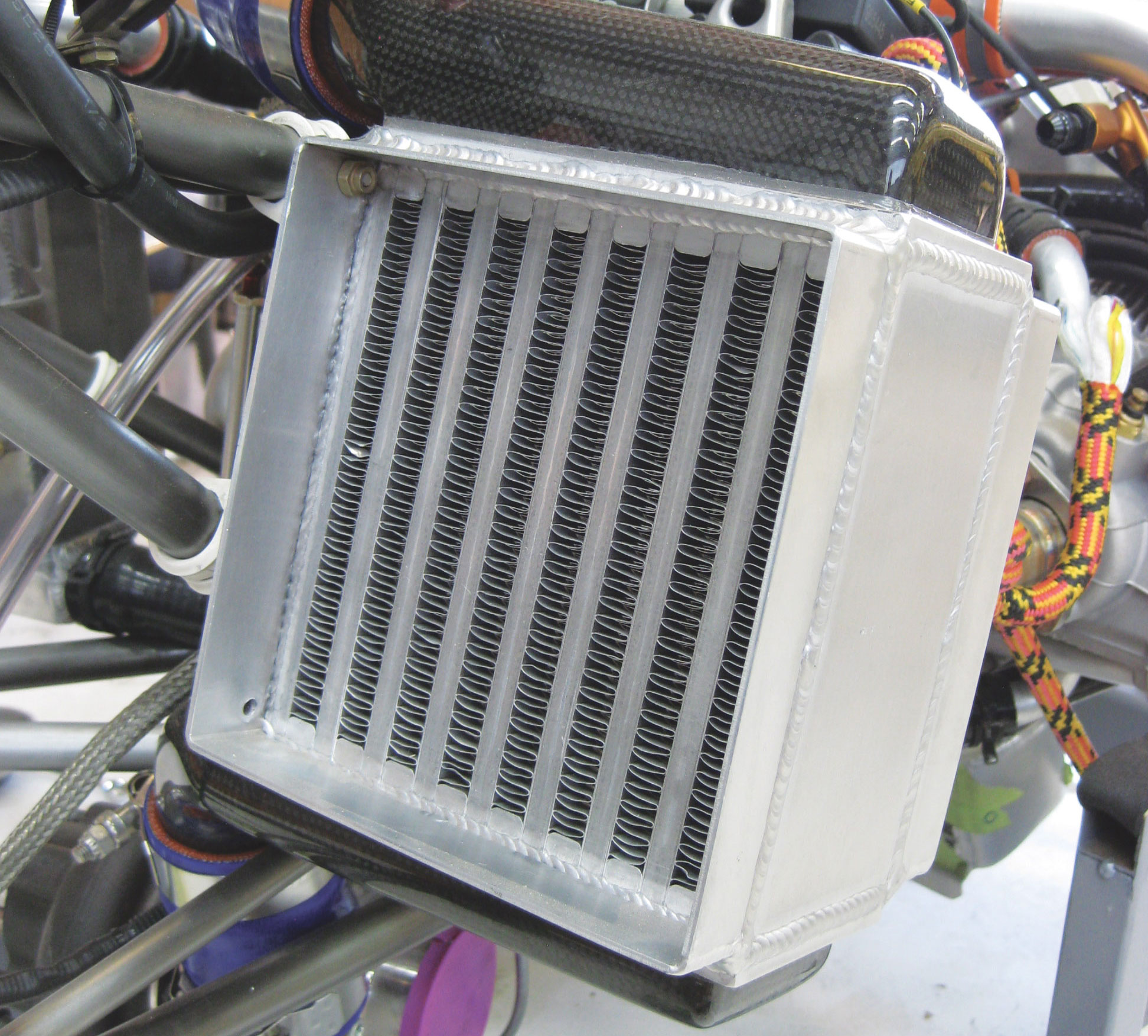

Radiator as received.
Radiator as received. Note the slightly warped duct flanges, as discussed in the article. Note also the gap between the cooling fins and end tank. Despite quite a bit of back and forth with the vendor on core size, these gaps were a surprise. Apparently this is an unavoidable result of the fabrication process. Aerodynamically speaking, these gaps are essentially a leak in the core, so extra flanges had to be fabbed and welded in to block them off. Otherwise a beautiful radiator and most importantly the inlet and exit tubing were fabbed exactly as spec’d (there was little margin for error on this aspect).

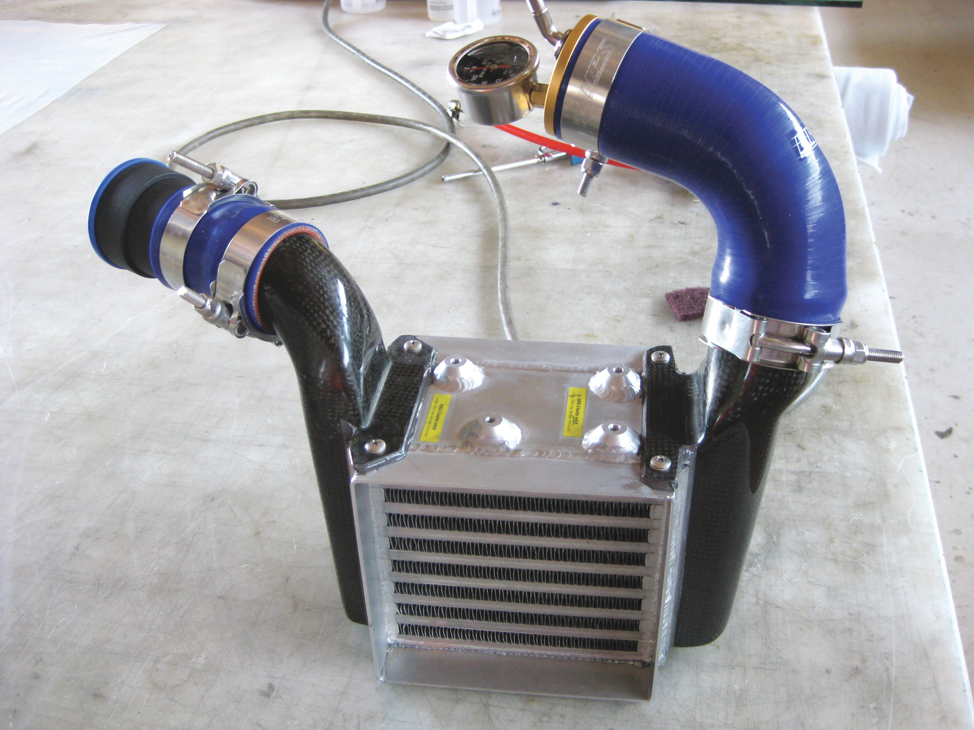

custom heat exchanger stewart 04
Intercooler undergoing pressure testing after the carbon headers have been bonded in place. Inlet and outlet are plugged at the silicone hose. One of the plugs has ports for a pressure gauge and Schrader valve.

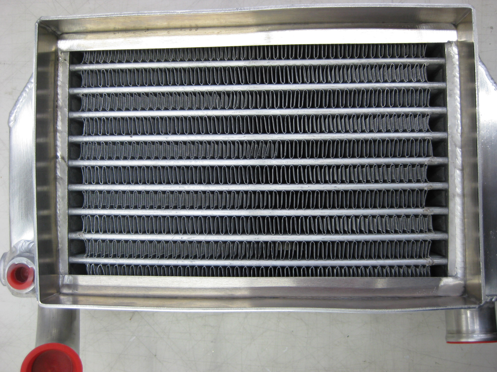

Intercooler Design
The custom intercooler has a similarly smaller face area than the stock intercooler and is also smaller volume. Hauklien provided the dimensions of the custom intercooler in his 912STi-powered Shark, which he said worked well. Given the Shark’s similar high speed, I felt that like the radiator, using a smaller intercooler would not present a problem as long as it was well-ducted. Likewise, should problems arise I have the option of adding evaporative cooling to improve performance.
Additionally, as compared to most turbocharged Rotax installations, the path of the air from compressor to intercooler and then throttle body is relatively short and non-tortuous. It comprises only two 90° turns (not including the 90° turns into/out of the core itself), so the pressure drop should not be terrible. This helps keep charge temps down. Long, windy charge paths require the turbo to work harder, thus increasing the charge air temp and vice versa.

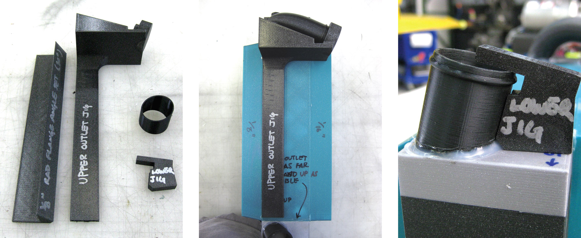

3D-printed jigs
3D-printed jigs to help the welder cut to length and orient the inlet and outlet tubes of the radiator.

After bonding the headers to the intercoolers, the system was plugged at both ends and pressurized to check for leaks. Test pressure was based on the nominal maximum manifold pressure, multiplied by a safety factor. Note that the safety factor is applied to the pressure delta over ambient. So if your intake system runs at 1.4 bar (approximately 41 inches of manifold pressure) and you wanted to test at a safety factor of three, then you would pressurize the system to 0.4 bar x 3 = 1.2 bar, or 35 inches of mercury or 17 psi.
I first conducted the pressure tests at room temperature. Once I felt confident that there were no system leaks at that temp, I preheated the unit to 160° F in an oven, removed and pressurized it, then placed it back in the oven. Over 30 minutes I saw an acceptably slow pressure drop and considered the unit airtight and test-flight worthy.
During the room-temp pressure test, I swabbed the system with soapy water, looking for bubbles wherever I thought leaks could potentially occur. The only leaking I detected was where the silicone hoses clamped to the intercooler headers and plug caps. The maximum leakdown rate was approximately 3 psi per minute. This is magnitudes lower than would be required to affect performance, so I’m fine with this small amount of leakage.
The bubble test also proved useful in setting torque values for the hose clamps. As far as I know, most folks do these to the German torque standard (“gutentite!”), which probably works fine for aluminum headers, but I’d prefer something a bit more scientific for the carbon headers. The leak test gave me a good idea of torque vs. leakage. I gradually increased the torque on the hose clamps until I achieved the 3 psi max leakdown rate. I use this as my max inlet/exit header hose torque value and use a somewhat higher value for the other end of the hoses at the (aluminum) turbo and throttle body.

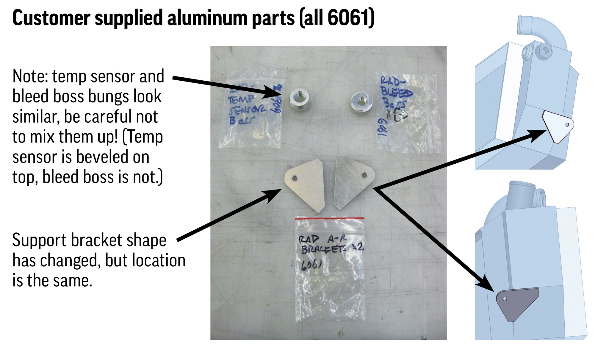

custom heat exchanger stewart 06

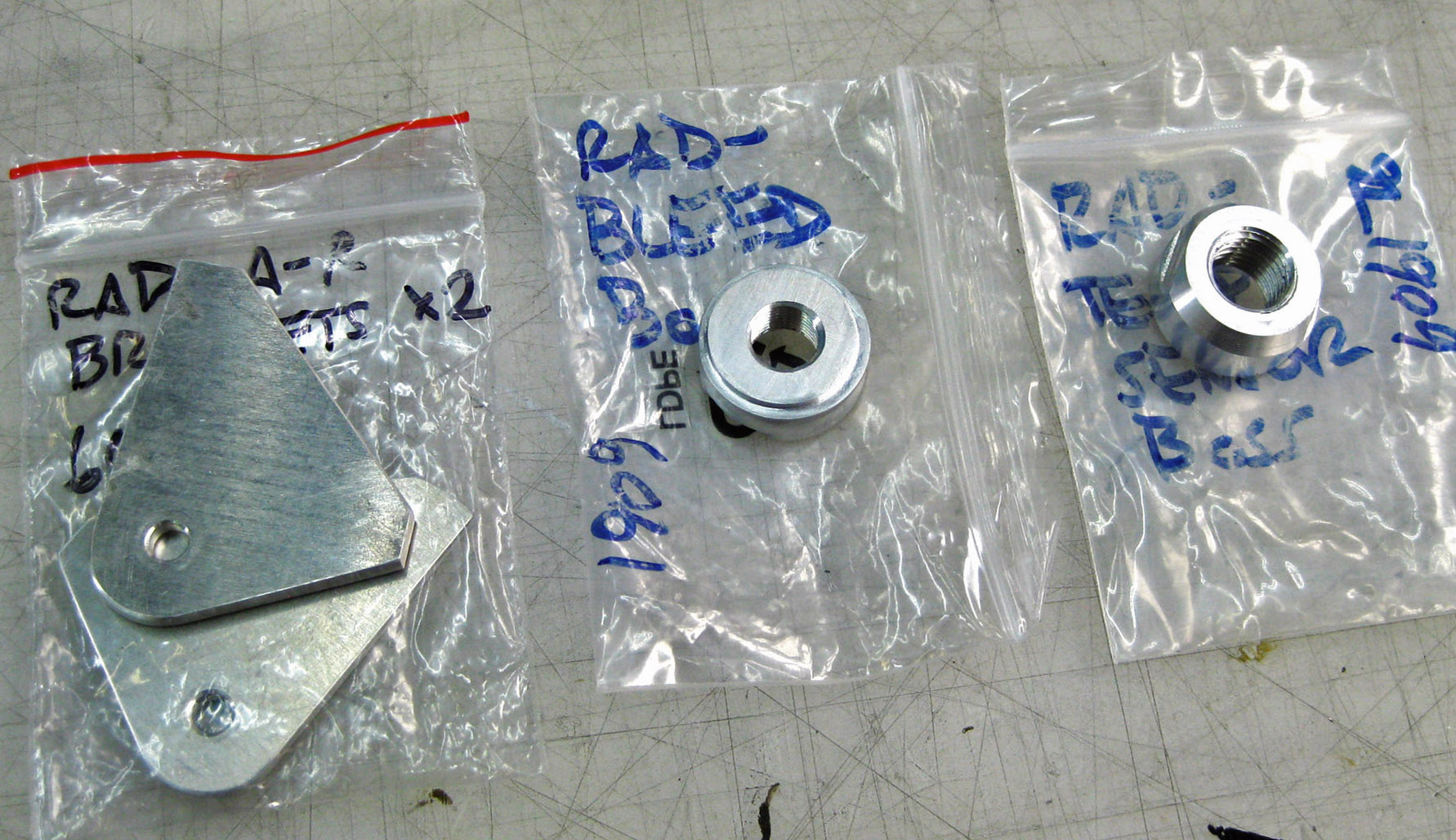

Radiator parts kitted for the vendor (mounting bracket, bleed bung and temp sensor bung). Be sure that any parts you supply for welding are materially compatible with the base metal.
This is a really important part of the design process! If a shop or vendor discourages your involvement or suggests that because they’ve done this a thousand times, whatever they send you will be fine so don’t worry, it’s best to move on. Because most likely what they send you will not be exactly what you want, in either a minor or a major way. I could say this about so many aspects of this project—when a vendor sees you as an interferer and not a collaborator, expect a stressful experience.

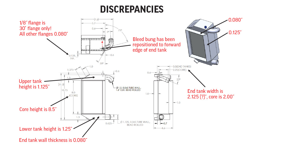

Page from the Assembly PowerPoint noting discrepancies between the original engineering drawings (by the author) and the drawings (converted by the vendor) for use by their fabricator. It’s important to find a vendor that is willing to work with you to fix these kinds of issues!
For example, I had originally spec’d the duct flanges at 0.063 inches. The engineer in charge of my project suggested 0.125 inches as more typical, which I balked at for weight reasons. We settled on 0.080 inches. This was a good compromise, as even at 0.080 there was minor warping (see pics) but at 0.063 inches I imagine it would’ve been considerably worse. Really, 0.125 inches would’ve been overkill.
