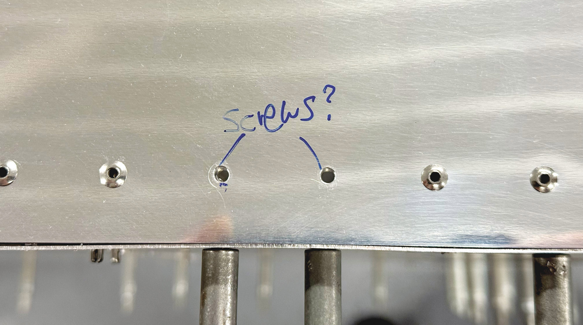

These holes became slightly oversized when I drilled out rivets. The note reminds me to consider using larger screws instead of rivets.

Install a Larger Fastener. If edge distance permits, and filling the hole with a double-flush rivet isn’t an option, I install a fastener larger than the plans call for: an AN3 bolt rather than a #21 rivet, for instance.
Install an Additional Fastener. When a hole is out of place and edge distance won’t be compromised when the proper hole is drilled, the easiest fix is to fill the errant hole with the smallest fastener option available. In some cases the fix may be as easy as forgoing the proper hole and using the errant hole, but that can offend my sense of symmetry.

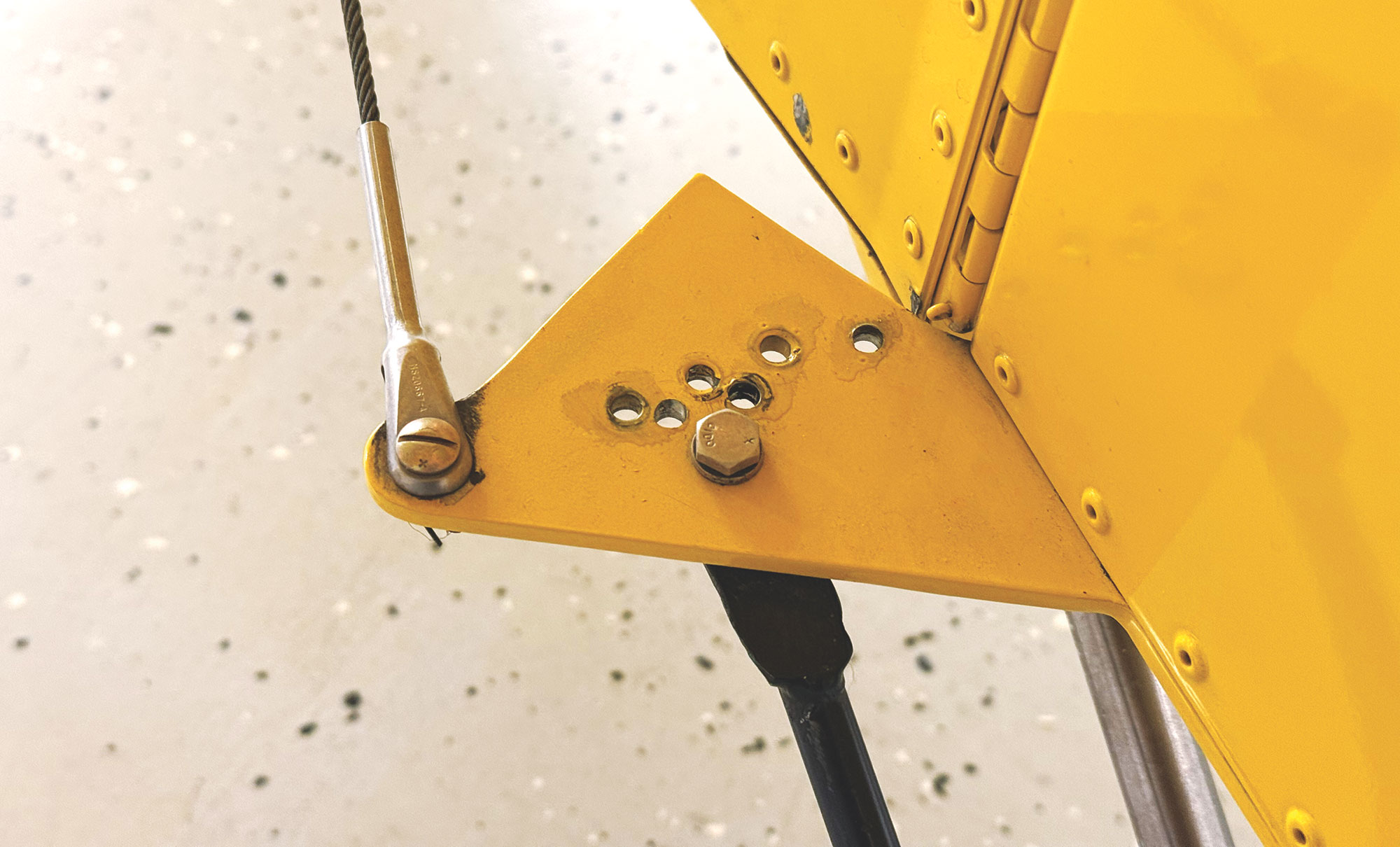

Photo 1 Undrilling Holes BT Fores
Each unused hole in this prototype rudder drive horn could be “erased” with a solid rivet.
There is very little a builder who’s making an honest effort can do to ruin a part or assembly to the extent it forces an expensive correction. The key to is stop as soon as the error is recognized and contact the kit manufacturer for guidance. (And by all means, talk to yourself.) There are no undo or delete functions in homebuilding, but there are often easy, structurally sound fixes.
