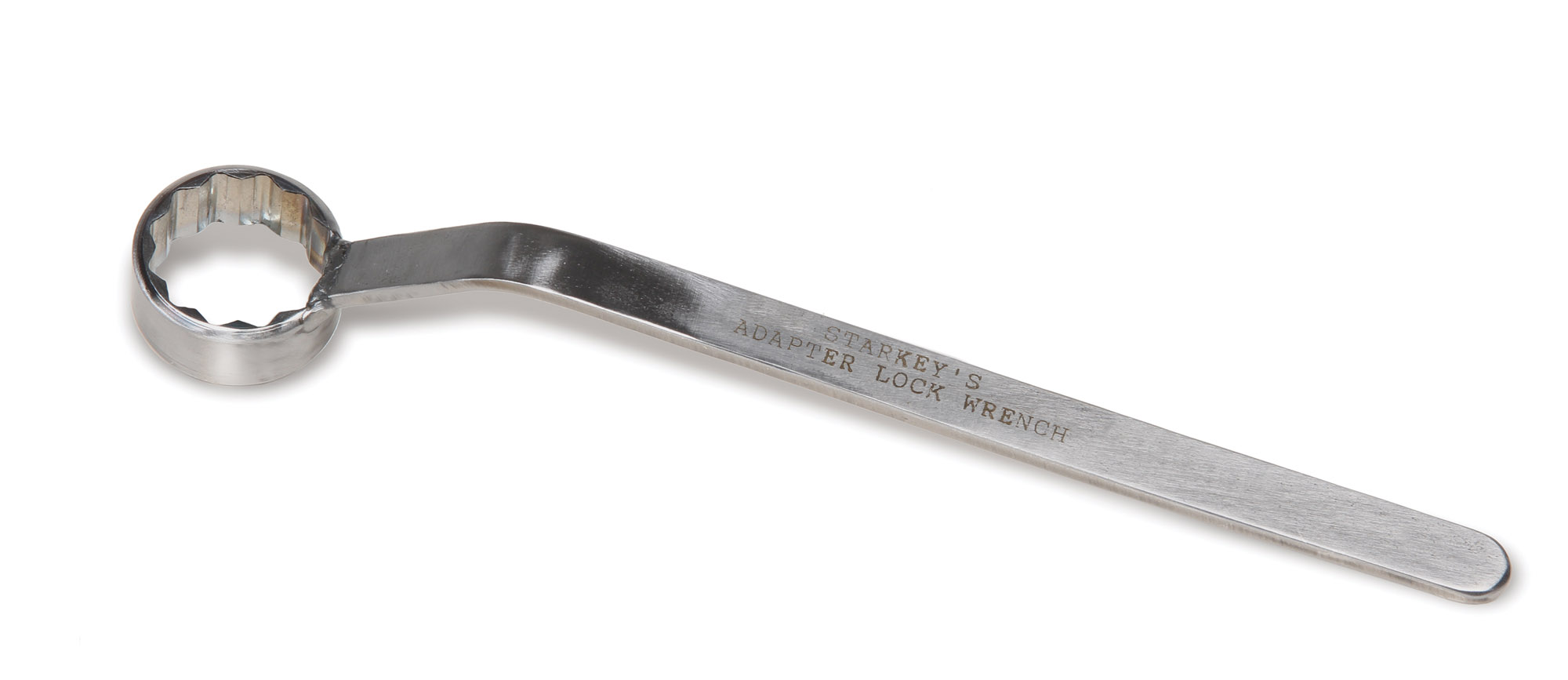

Starkey’s Custom Spark Plug Adapter Lock Wrench

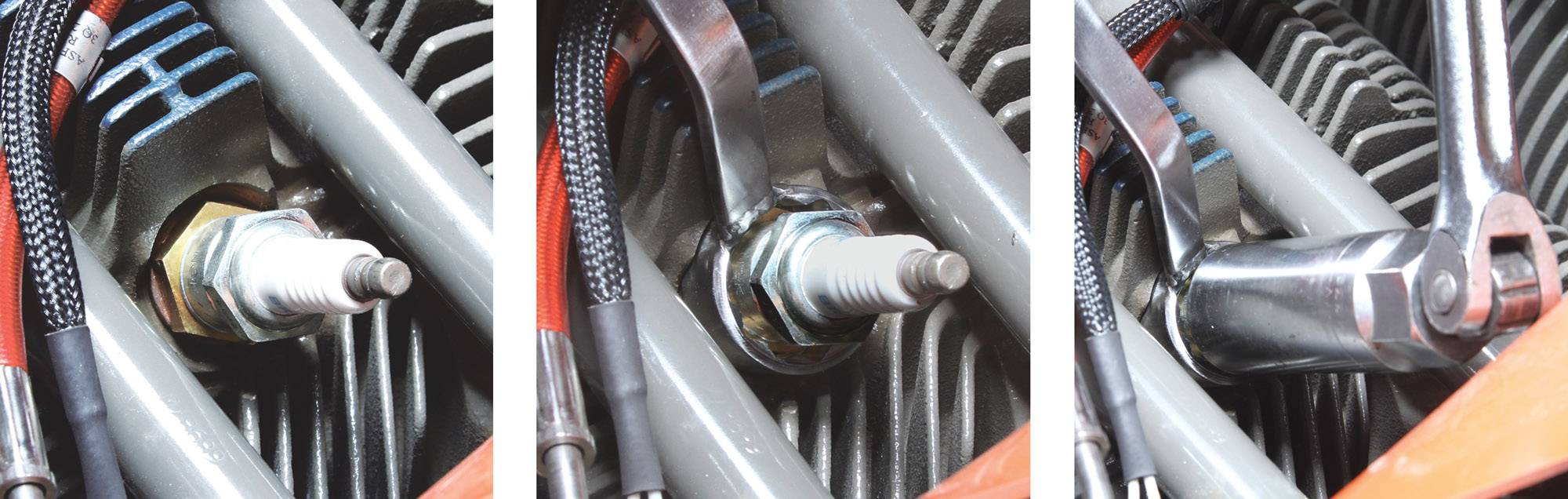

18mm-to-14mm adapters (left) are necessary to use 14mm automotive spark plugs. To prevent the adapters from unthreading, Mike Starkey came up with a plug adapter lock wrench (center). With the lock wrench holding the adapter, the plug can be removed (right).

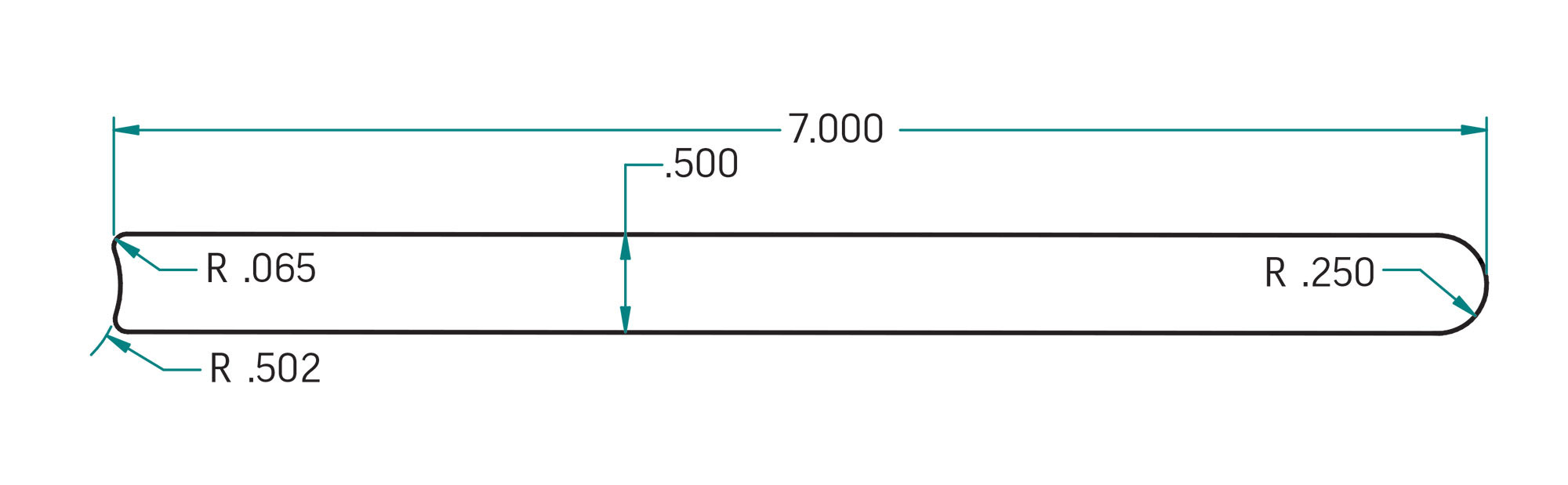

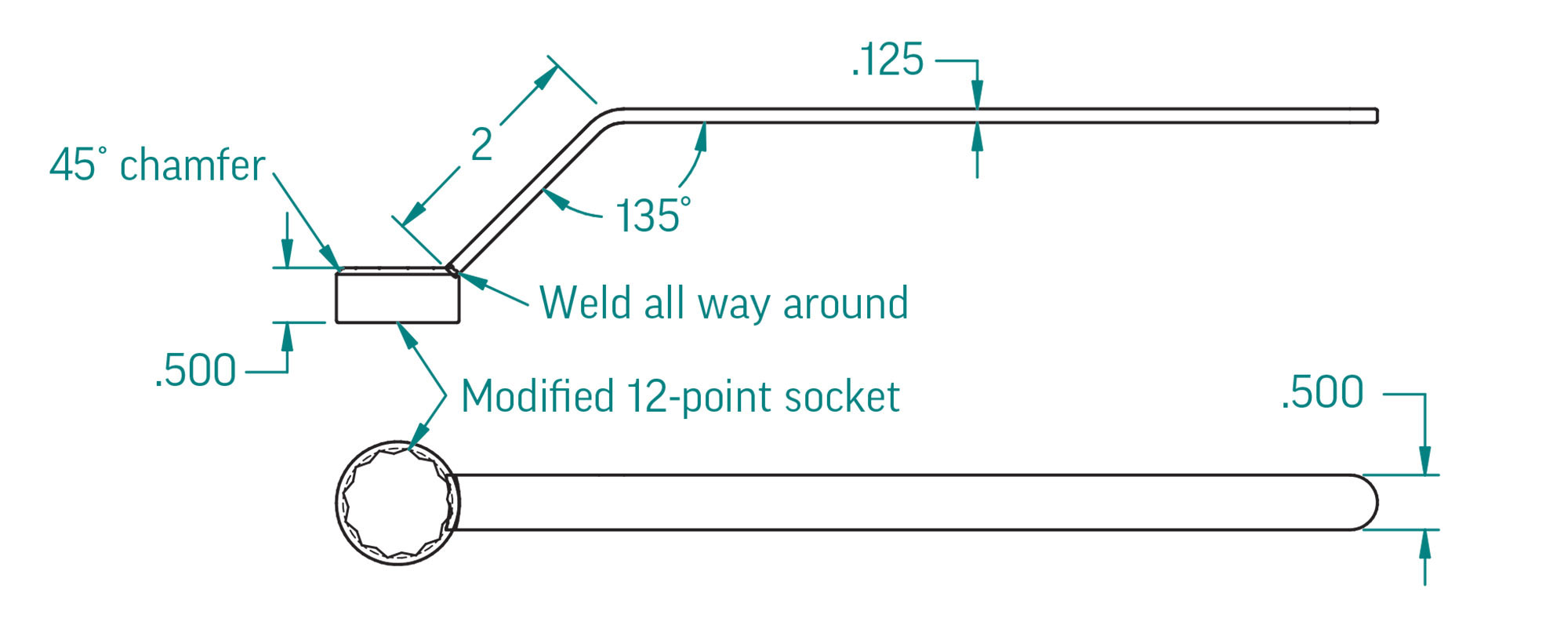

spark plug wrench handle dimensions
The handle was made from 0.125-thick cold rolled steel.
The dimensions shown work for Mike Starkey’s IO-320 Lycoming, but it is a good idea to check the clearances on your engine just to be sure.

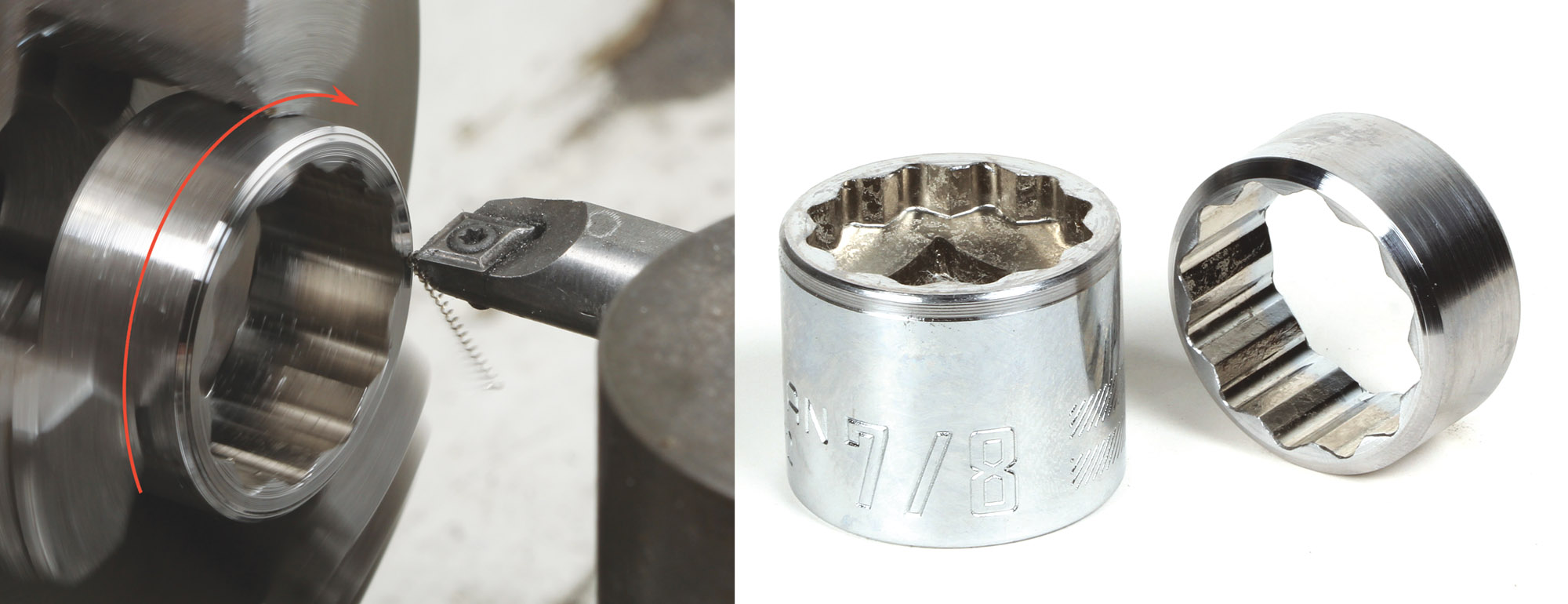

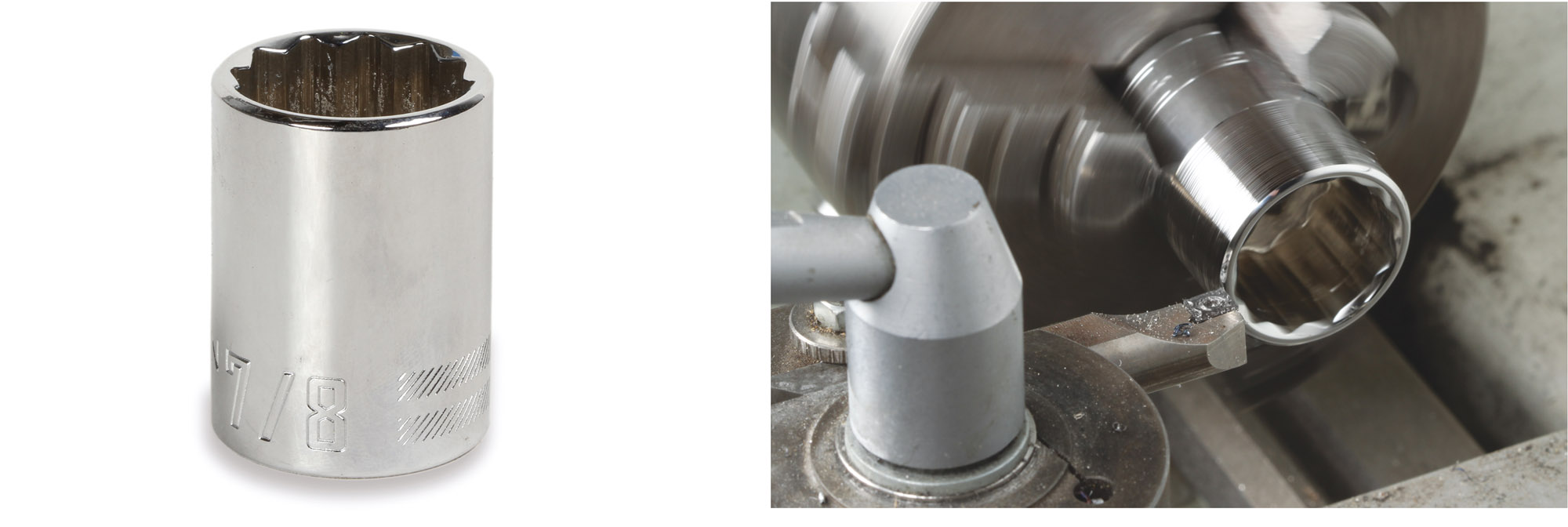

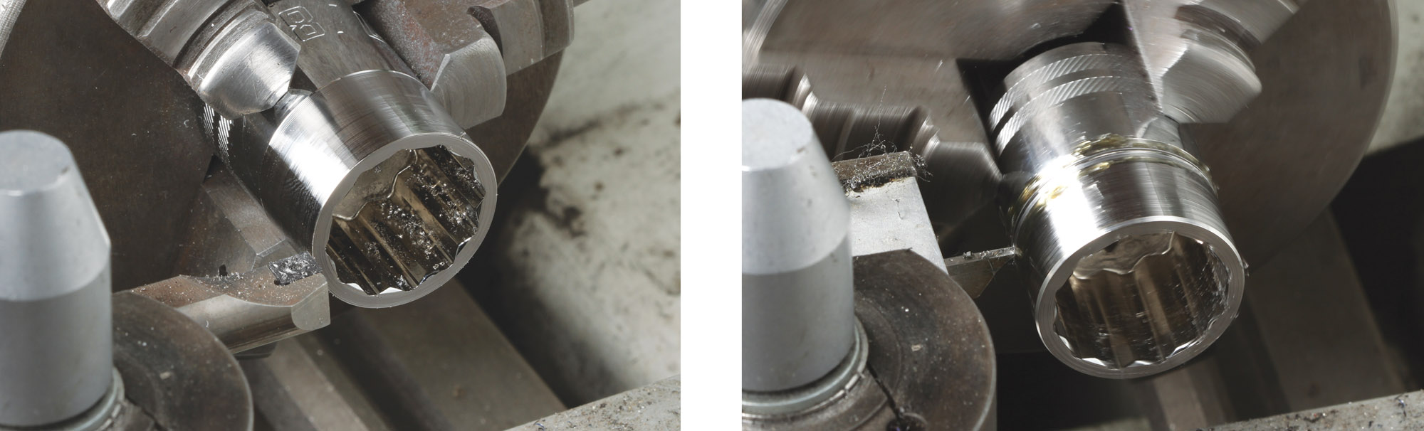

Any 12-point socket will work. This one was purchased at a local hardware store (left). Remove the chrome by turning at least 0.025 off the diameter of the socket (right). While the decorative chrome on your toilet handle is probably less than 0.001-inch thick, the chrome plating on tools and industrial applications could be 0.005- to 0.008-inch thick.
spark plug adapter lock wrench 07

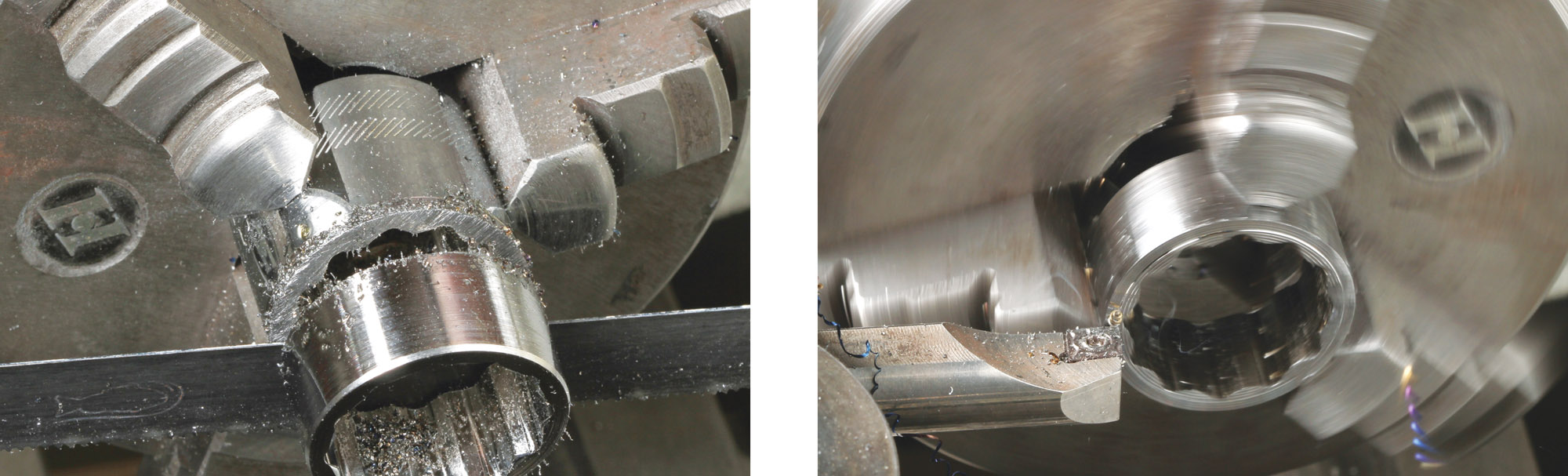

Since the spark plug adapter has a very thin hex, the end of the socket was faced flat to improve the wrench’s engagement (left). The socket proved to be too tough to part off with a thin (0.062-inch-wide) high-speed steel cut-off blade (right), so plan B was the hacksaw.
spark plug adapter lock wrench 08
With the lathe off and the spindle locked, a hacksaw was used to “part off” the socket ring (left). With the rough cut facing out, the socket ring was faced off to a length of ½ inch (right).
spark plug adapter lock wrench 09
The final operation on the socket ring was to turn a 45° chamfer to provide a “landing” to weld the handle. Note the lathe spindle is rotating in reverse for the chamfering operation (left). The sawed-off socket and ring (above).
Switching to auto plugs in Continental or Lycoming engines commonly involves using 18mm-to-14mm spark plug adapters. A quirk of installing these adapters is that you torque the adapter to the cylinder head with the plug installed. In the case of E-MAG, their instructions are specific: “FIRST install each spark plug in the adapter (fully seated and finger tight). THEN, insert the combined plug/adapter assembly in the engine and tighten to 18 ft/lb (standard auto plug torque) through the spark plug ONLY. Do NOT torque the adapter itself.”
Both Paul Dye and Vic Syracuse have talked about this. The main issue seems to be if you torque the adapters into the head without a plug, it could distort the thread or otherwise damage the adapter. Once installed, you can usually remove and replace the plugs as normal.

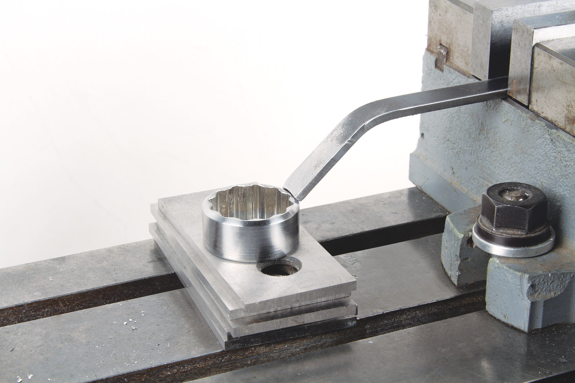

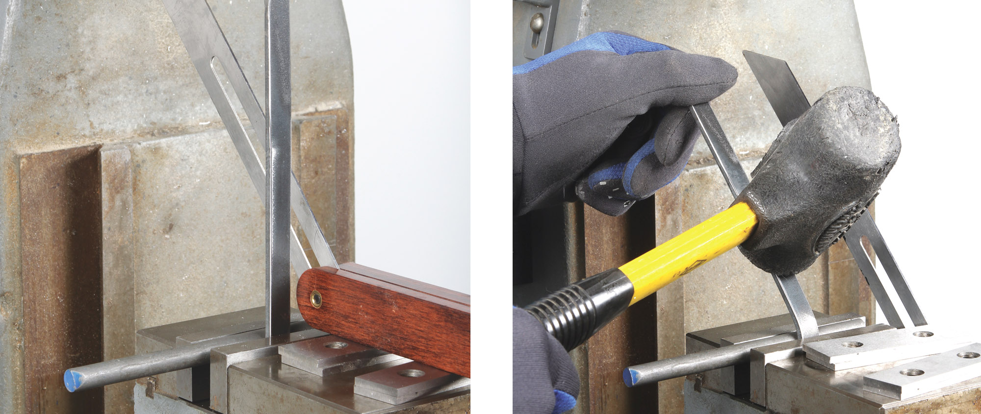

The smooth jaws of the mill vise come in handy when making bends in soft material (left). Note the ½-inch bar stock for the bend radius and the sliding T bevel to eyeball the correct angle (right).

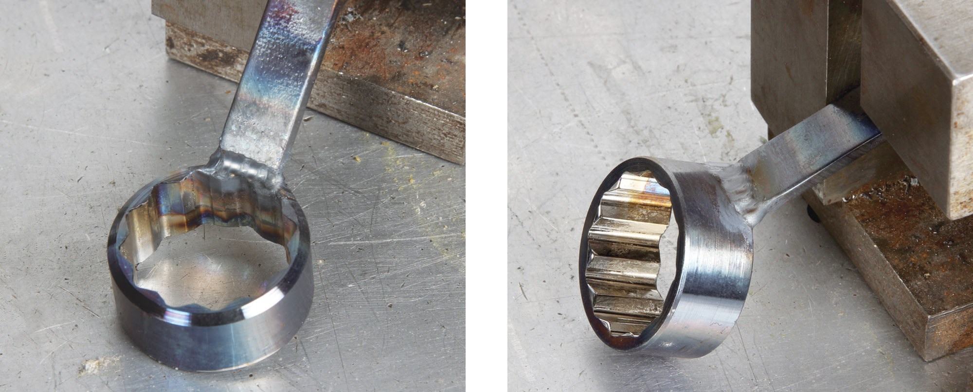

spark plug adapter lock wrench 01
The chamfer on the socket ring creates a butt-joint to the handle for welding.
Done correctly, plug adapters do the job. Occasionally—maybe one in 10, according to Paul—when removing a plug for a compression check or routine replacement, the adapter will unthread with the spark plug.
In order to prevent that annoyance, Mike Starkey came up with the idea of a holder wrench that would provide a way to reliably remove spark plugs without unthreading the adapter. It’s important to note that Mike’s wrench is for holding only, not for tightening or loosening.
spark plug adapter lock wrench 11
The handle was welded to the socket ring using the TIG process.
Most brilliant ideas are simple and this is as good an example of that as any. Simply cut the drive end off a ⅞-inch 12-point hex socket and machine the remaining ring just long enough to engage the hex on the adapter. To that, weld an appropriately designed handle. What you end up with is a special box wrench that fits into the very close-fitting margins of the plug counterbore. Hold the handle of the adapter holder with one hand, and using a plug wrench, loosen the spark plug with the other.

After welding, the wrench was polished and marked. An acrylic clear coat was sprayed on to prevent rust.
From a machining standpoint, it’s relatively simple, except for the fact that most mechanic’s sockets are heat-treated, tempered and chrome-plated. It is therefore critical to use a carbide insert turning tool to remove the chrome. The main reason to remove the chrome is because chromium fumes can be nasty when welding. A secondary reason is, while the underlying steel socket might be heat-treated to somewhere between 35 and 50 on the Rockwell C hardness scale (HRC), the chrome plate could be as high as 70 to 75 HRC, which makes it tough to saw through.
