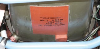

Even though I was planning to install a fixed-pitch propeller, I elected to install a manifold pressure sensor and fuel flow sensor to complement the EMS, along with four CHT and EGT probes, and a carburetor temperature probe. It was the fuel flow sensor installation that came to haunt me midway through the Phase 1 test program.
I knew enough to seek advice before modifying my fuel system, and the wise sages I consulted suggested—no, insisted—I make sure that once the fuel line leaves the gascolator there would be no low spots to collect water. With that in mind, I mounted the fuel-flow sending unit directly above the gascolator, connected with an aluminum “U.”
This worked great until about 21 hours into Phase 1 testing. At this point the engine was well broken in and my test card called for some slow flight. You remember slow flights, don’t you? High angle of attack, high power settings, lots of right rudder, low airspeed, and not much air through the cowl to cool things down.
This uninsulated aluminum “U” picked up enough heat during slow flight to cause the fuel to boil and vapor lock.

The solution was to insulate the line from the heat of the engine compartment using firesleeve. After five years and 500+ hours, the author decided to improve the installation.

After de-cowling, I pulled up a chair and gazed at my engine compartment for what seemed like hours, but was probably about 10 minutes before I realized my error. The elbow I installed between the gascolator and the fuel flow meter was not insulated. It must be this simple bare section of aluminum that is heating the fuel during extended flights at low power settings. Scrounging around my hangar produced a section of firesleeve just long enough to cover it. I secured the firesleeve with dime store zip ties and went for another test flight.
The fifth test flight since the first engine stoppage was uneventful—and so has been every flight since then. Well, that’s not exactly true; let’s just say that the engine has stopped stopping unexpectedly in the intervening 512 hours.
