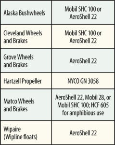

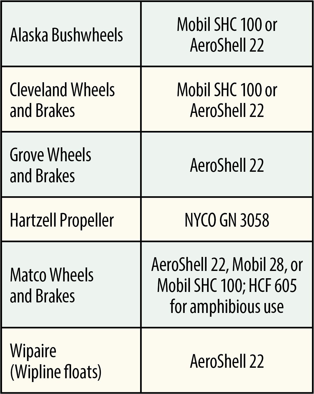

Recommended Greases
Here are the grease recommendations of some popular manufacturers. Note that Mobil SHC 100 is not available in tubes from Aircraft Spruce, but Amazon carries it. The smallest quantity available is a 4.4-pound tub for $83.
As you can see, AeroShell 22 is a popular choice among manufacturers. That said, AeroShell 5 also has a good track record. AeroShell products are widely available from aviation vendors, making them a popular choice among mechanics and aircraft owners. Matco recommends BG Products HCF 605 for wet uses and amphibious aircraft. It is available from SkyGeek. Mobil 28 is also popular as an alternative to AeroShell products, and Mobil SHC 100 is widely used by manufacturers during initial assembly. Since it is not available in tubes, it is much less popular with aircraft owners.

Use a grease that is approved by the maker of the part you are greasing. The people who make your parts know best what works well for their products. In just about every case, that will mean using an aviation grease. Follow the lubricating procedures recommended in the manufacturer’s service literature. There are right and wrong ways to do most things. Do not mix greases—and especially do not mix mineral and synthetic greases. If you want to use a different grease, thoroughly clean the part before applying a new type of grease. Mixing greases can lead to corrosion and other negative consequences.
