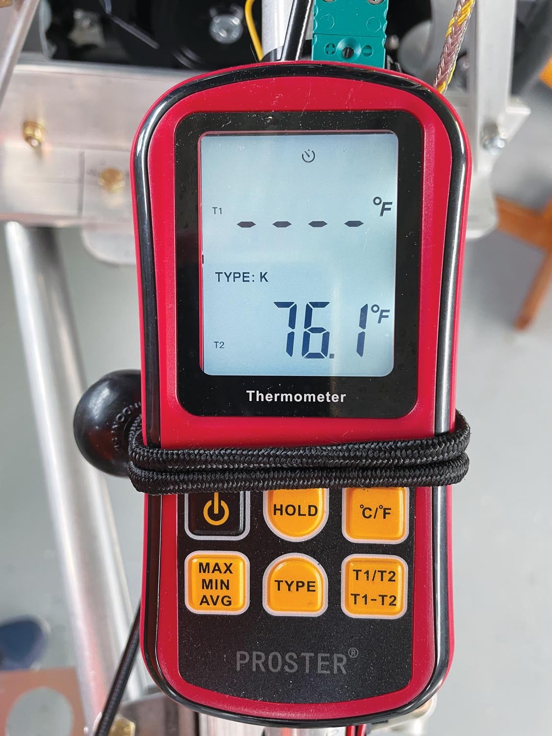

If you want to have some fun, you can play with (I mean test) your thermocouples before putting them into action on your engine. Inexpensive thermocouple meters are available from Amazon that provide a digital temperature readout of any thermocouple. This is a great way to test your installation or troubleshoot erroneous readings from your instrument panel. Set the meter to type K and look for an immediate reading. Put your probe in ice water or a boiling pot to check the accuracy from a predictable temperature source.
