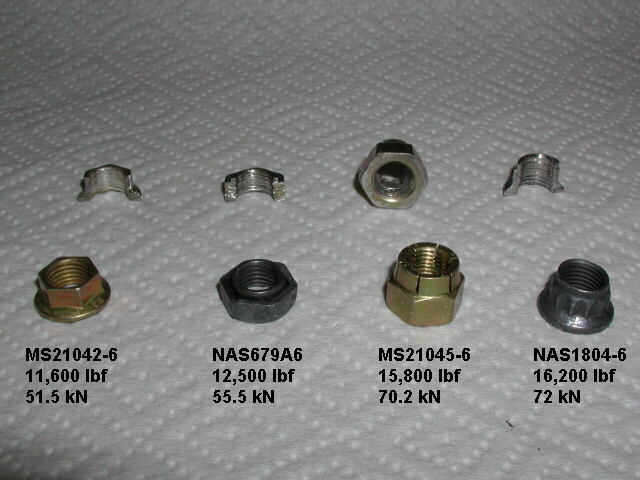

I believe MS21042 nuts are full strength, not shear nuts.
MS2104 are pretty weak in tension, so I would suggest using them judiciously. We tested the -6 size along with several other AN/MS/NAS nut types to evaluate the various kind of nuts being used with RV-8 landing gear attachment. Our results were:
MS21042-6 11,600 lb
NAS679A6 12,500 lb
MS21045-6 15,800 lb
NAS1804-6 16,200 lb
http://www.hpaircraft.net/rv8/nut_test2b.jpg
See the whole VAF thread at: https://vansairforce.net/community/showthread.php?t=42630

Thanks for pointing out an error in this article as the MS21042 nuts are full strength, not shear. It is a wonderful thing to have these short nutss provide full strength. The lesson for me is to not assume that size dictates an expectation of strength – as is the usual case.
