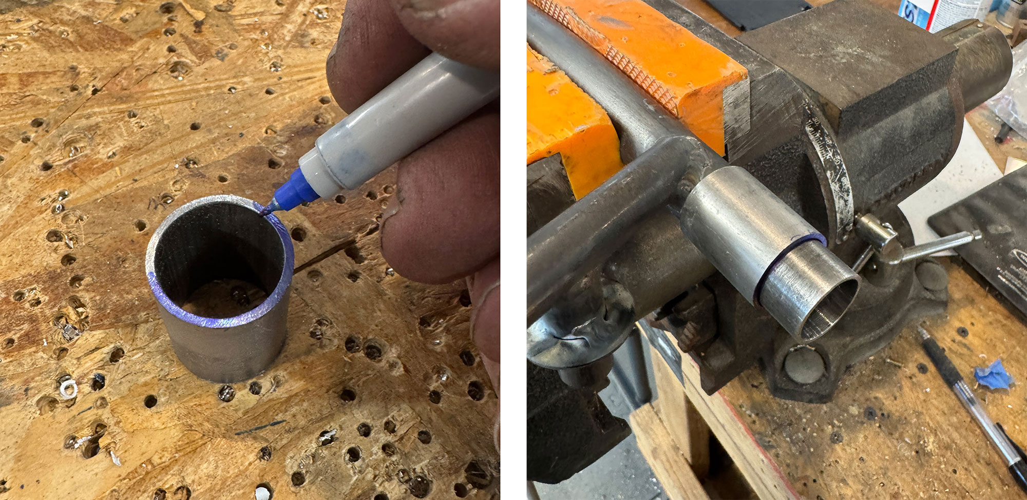

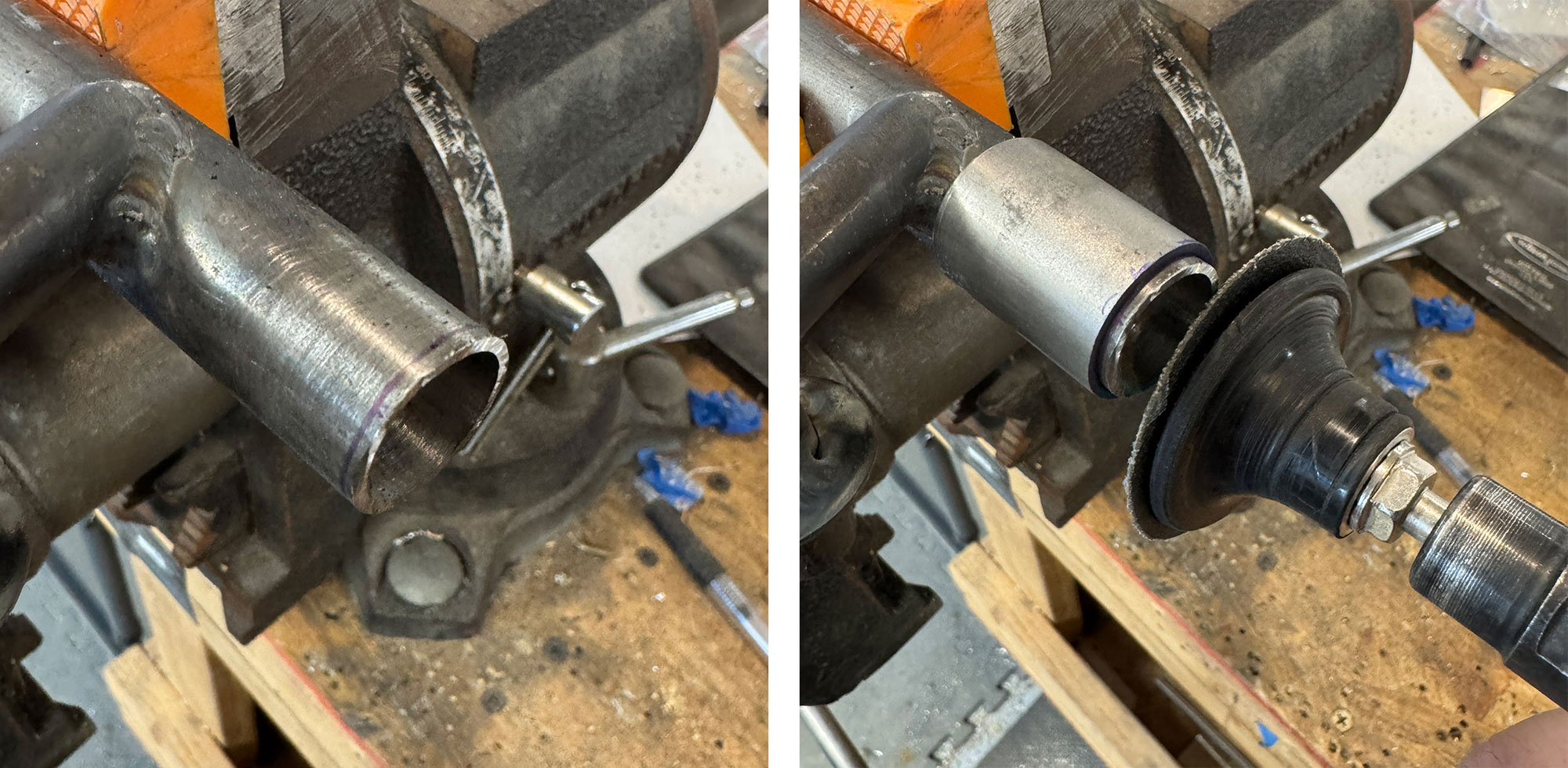

You do, however, need to make sure that when you trim the end, you get it nice and “square” to the tube’s centerline. One way to do this is with a short scrap of tube with an inside the diameter the same size as the outside diameter of the piece you’re trimming. I generally do a rough cut with either a hacksaw or Dremel cut-off wheel, then use a sanding disk on an angle grinder to trim down to the exact line.

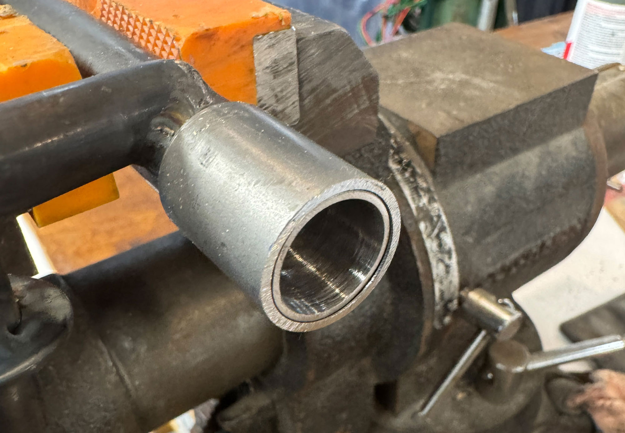

The easiest way I know of to get exactly where you want is to color the end of your oversized tube with a Sharpie. Hold it in the proper place on the tube with tape (don’t hold it with your hands unless you have gloves on – it will get hot!) Then trim the tube to final length, watching carefully for when the Sharpie color disappears. When it’s
gone – you’re done – plus or minus a thousandth, which is close enough!
