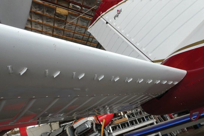

A second location where they are often found is on the underside of a horizontal wing to improve tail authority at higher AoA on both smaller GA aircraft and the big iron.

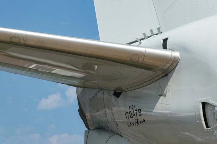

But not all VGs are on the wing or a control surface! A non-intuitive location is on the aft fuselage of the earlier models of the 737. Why? Because the interaction of airflow between the fuselage and vertical fin led to very noticeable buffeting that could be felt throughout the airframe. The VGs that were added control the airflow such that the air separates more cleanly and without all the buffeting. Of note is that the tail cone was redesigned on the newer 737 Max, eliminating the need for VGs there.

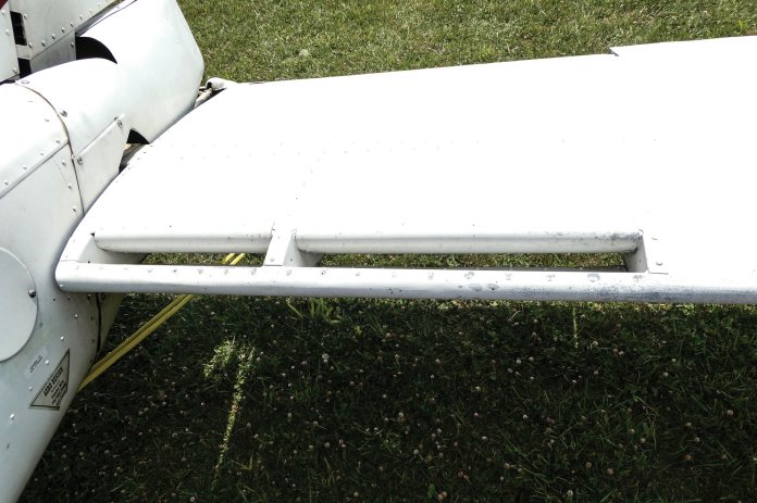

One instance of this was the Cessna 177 with its all-moving stabilator. As initially delivered, the stabilator was able to stall during slow-speed landings and flare maneuvers, running out of control authority and resulting in pilots landing with a solid ‘thunk’. The fix was to incorporate a leading-edge slot in the stabilator so that the air flowing through the slot and over the bottom surface delayed the onset of stall. This was incorporated into production aircraft going forward, and Cessna Service Letter SE68-14 provided for a retrofit leading edge slot (along with over 20 other items) to delivered aircraft.

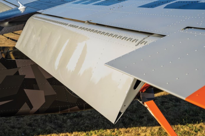

A really nifty application of VGs is on the new RV-15, wherein VGs have been added to the top of the flaps such that they are active when the flaps are deployed (and when the VGs are most beneficial to keep flow attached), but are otherwise concealed within the wing when the flaps are retracted so that they are not adding drag when not needed. Genius.
