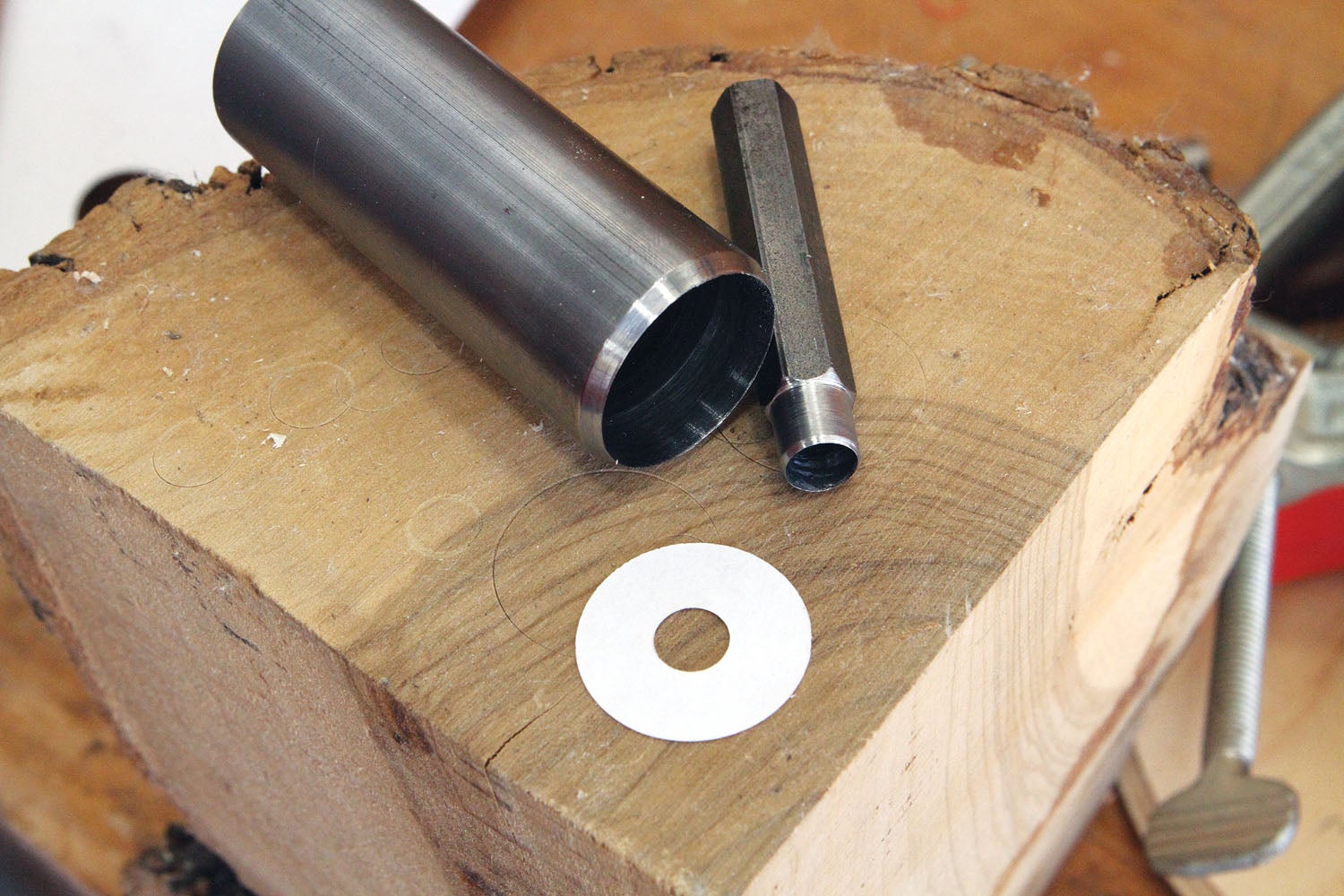

To make the circular patches, I made hand punches to knock out the center circle (5/16 inch) and the outer circle (1 inch). Since I was working with fiberglass cloth, the punches needed to be sharp, like a leather or fabric punch.
![](https://s28490.pcdn.co/wp-content/uploads/2021/04/threaded-flange-bushing_08-300x200.jpg.optimal.jpg)
The 1-inch punch was basic lathe work. I used a short length of scrap 1-1/8-inch OD x 0.065 steel tubing. I first faced both ends on the lathe. Using a boring bar, I took a very light clean-up cut on the inside of the end to be chamfered for the cutting edge. Then, using the cross slide set at 30°, I used the boring bar to cut a chamfer to create a knife edge. A fine-tooth precision half-round file was used to clean up tool marks. I then polished the chamfer with fine and super-fine laps (see “Laps and Lapping,” February 2021) to make the edge razor sharp.
Since I didn’t have any small-diameter tubing suitable for the 5/16-inch punch, I drilled and turned it from a short section of solid 10mm steel hexagon stock that I had lying around. Other than through-drilling the 5/16-inch ID and turning the OD for the cutting edge, the machine operations were basically the same as the 1-inch punch. To sharpen the edge, both the chamfer and ID were lapped.
