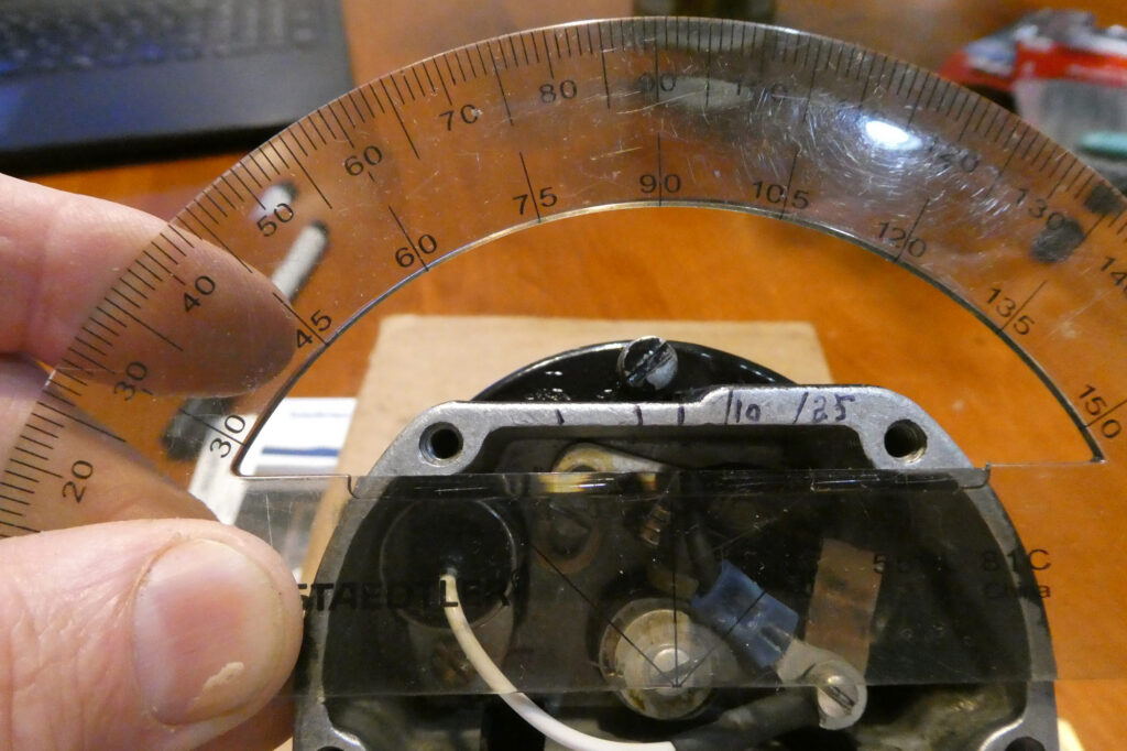

Setting the internal timing is supposed to make use of a special plate with degree markings and a pointer that clips to the end of the breaker cam. Not having said tool, I improvised. My college drafting protractor (required for one of the last analog drafting classes before they all went digital, thank you) was used to make 10, 15, and 25 degree marks on the casing, and a short straight-edge nestled in the screw slot worked as a pointer. With the red mark on the timing gear showing in the case opening, you are to then turn the armature backwards a few degrees until the magnets “pull-in” and hold the armature in a “neutral position”, as the manual describes it. With everything assembled, feeling this neutral position wasn’t quite as easy as with everything dry, but it’s there, and you’ll still be able to see the red gear tooth in the window, albeit off to the side by about one tooth. The pointer tool is then pointed at zero degrees; in my case, I marked a de-facto zero line.
At this point, so to speak, the overhauler is instructed to turn the mag in its normal direction until the pointer is at the ten degree mark and the points are adjusted to just begin opening. Not having the pointer tool, I used my straight-edge to note the nominal zero mark and my handy protractor to show me where +10 degrees was. Nor did I have the timing light tool to determine that the points were just beginning to open, but I did have an old-timers trick from one of the forums: adjust the points just enough that they “turn loose” of a piece of cellophane from a cigarette pack. Having left my ciggies in 1980-never-done-that, I looked around and found a restaurant toothpick still in its cellophane wrapper. Score! The mag is then turned further in its normal direction until the points are at max opening and set to a gap of 0.018 +/- .006 inches. So the purpose of the original cellophane gap setting before that? Beats me, other than determining where the points are just beginning to open. A timing “buzz box” was later employed to set the overall timing once mounted on the engine.

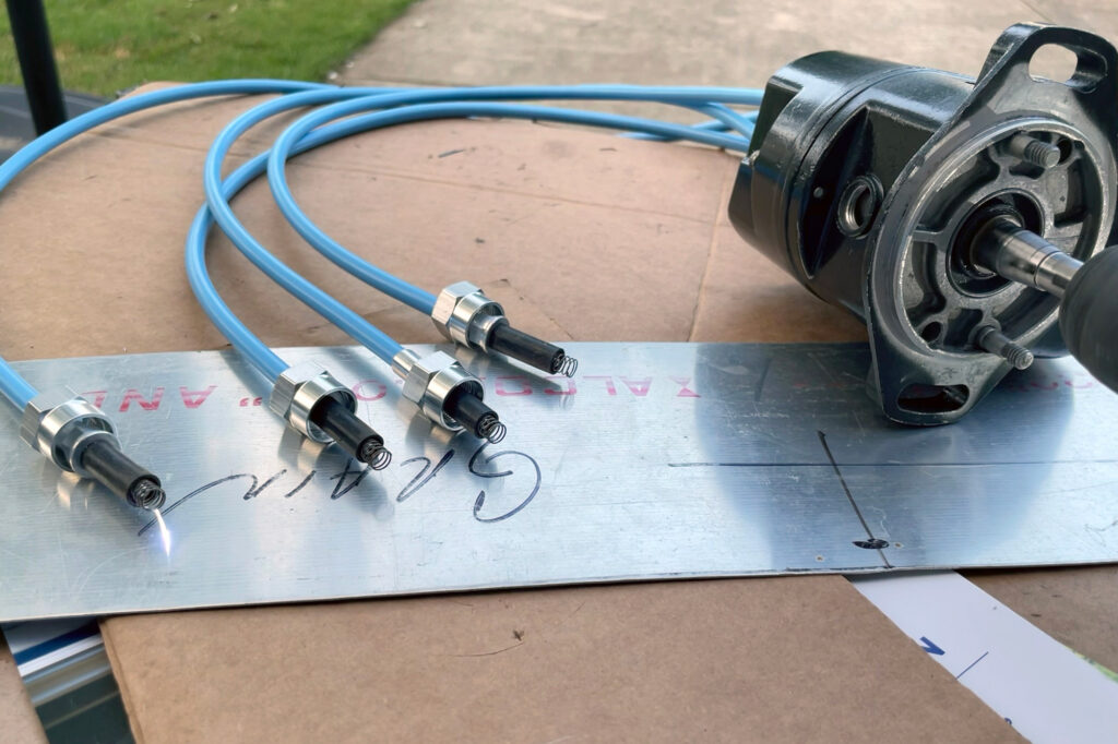

I had followed the instructions to the letter (more or less), but I wasn’t sure if it was going to work or not, so I headed out to the garage, installed the ignition harness plate, and hooked up the spark plug wires. With the mag sitting on a sheet of aluminum and the plug leads laying on the same sheet, I gently chucked a cordless drill onto the end of the armature and spun it. Lo and behold, there were sparks! Nice, big, healthy sparks emanating from a “bitsa” magneto. Sweet! Cue the mad scientist proclaiming “It is alive!” or Snoopy doing his happy dance. Your choice of visuals. Testing in a similar manner is advised so that the spark energy has somewhere to go, and not back into the mag or into you.

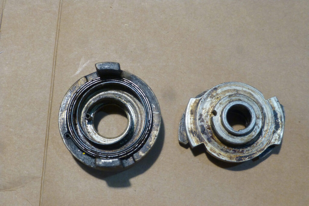

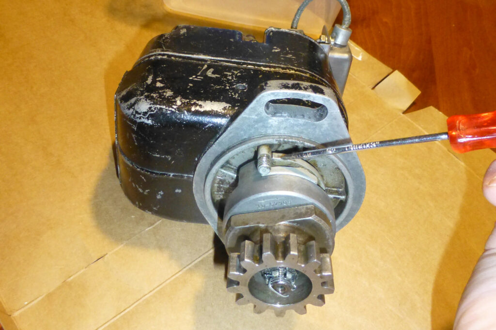

The impulse coupling comes into play to provide both a hot spark and retarded timing during the slow cranking speeds at engine start. The studs protruding in Figure 24 are part of the impulse functionality. Passing along something I learned from the manuals is that the threads you see are for pulling those studs out if necessary; nothing bolts to them. At low RPMs, the lobes of the impulse cam hit those studs and prevent the rotating magnet from turning. After about thirty degrees or so of rotation by the drive gear, ramps in the coupling make the cam lobes retract until they aren’t held by the studs. When this happens, the coil spring in the coupling makes the rotating magnet snap around fast enough to provide a healthy spark. The other thing going on is that you don’t want that spark until after the engine is past Top Dead Center (TDC) or else the resulting combustion will try to drive the piston back from whence it came, i.e. a kickback. Not good.

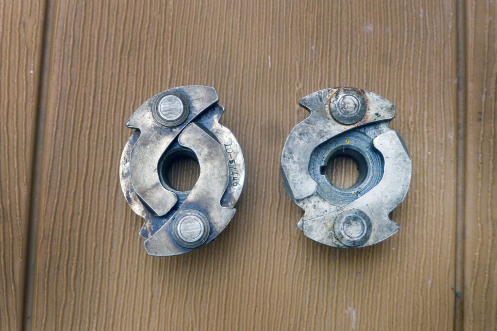

For this reason, the impulse coupler retards (delays) the spark as described in the previous paragraph until the piston is past TDC so that the combustion drives the piston downward such that it keeps the crank turning in the correct direction. Once the engine starts to run and is spinning fast enough, the weights on the cam lobes will keep them from engaging the previously mentioned studs, and the spark will then fire before TDC, typically 25-degrees, which is needed at normal engine speeds. Back when our cars had mechanical distributors, vacuum advance and/or flyweights within the distributor took care of retarding and advancing the spark based on engine speed and load. With electronic ignition, both automotive and airborne, it’s all taken care of by computer chips. On a plane with analog mags, if you hand-prop the engine, preferably with the plugs out, you can hear the clanking of the impulse coupling doing its thing. Most engines have an impulse coupler on just one of the mags, usually the left one, but some aircraft have two impulse mags, because… well, homebuilding. That expensive five-position starter switch that most of us have used during flight training (Off, Left, Right, Both, Start) turns off (grounds) the non-impulse mag during starting so that only the impulse coupled mag is working at the low RPMs.
Reassured that I was going to get spark, I assembled the impulse coupling (use heavy work gloves per the manual) and drive gear onto the armature. The heavy gloves are advised due to the potential for the coiled spring release its energy into your hand as you try to assemble the cover onto the cam lobes.
Again using the ignition leads on sitting on a metal sheet, I turned the impulse coupling by hand and was still rewarded with a spark. Remember to turn the gear to the left when looking at it as in Figure 24. Something that took me a minute to clue in upon is that the mag gear cannot be torqued down too tightly or else the armature can’t be turned independently by the spring, which defeats, well, everything about the impulse coupler. Torque the nut down to just snug, ensure that the gear will turn when the cam lobes don’t, and remember to put a cotter pin in the castle nut. Time to install cover plate and vent/cover plugs, and call it done. Whew. A working mag for the price of a new coil, automotive condenser, and solvent for cleaning.

Get a two-jaw pulley puller for removing the impulse fly-weights, and have patience about removing them.

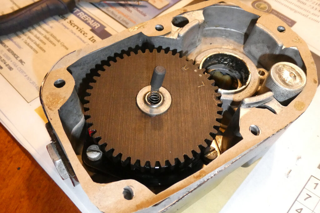

As mentioned earlier in the article, I lucked out in that the bearing races on the flight armature were good enough to reuse, otherwise I’d have had to find a means pull them. I reused my two best looking gear wheels, one phenolic and one plastic, and the two best distributor blocks. A rebuild kit will have a new version of these two items. I also did not have the specified timing or test equipment for final bench testing, but again I’m not reinstalling directly onto a flightworthy aircraft. The drill-powered spark test appears to confirm that they are working correctly, but the proof will be on the engine test stand.

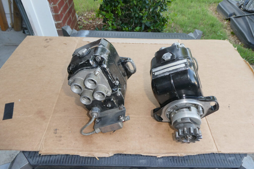

Both mags were taken to the build hangar and installed on the engine, with the flight mag going on the left side and the ground mag on the right. By the time we got them timed and the engine ready to go, we were at the end of the session. Fast forward to the next week’s build session and the flight mag wasn’t making any spark! Why?! How?! What on earth could have happened, sitting in a hangar, such that it quit working? I took both mags home to begin troubleshooting and was stymied for days. All components checked out individually, and the ground mag continued to work even after I swapped the coil, points, and condenser with the flight mag. It was maddening.
Finally the culprit revealed itself: it was the brand new carbon brush in the middle of the rotor: it was compressing down and getting stuck in the retracted position instead of extending up and contacting the coil. I had replaced the brush during the rebuild, so I’m at a loss as to why it was sticking.
Swapping the ground mag rotor to the flight mag made it operational. Whew! I went back to my collection of parts, grabbed another rotor, spiffed it up and installed it into the ground mag with the second new brush from the rebuild kit, and was rewarded with a nice spark when tested.
After using the ground mag rotor to get the flight mag working (and before I had a chance to finish the ground mag), I took the flight mag back to next build session, got it timed and connected it to the brand new spark plugs. We rolled the test stand outside, primed the cylinders, and commenced to converting fuel to noise. After a few more blades than I care to think about, the Lycoming roared to life and ran strongly until the carb bowl was empty! On just the one mag! Carb refilled with fuel, and it ran just as well a second time. The prop was removed and the engine returned to the hangar. The engine and stand were later trundled out for longer run times on a small gas tank, and both mags worked beautifully.
