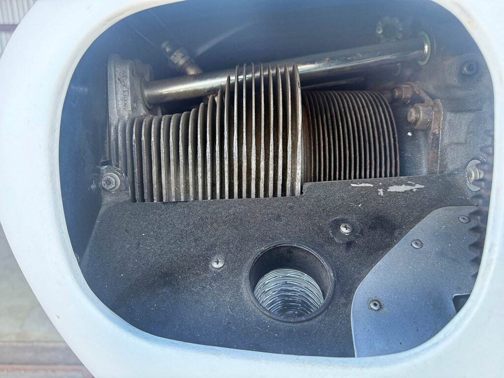

![Air flowing through the cowling incurs a significant amount of drag as it enters the cowl, slows, flows around the cylinders, through oil-coolers, and out the exit. [Credit: Andrew Robinson]](https://www.kitplanes.com/wp-content/uploads/2026/05/No_cooler-1024x768.jpg)

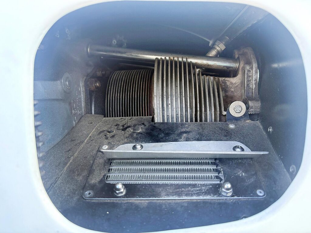

![Air coming into the cowling will pile up in front of the air dam and form a high pressure area that will then flow down through the oil cooler. [Credit: Andrew Robinson]](https://www.kitplanes.com/wp-content/uploads/2026/05/Oil_cooler-1024x768.jpg)

In another discussion, a guy was very surprised that cooling drag was a thing. In his mind, drag was associated only with the air flowing around the outside of the airplane. But the air flowing through the cowling also incurs a significant amount of drag as it enters the cowl, slows, flows around the cylinders, through oil-coolers, and out the exit. Cleaning up drag, particularly cooling drag, was the principal business of Roy LoPresti’s Speed Merchants and its 35 different STCs for drag reduction.

One bit of cooling drag that engineer-me doesn’t care for is the oil cooler at the front of the engine, as shown in one of the photos accompanying this column. The air coming into the cowling will pile up in front of the air dam and form a high pressure area that will then flow down through the oil cooler; in that respect, mission accomplished. However, that same air dam will create fluidic chaos with turbulence behind it before flowing to cylinder numbers 2 and 4. The other photo shows an air duct in the exact same location, but without the air dam. In this case the air will flow into the duct, but with far less turbulence for the air flowing back to cylinders number 1 and 3.
My preference would be taking the air from the back of cowling after it has flowed past the tops of the cylinders and before being forced down through the jugs; we saw a good example of this layout in the August 2025 issue of Kitplanes. Based on articles I’ve read, the inlet air is going to hit the back of the cowling or plenum still pretty much at ambient temperature, so any air bled off for the oil cooler will still be cool air. From there it can flow through the oil cooler and out the bottom of the cowling, leaving plenty of less turbulent air remaining to flow down through the cylinders.
