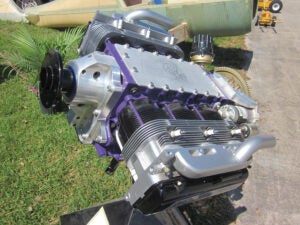

To review the technical details, the naturally aspirated 100-hp engine is built from reconditioned GM parts reinforced by a steel front hub on the crankshaft, an added front main bearing, nitriding, a 30-amp rear-mounted alternator and plenty of new service parts. The 125-hp version gets its oomph from a brand-new, counterweighted, 1/4-inch stroker crankshaft taking it out to 3.1 liters. This is without having to cut the case for overly large cylinders, thus preserving case integrity.

What’s special at SPA is displacement. Interested in upping the oomph in Corvairs, the Wesemans have backed the development of highly modified 3.0- and 3.3-liter unassembled Corvair kits. The 125-hp 3.0 uses big-bore cylinders on a set of bored-out heads and case while the 125+ hp 3.3 adds a billet crankshaft to the big-bore kit. Therefore, these are premium, higher-powered engines selling for more than the standard displacement engines from Wynne, but just the thing for hot rod sportsters.

Although he actually has a variety of Corvair engines in his hip pocket, today Wynne has zeroed in on his 110-hp, 2855cc version. “It’s the main engine I am promoting as the best combination of quality and still good value. It offers all the good tech improvements, such as Ross pistons and other advances, but doesn’t have the high-end costs of recent years. As a complete kit, with carb, ignition, starter and so on, it is $12,600. If you want it assembled, it’s $13,600.”
