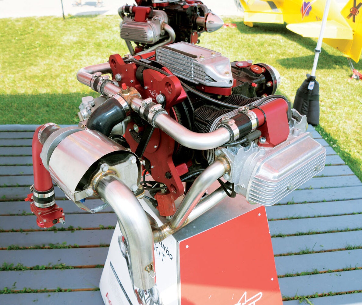

AeroVee
AeroConversions, maker of the AeroVee engine, is the piston-engine division of Sonex Aircraft. A busy, pocket-size aircraft manufacturer producing everything from motorgliders to single-seat jet sportsters and government UAVs, Sonex’s original core is a series of airframes designed for air-cooled Volkswagen power.
There are two AeroVee engine kits, the 80-hp 2.1-liter naturally aspirated engine along with a turbo version rated at 100 hp. A turbocharger water cooling system was introduced three years ago and is a near-universal option on the 100-hp engine thanks to its transparent-to-the-pilot electronic control. AeroVee’s laser-cut baffle system and AeroInjector carburetor are also popular. Spotty parts supply has been an issue in 2021 and going into 2022, notably for pistons. But actual engine delivery delays have been few as AeroVee is motivated to keep inventory up to meet their own in-house demand for Sonex airframes. AeroVee does not offer two-cylinder variants.
