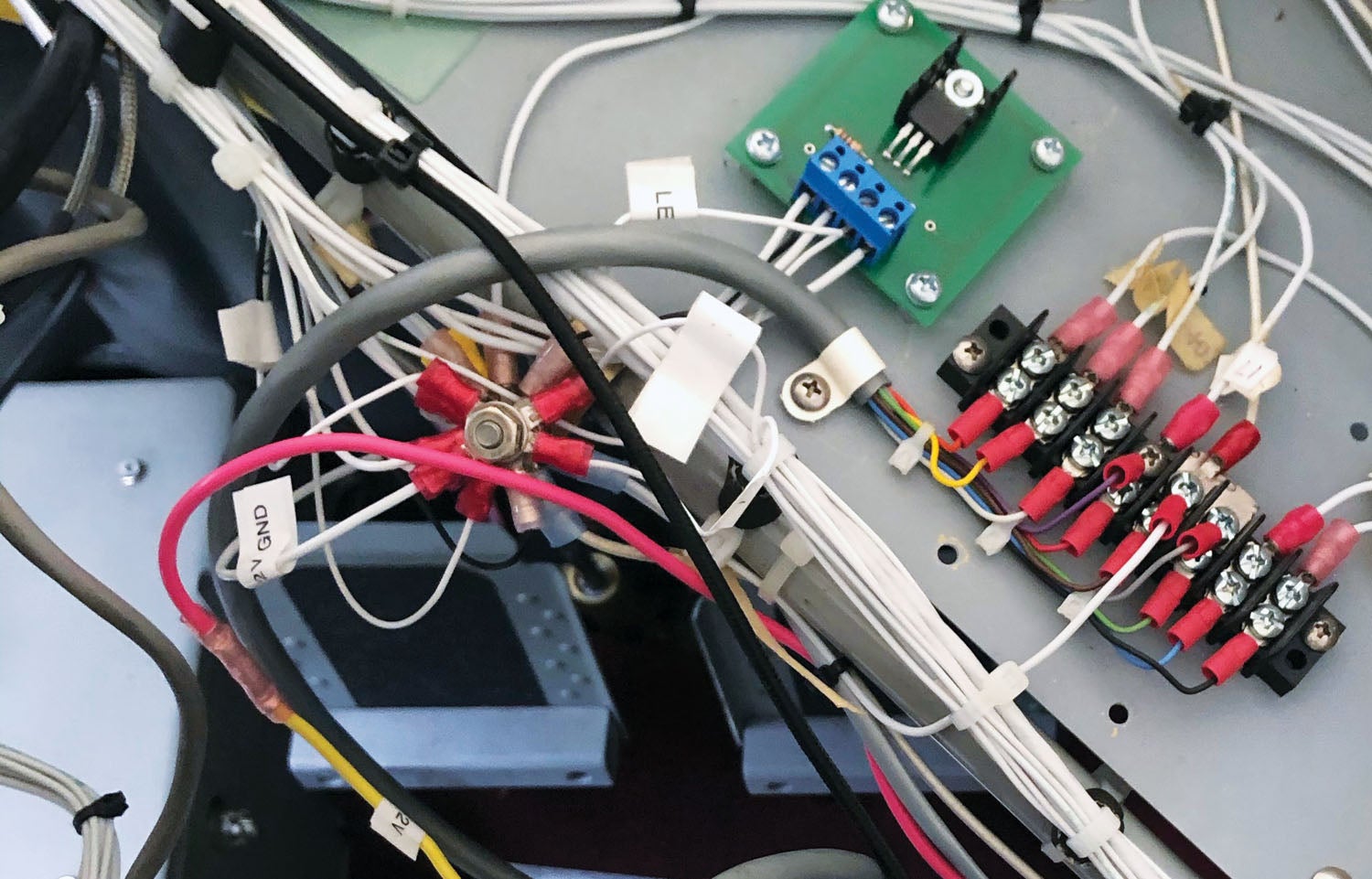

By building a ground bus, you essentially eliminate the airframe from the grounding task and the problems with loose connections, vibration, corrosion and insufficient contact between the ground wire (or ground lug) and the structure. In composite and fabric machines, they’re essential.
Common Ground
And when we talk about ground buses, don’t mistake them for switchable electrical buses (like an avionics bus and a main bus). There’s no switching the ground bus on or off. Don’t overthink it—a dedicated ground bus is simply a piece or pieces of copper for use as the main return point for all the negative leads in two-wire circuits. Dedicated ground buses have become the standard, rather than individual main grounds spread around the airframe.

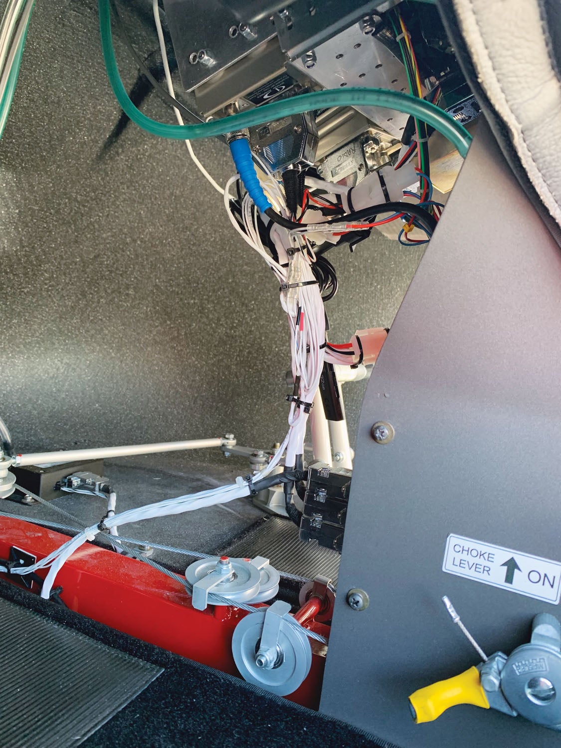

Smart Planning

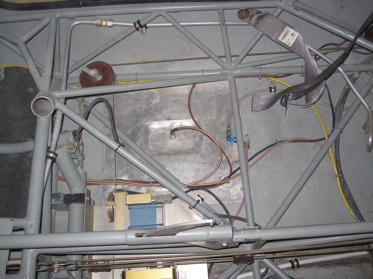

Manufacturers and techs we talked with stressed the importance of planning the grounding system (think of grounds as a whole and a major system in the suite) before you start wiring anything—and before you begin assembling and closing up the major structure. For the typical avionics configurations we work with, plan on bringing all of the major ground wires to a central location in the airframe that is convenient to access. With a dedicated ground bus, all of the grounds will terminate in the same area, and labeling the bus to match your aircraft’s wiring schematics is a must. This makes for easy troubleshooting down the road (you or someone else) while eliminating a tail chase when you’re trying to figure out which ground is causing grief. A centralized ground bus will also make it easier to ohm out the wiring during pin-to-pin troubleshooting.
A common location for building the ground bus is up at the firewall. Think of it as a hub, a meeting point for the system ground wires that run through the fuselage, in addition to the systems in the engine bay that need grounding. Worth mentioning is that you don’t want to use the engine mount for carrying electrical current (and no, not the fuel tanks, either—we’ve seen the horrors). The engine mount itself should be grounded, of course, and an appropriate ground strap should connect the engine to the firewall.
We’ve covered this before, and it’s always worth reviewing. It’s never too early to plan the antenna installation, and their proper grounding can make or break performance. Got an aluminum aircraft? Your job could be easy. Composite or fabric? Maybe not so much. More on antenna grounding in a minute. The planning stage is when you want to think about the antenna installation as a whole to get a feel for the amount of separation that’s required between antennas (it’s a wider distance than what’s practical), and in the case of grounding, what role the coaxial cable might play in critical systems should a bad ground generate noise. This can be a challenge given the small amount of real estate to work with, and WAAS GPS and communications antennas are critical. Map it out, and if there is any doubt on your choice of location, consult with the aircraft and avionics manufacturers, and talk with other builders who successfully built like-models with similar configurations.
The planning stage is also a time to map out how you’ll route the harnesses, including audio system ground wires and coax. Avoid running audio harnesses next to devices with AC fields or even moderate pulse outputs. Strobes (including efficient LED lights), systems with large current draw, power lines, heaters, fans and servo motors are all known problematic systems when it comes to noise and interference. Solid grounding helps tame that dragon. When it comes to properly grounding audio systems (where faulty grounds might surface first), the pros have tips to bank on.

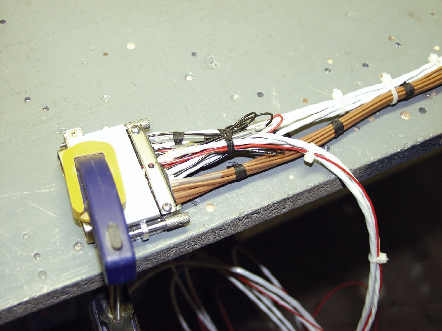

A ground loop isolation filter can help, but if the circuit is wired correctly, you shouldn’t need one. When running power and ground wires for devices, keep those pairs away from wired audio connections. Maintain good practices throughout the entire audio system and use isolating washers for audio jacks to prevent ground loops. Audio jacks that make contact with the metal instrument panel (without the use of isolating washers) create an unwanted second ground path.
For avionics that use the metal slide lock or jackscrew backshells, ground the shields of wiring that are shielded at the unit end directly to the backshells using ring terminals. This will offer a good return path for the wire shield for the wiring that requires the shield termination. We’ve lost track of the number of audio installations we’ve troubleshot where the audio panel grounds were out of place—or missing. Last, wire the grounds back to audio panels and not to the airframe.

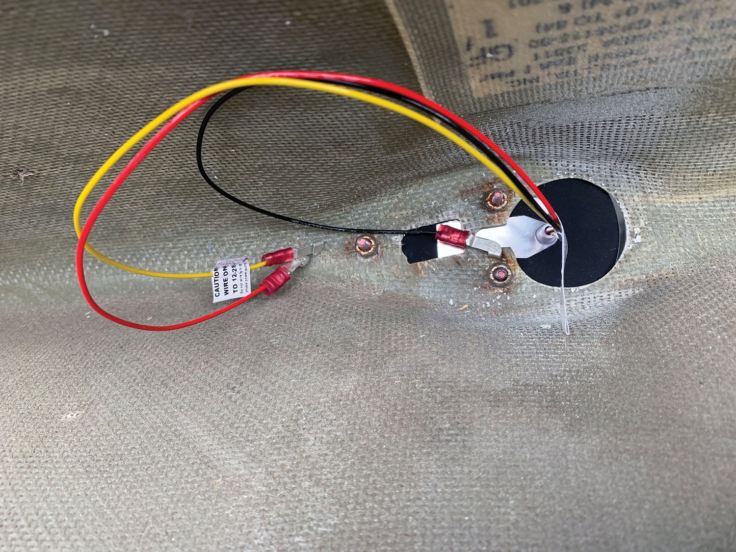

For example, there’s a tendency to ground heated pitot tubes, wingtip strobes and other lighting inside the wing, but the pros will tell you that’s a bad idea. Instead, run the lighting system’s grounds to the ground bus. For the wing-mounted magnetometer, a dedicated power ground should be used and returned as a twisted pair, along with the power source back to the ground bus.

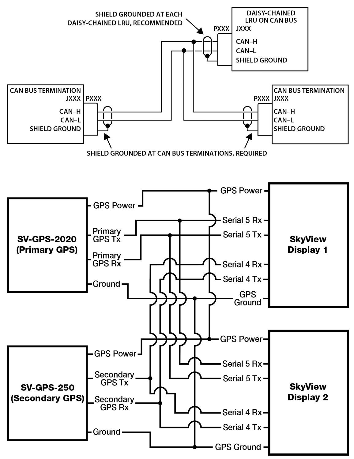

Garmin advises to use caution with wing root Cannon plugs used for Can bus connections to and from the magnetometer because the multi-purpose connector can also carry power and ground wires for, say, a high-current circuit for a heated pitot tube. While the magnetometer’s shield wire can run through the Cannon connector on a dedicated pin, there will still be a short run of the data bus that’s unshielded and prone to interference problems. Isolating the Can bus data wires is the best bet, even if it means running dedicated wires for the device back out of the wing to the ground bus while maintaining physical separation with the device’s twisted pair databus harness with high-current carrying wires. Easier said than done in small aircraft.
Pay particular attention to the grounding instructions for autopilots—and autopilot servos in particular. As one example, in Garmin’s GFC 500, the trim output commands come directly from the autopilot pitch servo to the trim motor (for automatically running the pitch trim when the autopilot is engaged). The output from the pitch servo to the trim motor is grounded to the shield on the servo side of the circuit and grounded to a common airframe ground. Any deviations to this wiring can cause sizable interference whenever the trim motor is running—and it’s enough to disengage the autopilot and cause noise in the audio system if the com antenna coax is in close proximity, which it often is.
Grounding problems will create all kinds of issues with the magnetometer’s heading resolution and even with other functions within the EFIS architecture. You could see intermittent heading error, you might struggle to get the system nulled during the configuration stage, and in some cases, the EFIS may not work at all, showing invalid heading, attitude and other flight data. Engine monitoring systems are also at risk.

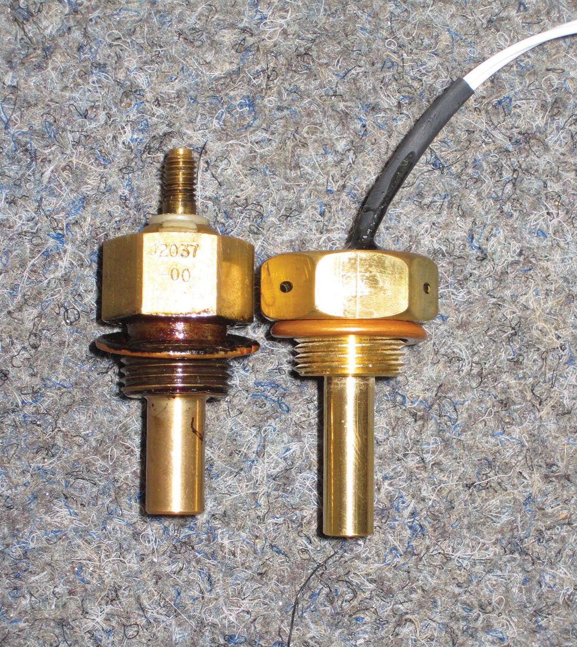

Dynon’s engineering points out it is vitally important that all major components within its systems—including engine sensors, the SkyView display, the engine monitoring module and the electrical system—share the same ground and to ensure that there is virtually no measurable floating voltage between these grounds.
Dynon says that running a ground wire from the EMS (engine monitor) to the engine block may not entirely solve the grounding issue, as this adds just a small wire in parallel with another much larger wire, and the load will get transferred to this smaller wire (which itself is resistive due to its small size). You likely won’t see any improvements. Run the grounds to the bus.

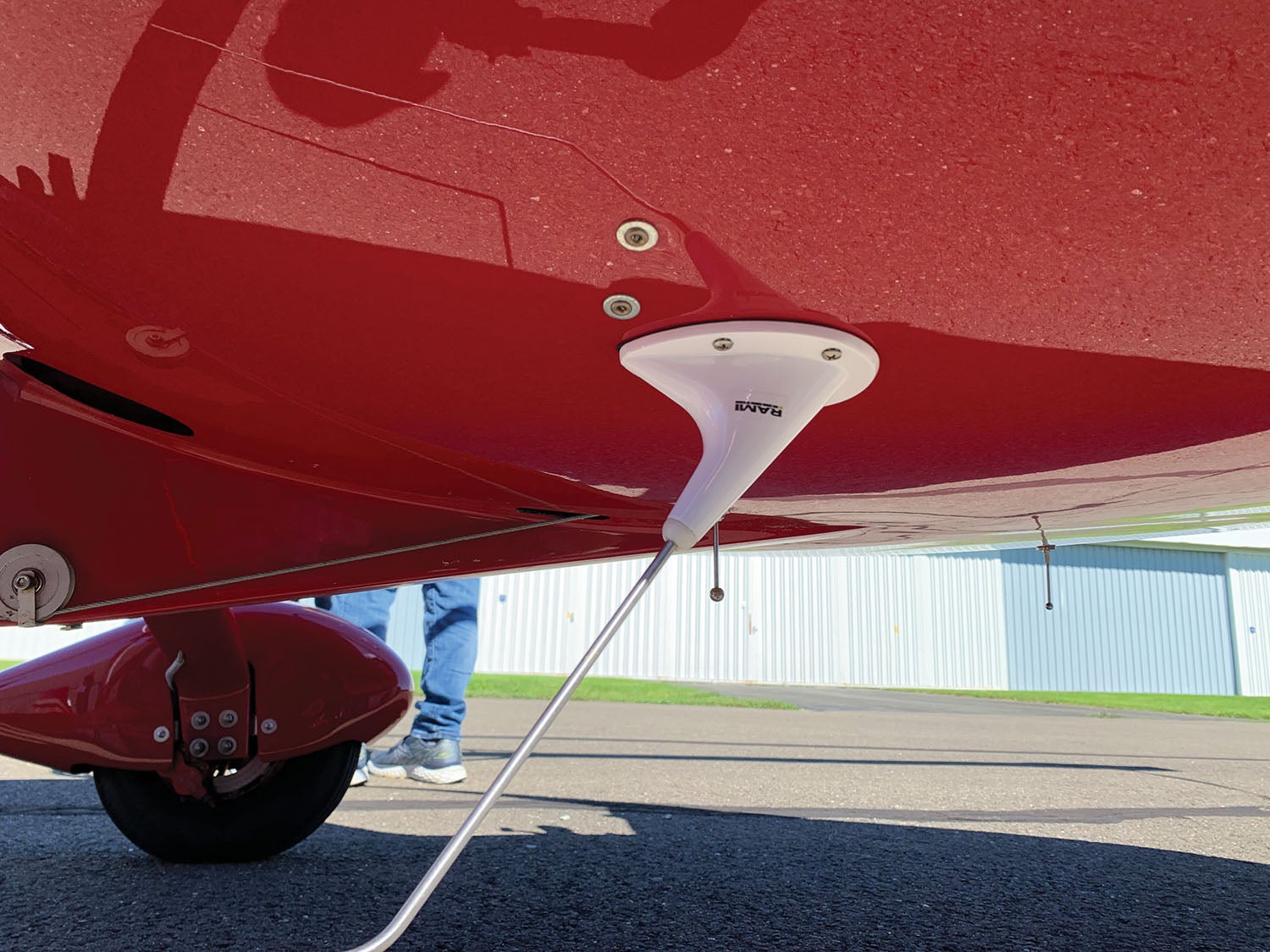

Antenna Ground Planes
Don’t underestimate the importance of proper antenna grounding, and dealing with antenna farms is a challenge on small airframes. We asked the engineers at antenna manufacturer Comant Industries if there’s a general spec for designing the size of a ground plane, and it reiterated what we already know from years of antenna installation experience: Bigger is better, but that’s not always possible, especially on fabric and composite installations. At a minimum, a circular ground plane’s diameter can’t be any shorter than the antenna’s base.
Poor continuity generally means poor performance. Perhaps you’re fabricating a mesh ground plane for an antenna on a composite structure. You’ll need to be certain there is proper contact between the antenna’s mounting screws (oftentimes where the grounding takes place) and the mesh. While this is a very basic concept, it’s one of the easiest tasks to get wrong. The FAA’s Advisory Circular AC 43.13-2B is a good place to learn about acceptable methods. A ground plane may not be required for all antennas, but it’s still recommended. That’s what Garmin says in the installation manual for the WAAS antenna used with its G3X Touch integrated avionics system, and they suggest the conductive ground plane be a minimum diameter of 8 inches. Like many antennas, the WAAS antenna is grounded through the mounting hardware and the coaxial antenna connection.
For fabric aircraft, the drill is to fabricate a ground plane using heavy foil tape or other metallic surfaces for a solid bonding of the antenna. Since there might be limited structural space available for mounting antennas on fabric aircraft, the installation of some systems just might not be possible. Again, AC43.13 provides guidance.
The Garmin manual suggests that the mounting hardware (washers and nuts) and doubler plate should make contact with an unpainted grounded surface to ensure proper antenna grounding, so prep the surface accordingly. It is important to have good conductivity between the coaxial shield and the ground plane. The bottom of the antenna base doesn’t need to make contact with the ground plane because the antenna will capacitively couple to the ground plane beneath the paint or covering.

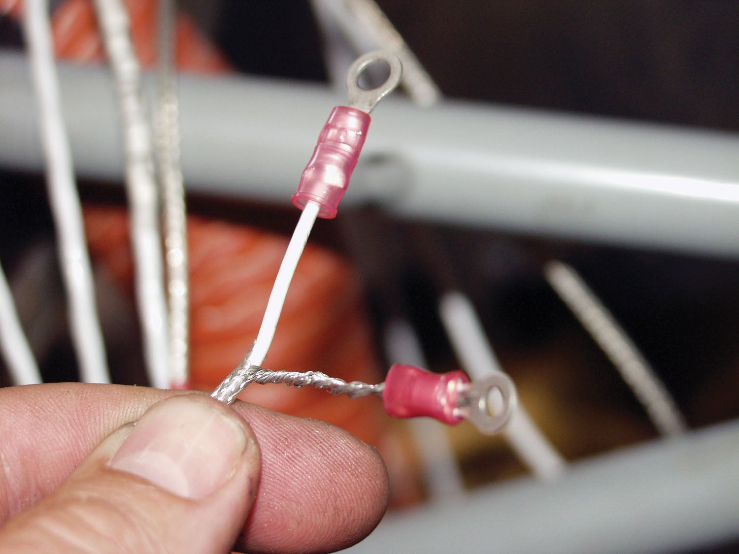

I have realised how critical this is over the years with very unusual problems directly linked to a bad earth .
Some cables are crimped to the lug , while others are soldered . I personally prefer soldering cables to lugs due to living at the coast and finding corrosion at the lug between it and the cable over time , often not very long at all .

I did a Dynon heated pitot tube installation last year. I was surprised to see that they wanted to run a ground wire back from the unit, and not just ground to the airframe. The instructions said that running the ground through the airframe will induce noise. First time I’d heard of this, but now I’m being more careful, especially with the high current draw loads.
The heated pitot issue is a classic result of the poor discipline in nomenclature and convention. The heated pitot does not have a ground – it has a power input conductor and a power return conductor. The metal assembly itself is another issue, and is generally directly connected to the airframe by its mounting hardware, much like an antenna. If the pitot heat power is carried by a twisted pair, much potential noise generation is avoided. If the power return is “grounded” at the probe location of the airframe, then you have a loop antenna, where anything in the vicinity of the probe power conductor anywhere along its length will may receive h field noise associated with the noisy power controller for the heater. When the power is provided by a twisted pair, the loop antenna is small (between the two conductors) and is pretty much cancelled. Using the airframe as a “ground” or power return, is a holdover from old vehicles with simple and insensitive electronics (older cars, etc). The proper method is twisted pairs for all power supplies, and twisted pairs or triplets for all non-RF inputs, shielded inputs for all RF or very sensitive inputs. The only downside to such pairs is weight, so where the power is not noisy (like a linear circuit, not a switching circuit), and the power can be routed close to the well-bonded airframe separate from sensitive stuff, can the power return be connected to the airframe near the load. All the power returns go the the “single point” common, directly connected to the battery return (-). All the signal returns go to either the same “single point” or to the signal’s minus input on the instrument if the signal is true differential. Pay attention to this and the magnetometer will have no interference from your systems, the radio audio will be quiet, you won’t hear an alternator whine, etc. Ignore it and you can see those issues and more, like an aircraft problem I saw and fixed where adjusting the cockpit lighting affected the fuel quantity displayed.
I agree with 99.9% of Erik’s comment. I would only add that it is not entirely necessary to use twisted pairs of power input and power return wires. Current flowing through each wire generates a magnetic field around the wire. Do a web search for “magnetic field around a long straight wire” for a detailed explanation. The power input and power return wires generate opposing magnetic fields due to the current flow in opposite directions in the two wires. These opposing magnetic fields cancel each other pretty well. The advantage of the twisted pair is that twisting the wires together results in them staying in close physical proximity to one another, ensuring the magnetic field cancellation. But you can achieve results almost as good by running the power input and power return wires parallel to each other and keeping them in close proximity to each other with heat-shrink tubing, cable ties, lacing cord, and/or braided sleeving, aka “snakeskin”. One disadvantage of twisting the wires together vs. running straight wires in parallel and keeping them close together is that the twisted pair requires more wire to get from one place to another. (Another disadvantage is the twisted pair requires a little more space to get through snap bushings etc.) The length increase results in a small increase in overall wire resistance (and hence voltage drop) and weight, and if you’re using a harness made by a vendor, you may not have enough wire to get from one place to another. I tested the straight wires in parallel approach with pitot heat wiring running close to an ADAHRS with a built-in magnetometer, and the PFD compass dial didn’t move as I applied and removed 10A of pitot heat current. If you use the airframe for the power return, you will be very hard pressed to achieve magnetic field cancellation. That’s because the power return current flows diffusely through the airframe, instead of being concentrated in the power return wire. And don’t forget that aluminum oxide is an insulator, and anodization of airframe parts also creates a surface insulating layer on the parts. Consequently, running a separate power return wire may save you from a difficult-to-troubleshoot grounding problem somewhere down the airway.
