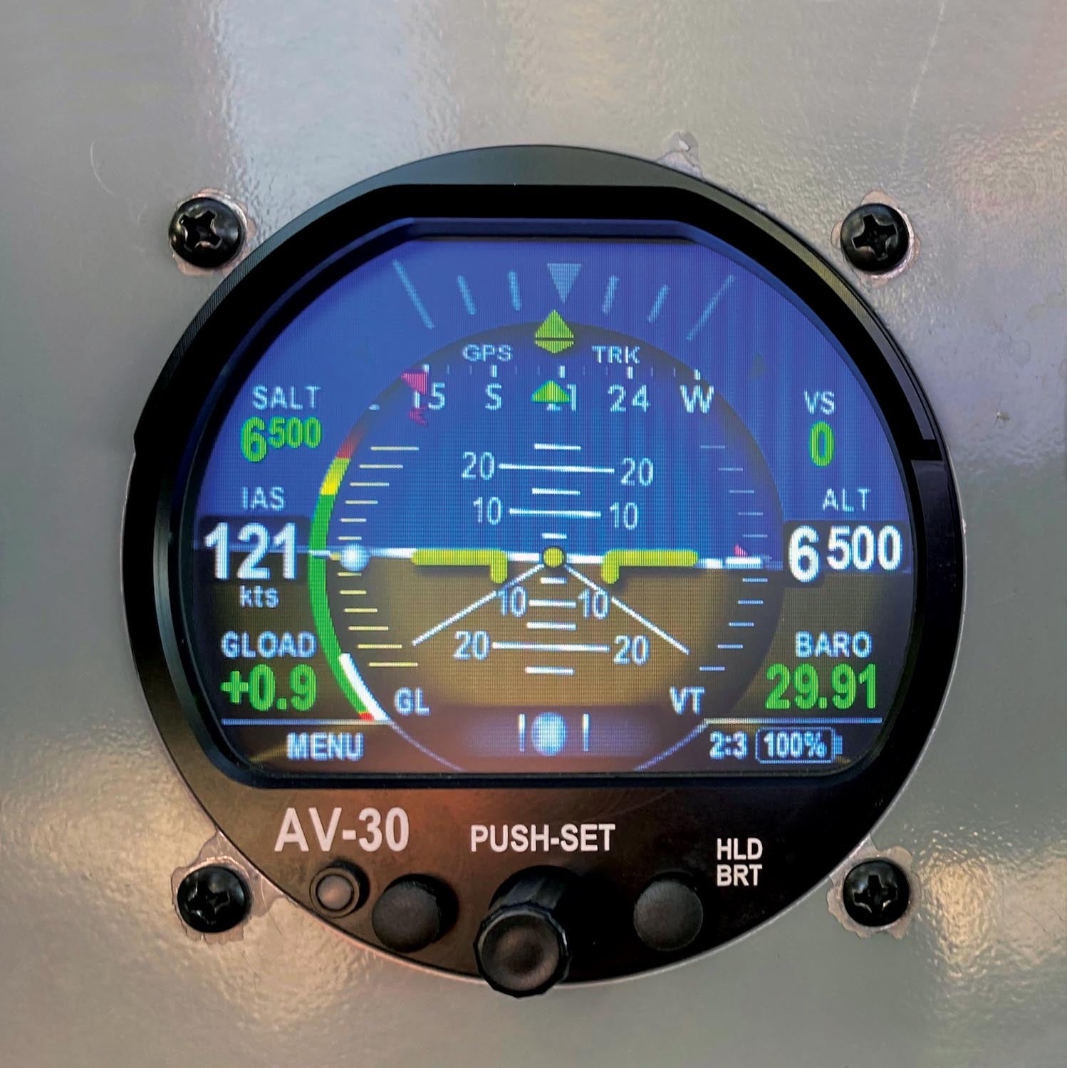

I installed the AV-30 in 2020 to join a pair of Garmin G5s. My immediate impressions were good. The basic functions of the AV-30 were mostly right on—its attitude solution was always very solid and its pitot-static performance was dependably good. The display is plenty bright. In 300-plus hours, the AV-30 has been 100% reliable, despite occasionally running test software.
AV 30 2
The primary AV-30 display in flight. Most of the fields surrounding the main attitude display are customizable.
But not perfect. Early in the AV-30’s life, uAvionix was trying to derive a directional gyro strictly in software. It was, for me, a partial success, though I’ve read many more-strident complaints about it from other users. (Perhaps I was lucky?) Over time, uAvionix updated the software and then enabled an internal magnetometer, which provided another level of improvement, though it was never as good as the Garmin G5 with the remote magnetometer. Finally, the company introduced the AV-Mag remote magnetometer, which I installed in my airplane’s right wing. With that $299 accessory, the AV-30 finally had accurate, stable, repeatable heading indications.
Through all this, the AV-30, when either in the AI or DG mode, could be flown showing either the DG or a GPS ground track as the primary heading source. Initially, though, there were limitations. The DG screen using the internal heading reference couldn’t display nav data, and the screens showing nav data could only rely on GPS track. A very recent software update allows any combination of internal heading reference (DG) or GPS track with nav overlay.

The AV-30 has always had a feature not found elsewhere: derived angle of attack (AoA). After a straightforward setup, the AV-30 will display this derived AoA based on attitude, load factors and airspeed. Not having a “real” AoA in the airplane at the same time, I can’t say if it’s a 1:1 equal to a pitot-derived AoA but it worked well and faithfully responded in ways that I expected the airplane to under different speeds and load factors. I came to include it in my maneuvering/landing scans all the time.
