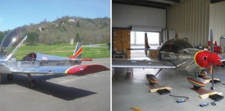

Shortly thereafter, kit Number 10 was discovered in France. Noted race plane builder Andy Chiavetta had already begun—and stopped—work on this kit for a client who apparently was planning on excess power as the tail group had been enlarged, plus many parts were missing. But perhaps only 5% of the kit had been assembled and the large tail modification could be put back to stock, so Electroflight bought the kit. There, chief fabricator Rob Martin, plus Robert Targett and our friend McKee, became the airframe’s main builders. A composites expert 30 years on, Martin’s background in F1 and IndyCar construction transfers well to aircraft.
In addition to kit Number 10, Electroflight also bought Big Frog, a completed, flying French NXT that had been wrecked. It had been constructed with removable wings, which adds weight—the last thing a battery airplane is looking for—and was generally too far gone to rebuild in any event. Electroflight has turned it into a static test rig for the new powertrain, nicknamed ionBird.
