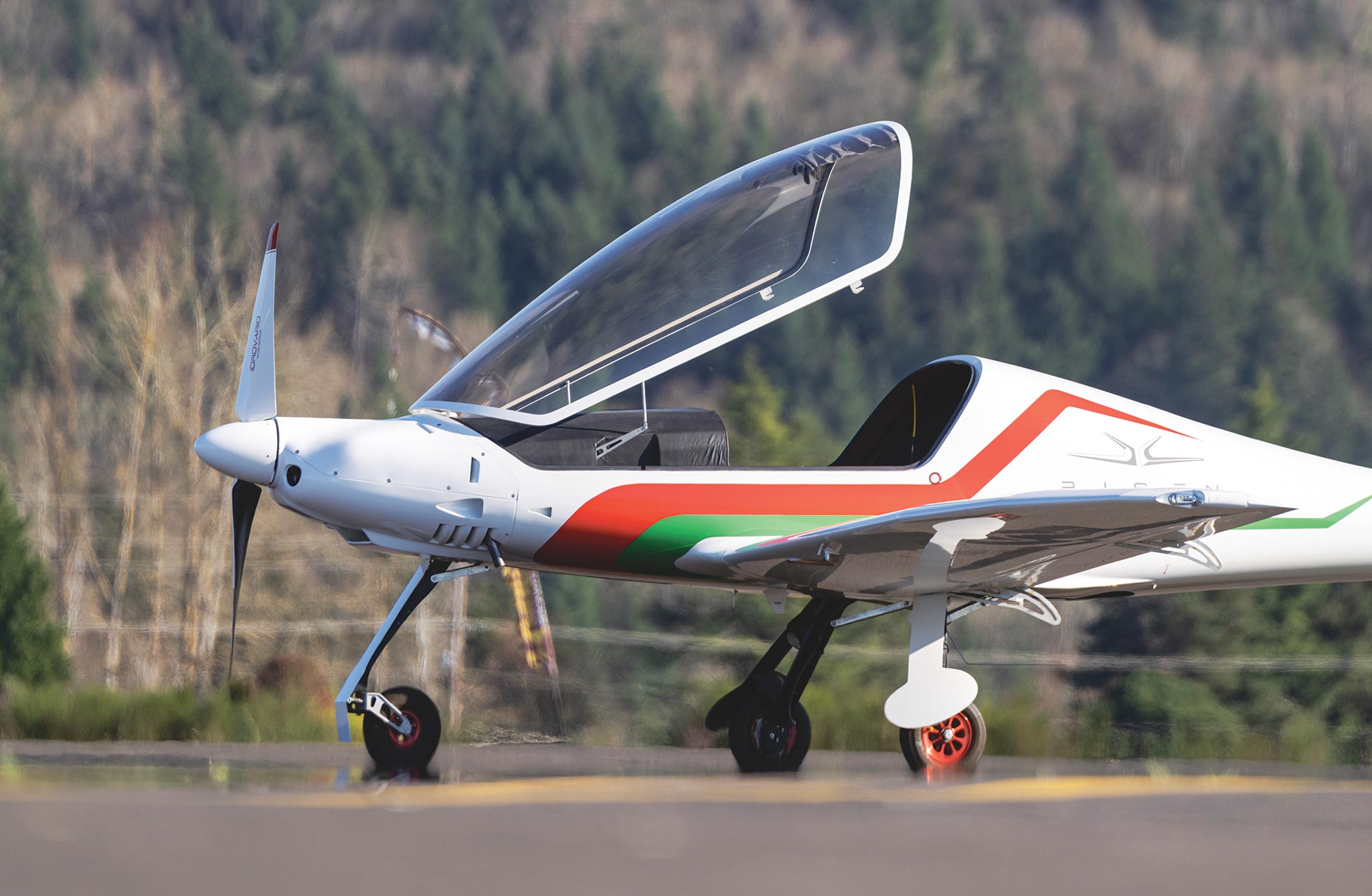

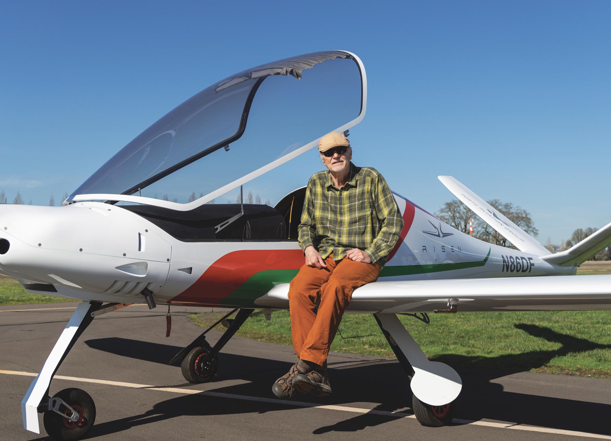

Risen on the airfield with canopy open
Why, what a large canopy you have… The Risen’s front-hinged canopy helps provide low drag with good visibility.

That canopy, by the way, has a novel opening system. Because it’s a big piece of “glass,” it’s fairly heavy, so the Risen uses an electric lift. You have a fob-like remote control that raises the canopy to the open position once you’ve released the two mechanical latches on each sidewall. Slowly, the canopy hums open and you hop in. Close it with a big rocker switch on the instrument panel. You can physically disconnect the canopy from the lift mechanism in case you need to get out and the airplane has lost all electrical power. If the battery goes dead while you’re outside, you’ll need to connect it for a recharge before you even get in.

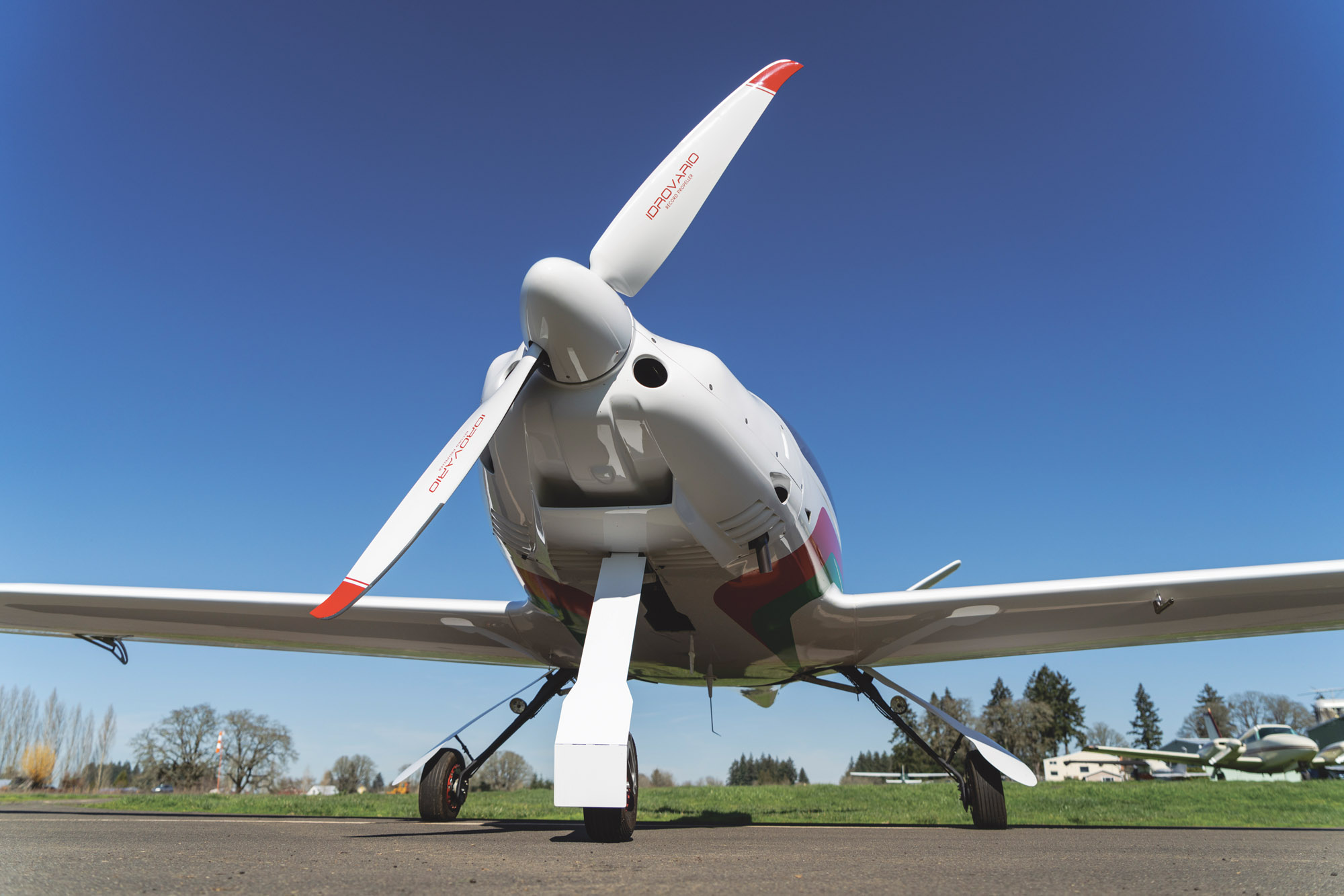

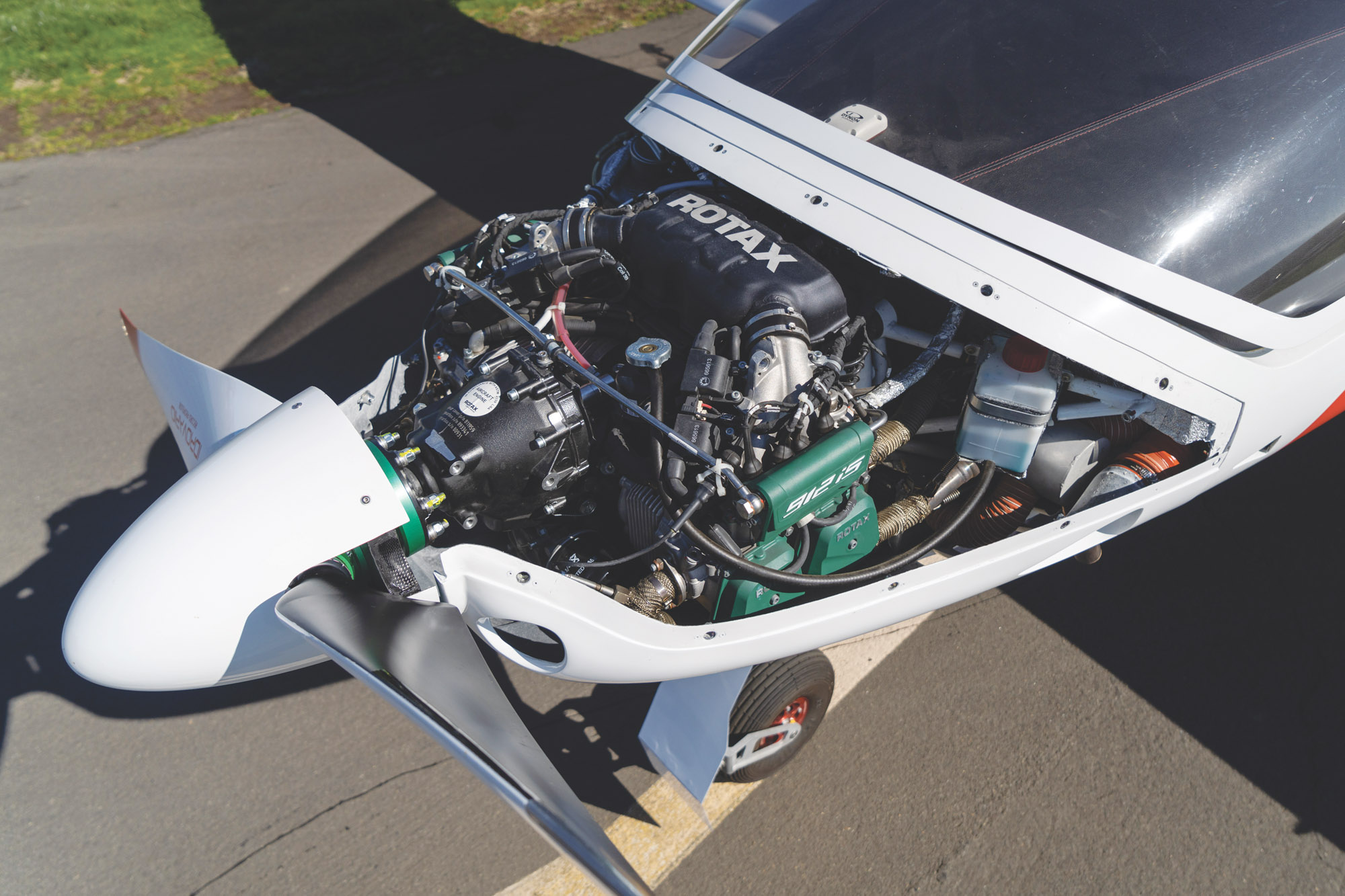

Now walk around the front and you’ll see some other ways Porto finessed this kind of speed out of 100 hp. The cowling is closely wrapped around the small Rotax but swells gently all the way back to the cabin, whose interior width dimension is said to be 48 inches. The coolant radiator is a bottom feeder, in typical Rotax form, and there are small additional ducts for the intake air, oil cooler and cylinder-base cooling. You don’t have to have your tape measure in hand to notice they aren’t large. Reducing wetted area and cooling drag as much as possible is the goal here.
rotax engine in the risen
Rotax’s evergreen 912 iS, with electronic engine controls, is at the pointy end.

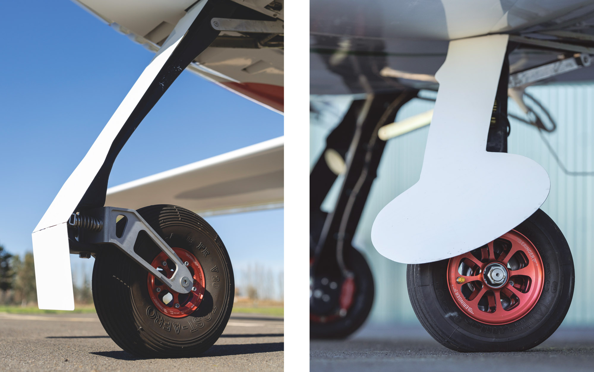

Folding the landing gear during flight is another way to buy efficiency. In the Risen, the tricycle landing gear, made of molded carbon fiber, folds neatly into the belly using a trio of electrically driven jackscrews. Think of the systems used for flaps in a lot of homebuilts. Three separate electric motors are governed by microswitches that stop the gear when they reach either fully down or completely retracted. There are no uplocks. There are logic circuits to control the panel lights—green for down, red for up—and manage power when the jackscrews reach their travel limits.
Most gear systems have some form of redundancy, and so does the Risen’s. First of all, any single microswitch only manages the gear in one direction for each leg—a single switch failure won’t disable the whole set. And then there’s a backup system. A completely separate electrical circuit can provide power directly from the battery to each jackscrew to drive it to the down position. When it reaches the limit, the jackscrew motor will bind and pull more current that the breakers are rated for, popping them and signifying that the gear is as far down as it’s going to get.
risen landing gear
High-quality components abound, from Beringer wheels and brakes to the carbon-fiber landing gear legs. Full fairings are standard.
Careful use of fixed fairings allows the gear to be completely enclosed in the fuselage when retracted without the need for extra gear doors or systems. One downside is that the gear has quite low extension and retraction speeds—you must be at 70 KIAS or below to extend or retract the gear and can fly as fast as 76 KIAS once the gear is down. The limits are primarily to protect the fairings and, secondarily, to take some load off the actuators. These combine with similarly low flap speeds—86 KIAS max for partial flaps (used for takeoff) and 70 KIAS for full flaps—to make speed management fairly critical in certain phases of flight.

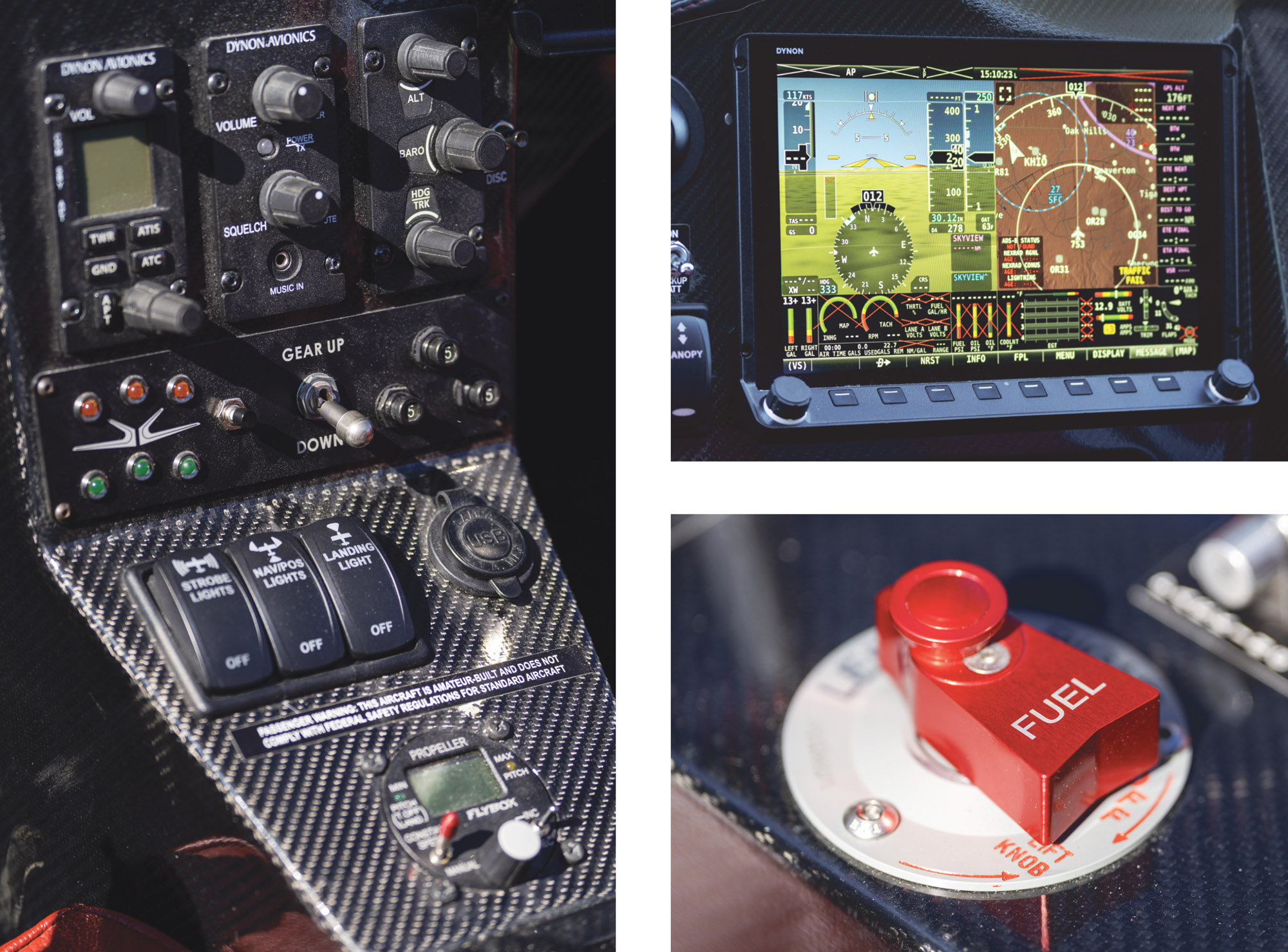

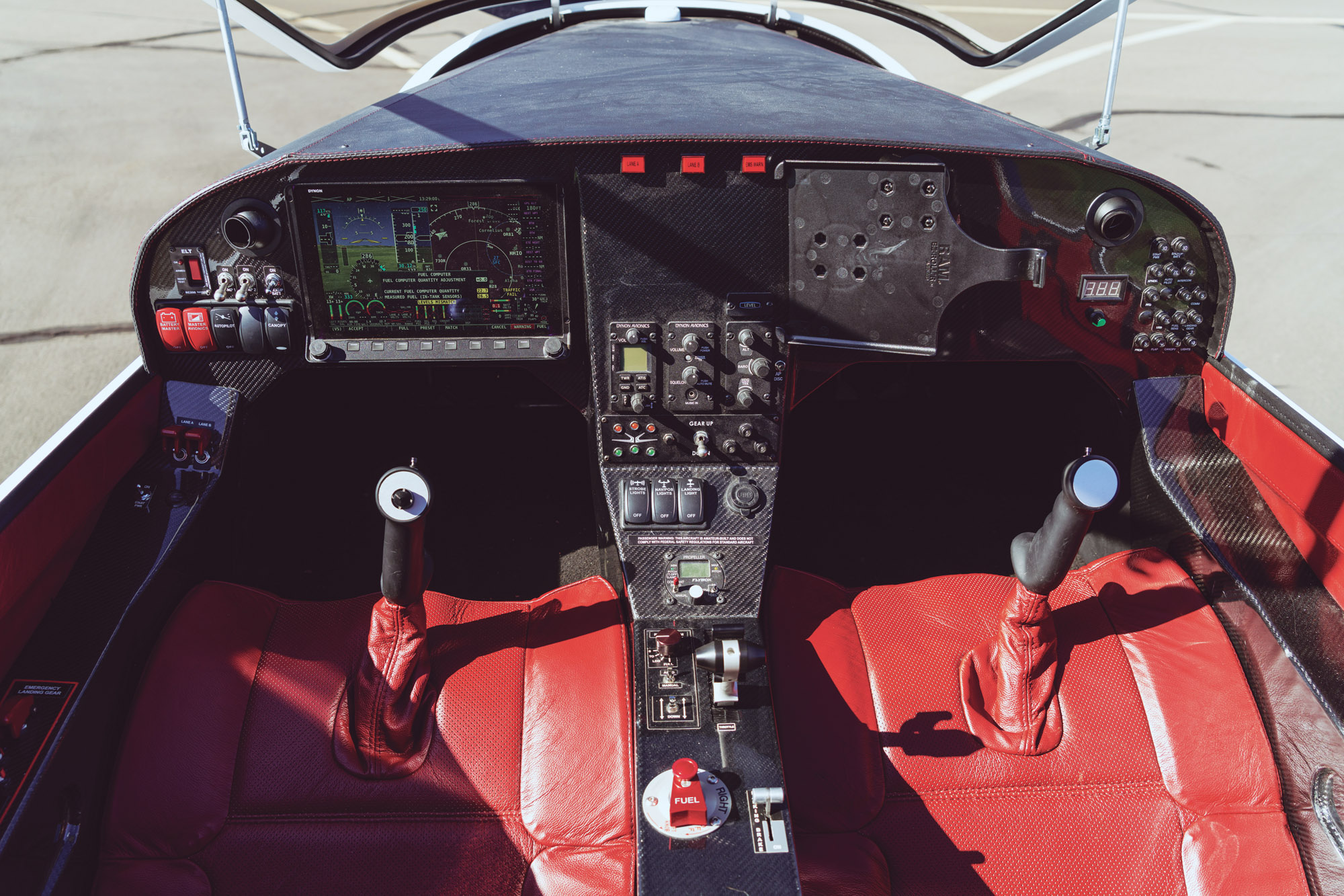

All of these goodies reside in a well-organized flight deck. The fuel selector is prominent beneath your right wrist, with the parking brake control just to the right. The T-handle throttle feels substantial and comes with a pull-to-release lock, which keeps it from creeping away from your desired setting. Just ahead is the prop controller, switches for exterior lights and then the panel with the gear switch, function lights and pullable breakers for the primary circuit—everything you need to know about the gear is right there, in plain view.

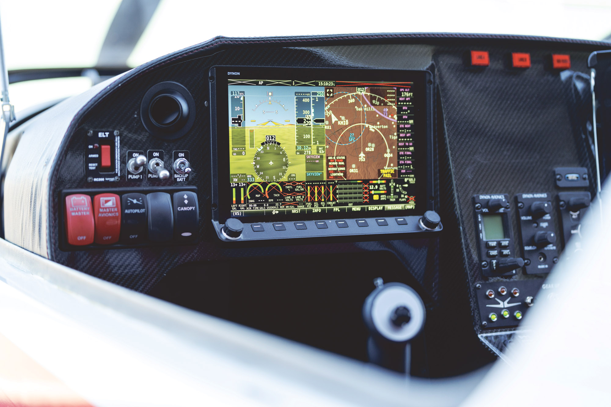

Builder Mark Jardini opted for a single Dynon HDX EFIS and engine monitor, the 10-inch display located in front of the pilot. A second screen could be mounted in front of the passenger seat for redundancy, but Jardini felt that for a VFR-only airplane (his choice) a single screen was fine. He has provisions for an iPad to mount on the right.risen instrument panel
The Risen has conventional sticks at each seat and, for the most part, the control system is also conventional by sailplane standards—pushrods operate the ailerons and the pitch control is via pushrod back to a control mixer for the V-tail. Here’s where some of the magic happens, as it does for all V-tail aircraft. Rudder and pitch inputs are combined to determine proper deflection of the elevator/rudder surfaces on the tail. (Beech called them “ruddervators” on the Bonanza, which seems appropriate here as well.) Twin trim tabs combine for pitch and yaw trim.
risen panel and interior
Jardini’s Risen is modestly equipped with a single 10-inch Dynon HDX EFIS and remote-mount radios. He did opt for the two-axis autopilot.

risen interior details
The console (left) includes controls for lighting, radios, landing gear and propeller. You can get one, two or three Dynon HDX screens from the factory (top right). The Rotax feeds from two wing tanks holding 26.4 gallons total (right).

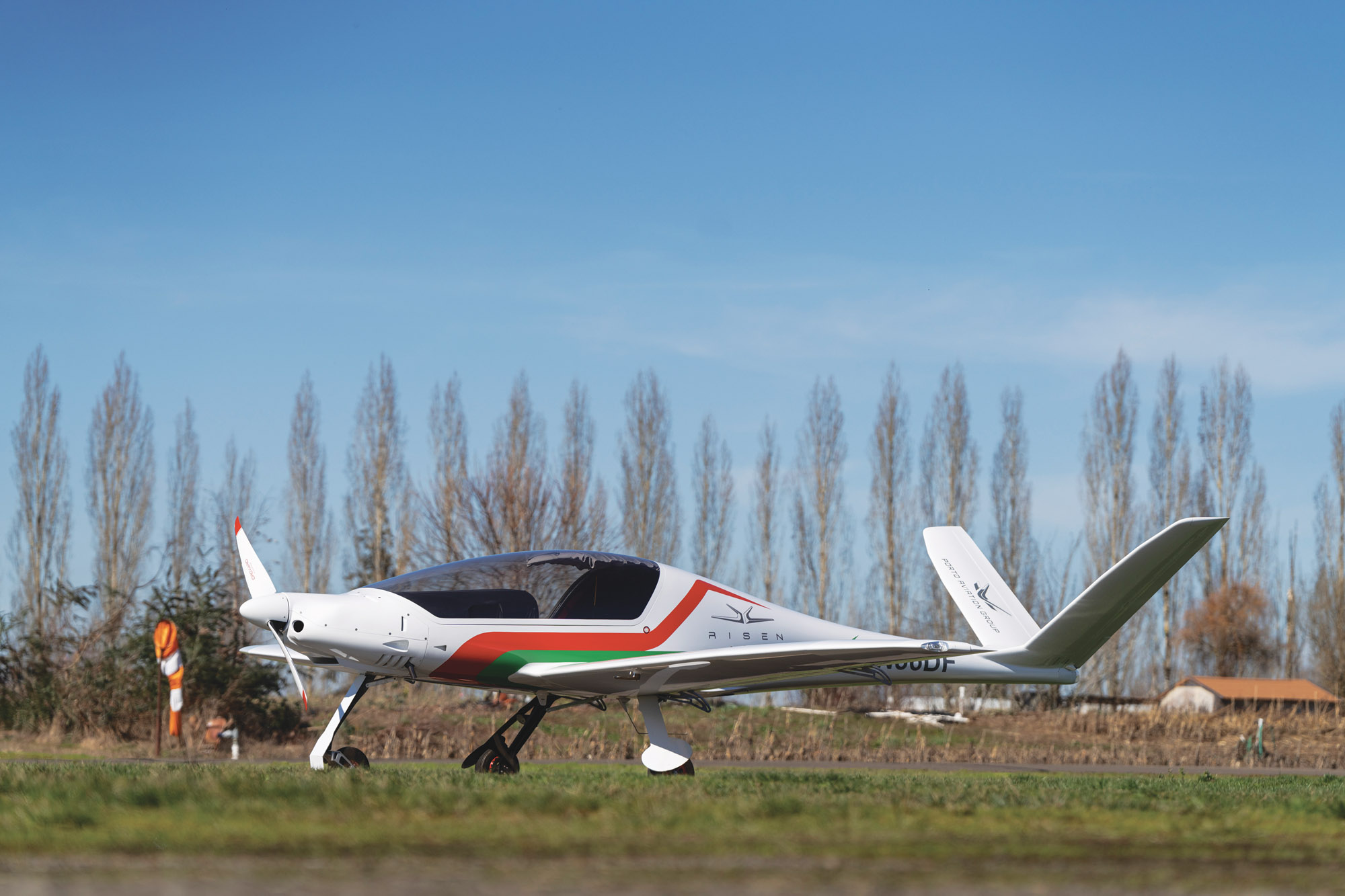

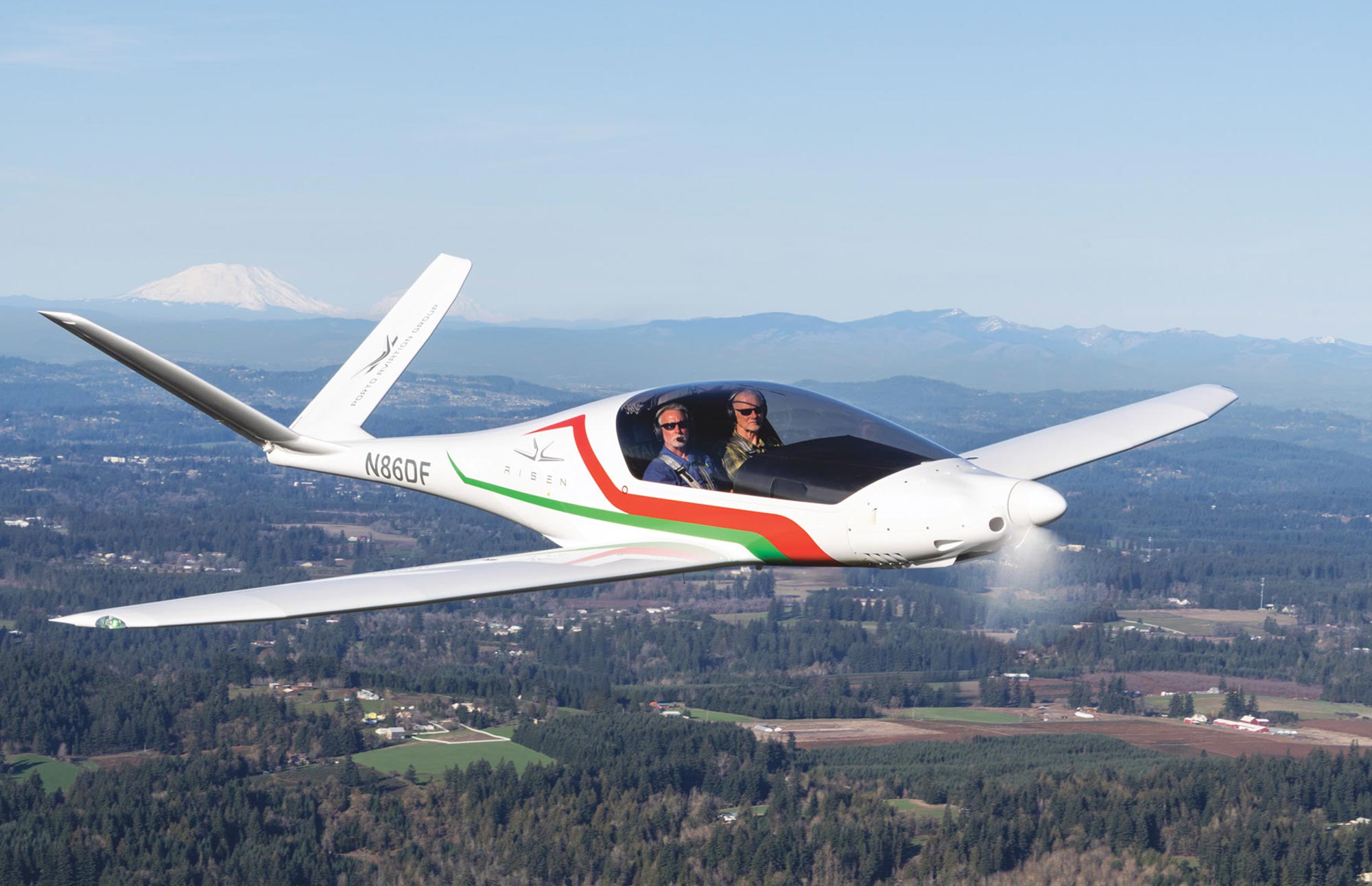

risen in flight
A profile view is pretty much all you need to understand the Risen’s high speed-for-power ratio. It’s aerodynamically clean, with plenty of wing to enable low landing speeds. The retractable tricycle gear certainly helps.

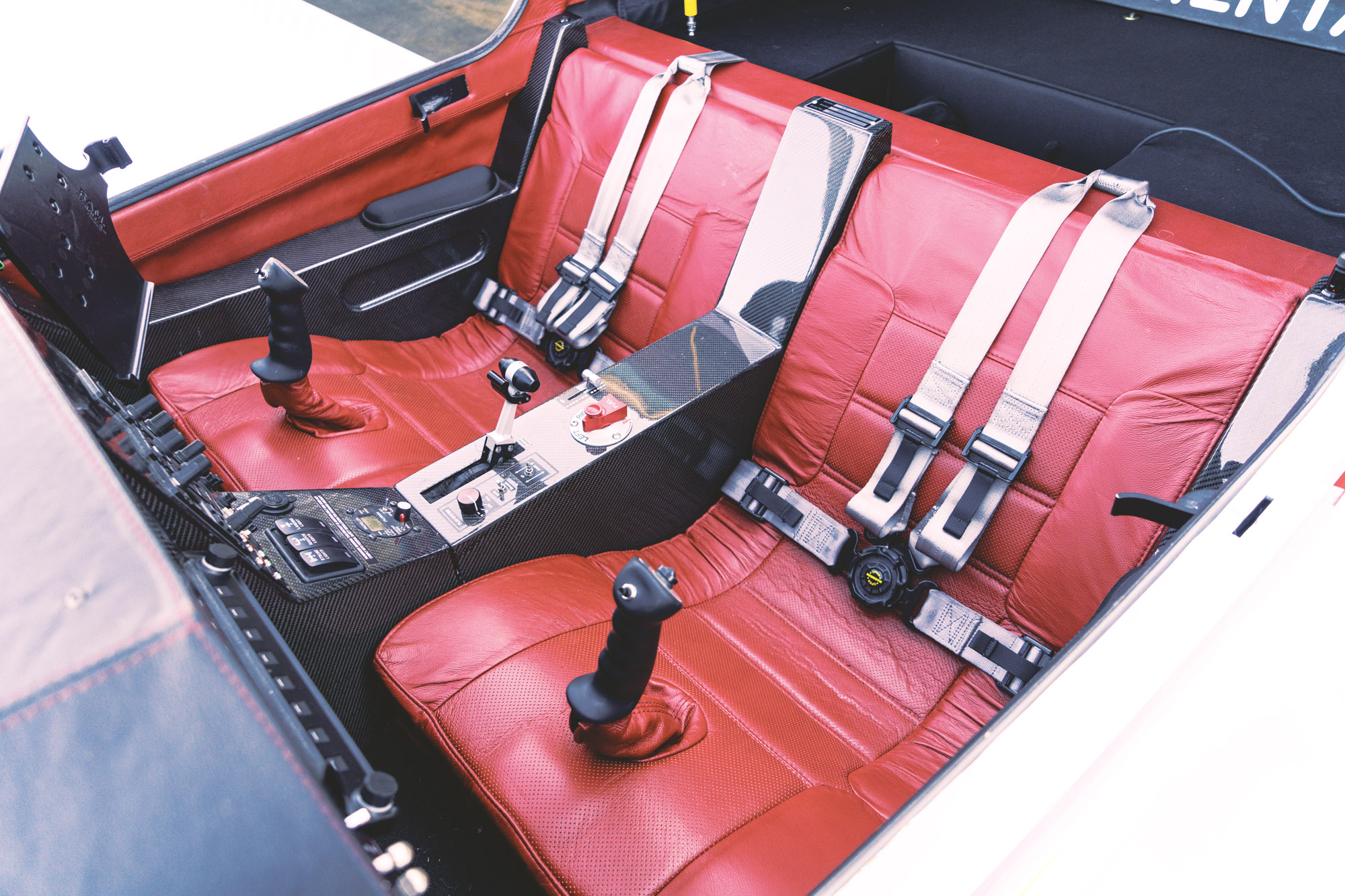

Standard upholstery is “vegan” leather, nicely rendered. The four-point safety belts are an extra-cost upgrade.

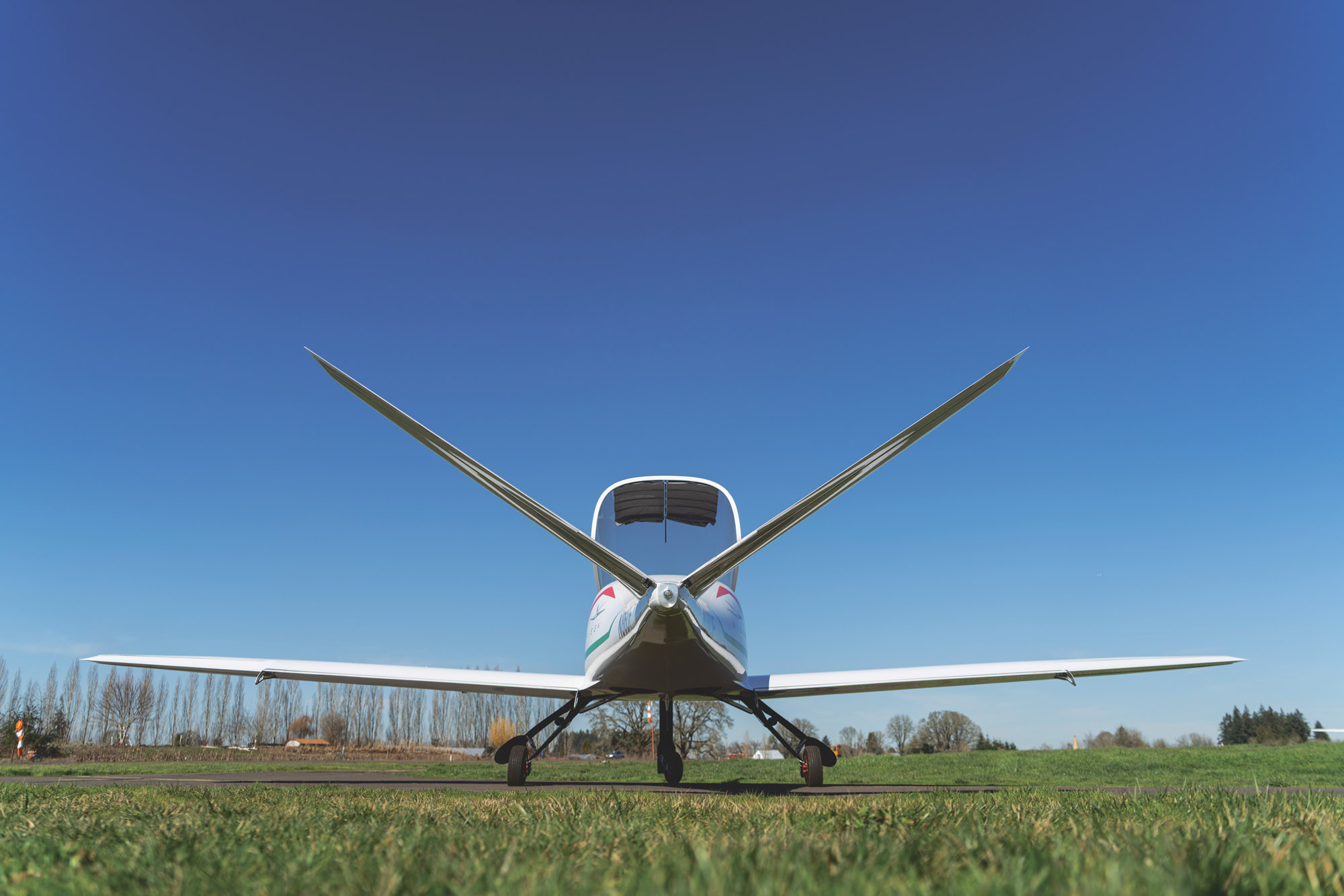

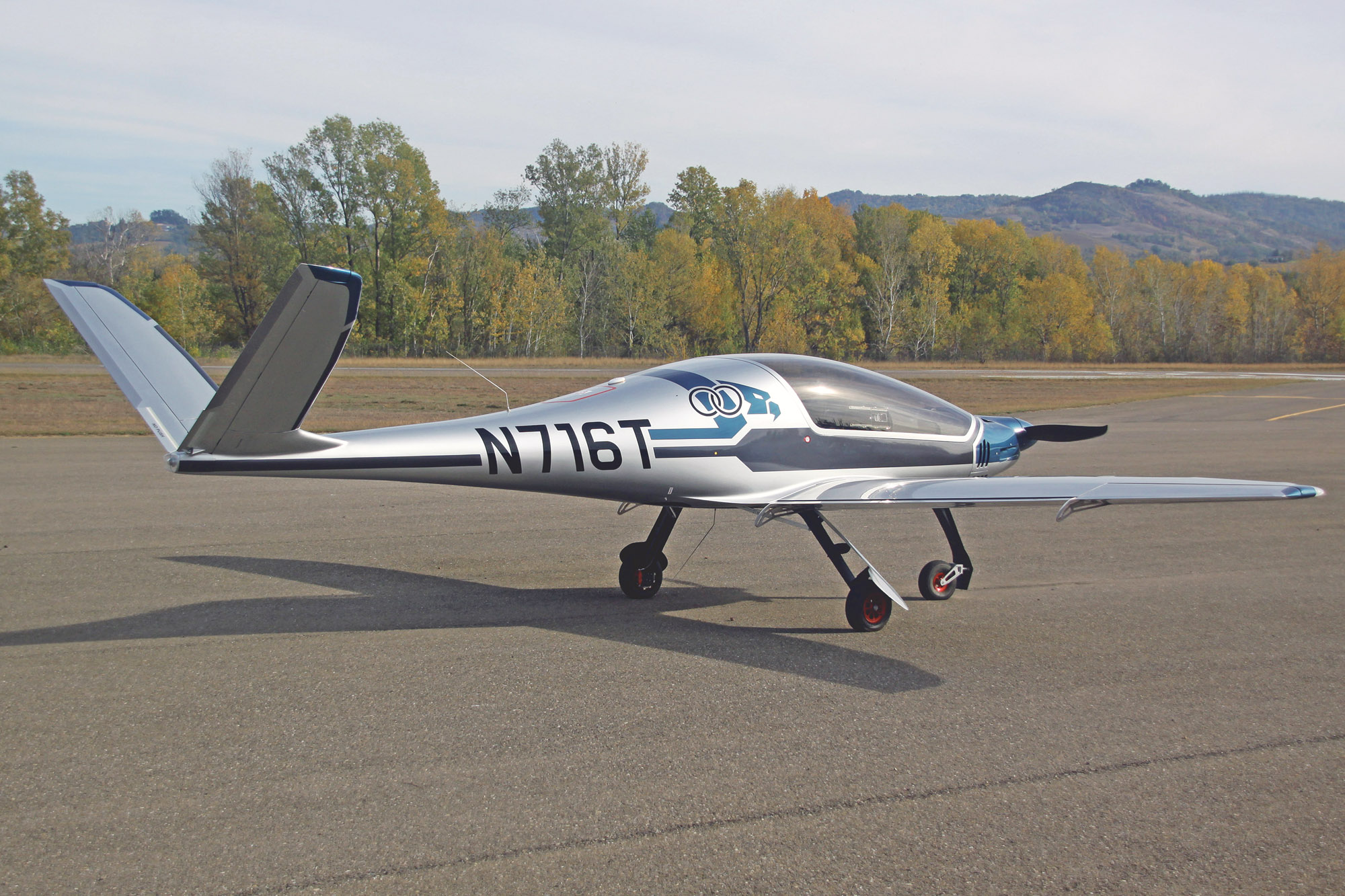

risen from behind showing v-tail
The Risen’s distinctive V-tail arrangement uses a mixer system similar to what Beech fitted to the early Bonanza series, combining rudder-pedal and stick inputs to manage pitch and yaw. It works quite well.
Indeed, the cooling margins on oil appear to be relatively thin. We had to be careful of keeping enough air flowing through the cowling for the Rotax to be happy. Get it too slow and the oil temp would venture into the yellow arc; the coolant temp did not. Is this an artifact of the “point design” of the airplane (meaning it has one overarching emphasis), that is, to emphasize speed and performance? No doubt that’s an influence here.
We ambled up to 6500 feet for a couple of cruise checks. At the rated 75% power, Jardini’s Risen was legitimately capable of 160 KTAS on 4.7 gph. All temps and pressures were fine at this cruise speed. More normally, he pulls back a bit—with full throttle, the prop set for an engine speed of 4800 rpm—and sees 150 KTAS on 3.5 gph, a figure we verified at altitude. Jardini usually cruises at 7000 to 9000 feet, where the slick Risen makes the most of its aerodynamic cleanliness.

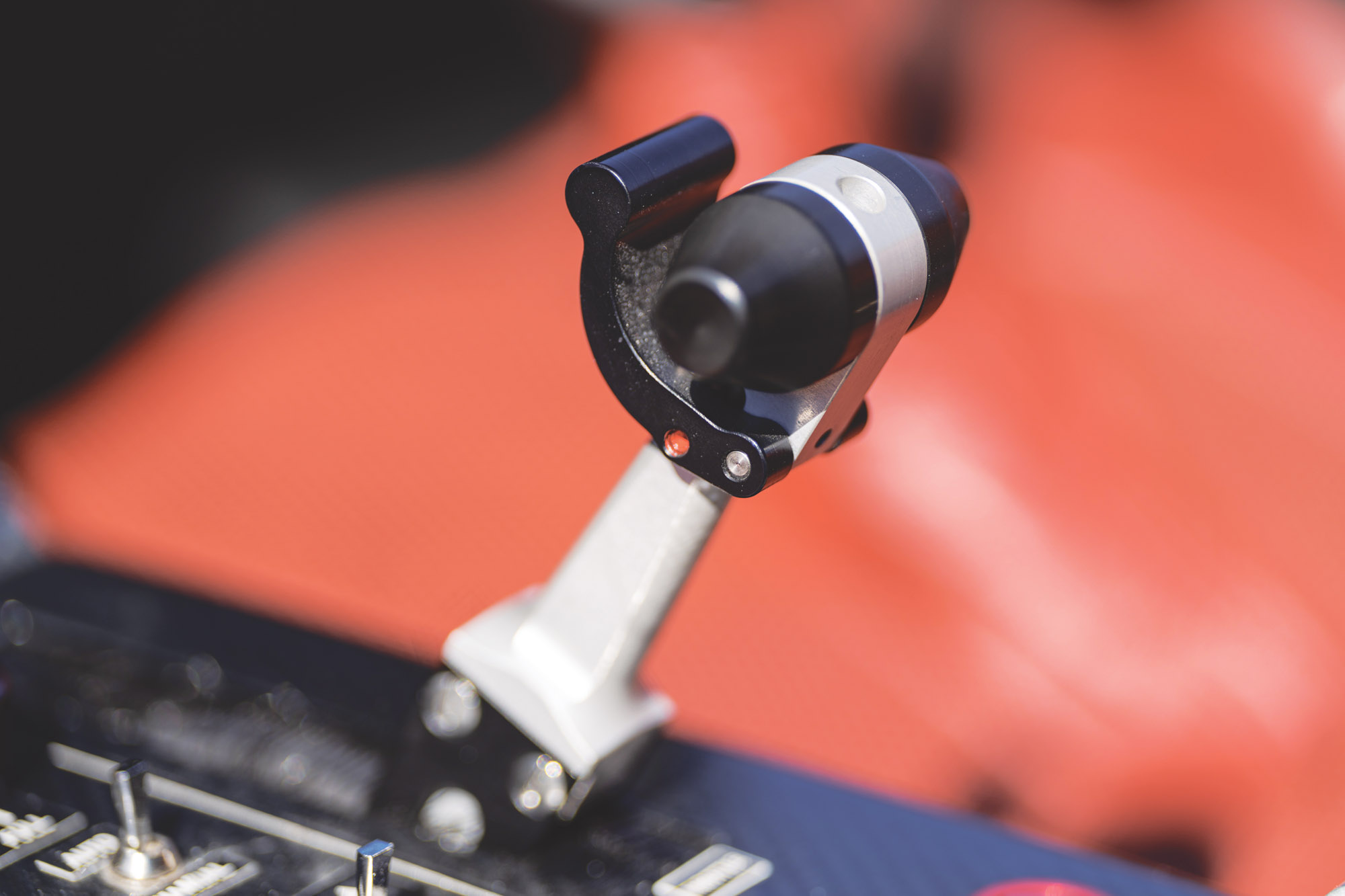

risen throttle
One way to prevent throttle creep with the Rotax—a clever locking mechanism that’s easily overridden for intentional power changes. Sweet.
