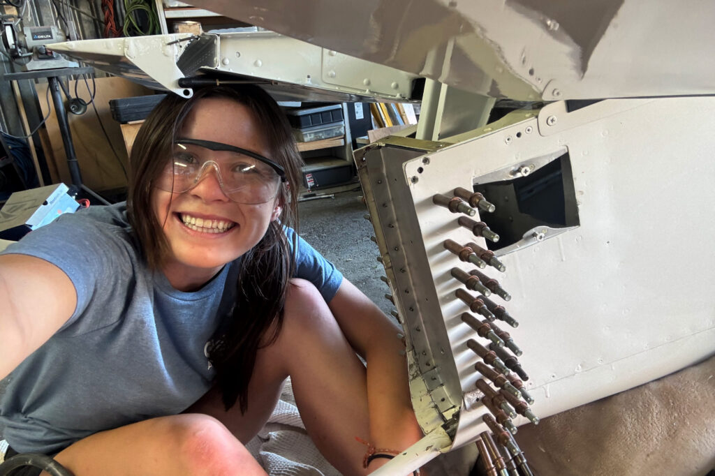

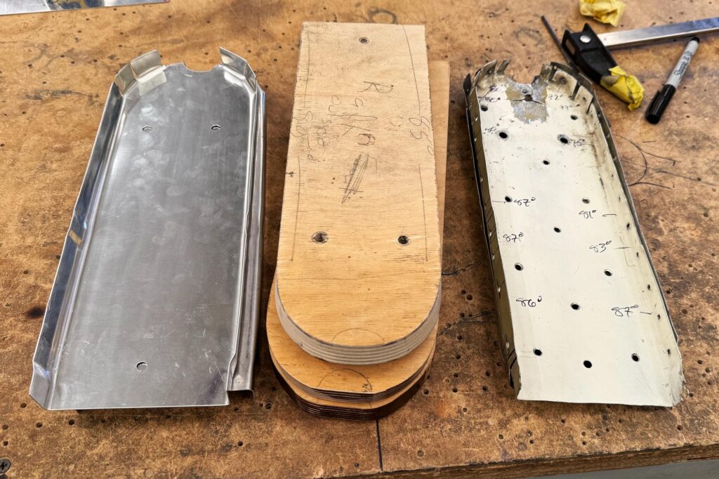

After accidentally destroying my aftmost bulkhead earlier this year, my friend, mentor, and talented craftsman, Ben Marsh, came to my rescue to help fix it. The bulkhead is made up of two F-612 parts sandwiched together. After venturing out to Eagles Nest (CA20), creating the custom parts, and fitting them in my RV-6, we realized the three holes for the vertical stabilizer bolts didn’t quite line up the way we wanted. So, we decided to go back to the shop and make another custom bulkhead.
Ben took it upon himself to make the replacement part. Afterwards, I met up with him and we prepped it for paint. Using three different chemicals and seeing how they changed the metal was really interesting. First, we sprayed the bulkhead pieces with paint booth alodyne and the part turned gold. Then, we sprayed it with a paint booth brightener. “See how foamy it’s getting? So what’s happening here is the acid is chemically reacting with the aluminum part. On a microscopic level, it’s etching the part.” Ben said. After that, we used a degreaser and scrubbed it with scotchbrite. “What you’re looking to do is to take the sheen off of the part,” Ben explained.

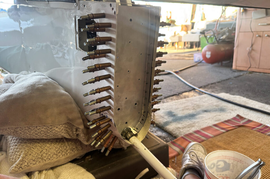

Ben painted the parts and the following week, we went back to Hangar 32 to start riveting. And yes – we needed #30 rivets. Riveting the bulkhead was tough. I had my fears but Ben assured me with his signature phrase “not to worry.” He added, “we will get through this.” Ben’s confidence was contagious and rivet by rivet, my doubts faded away.I held the bucking bar while Ben wielded the rivet gun. One by one, each rivet was bucked into place. The new bulkhead was a perfect military green and I can confidently say that I trust that part to support my plane, thanks to Ben.
Bulkhead is in. What’s next?

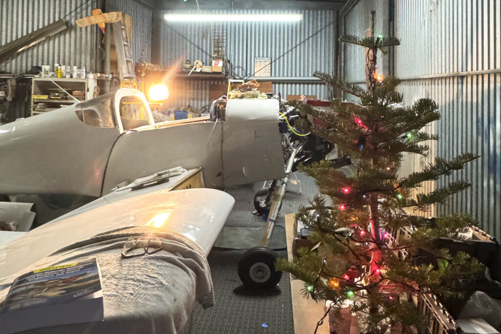

Wrong. Ben and I were excited the bulkhead turned out the way it did. We stood there admiring our work when he paused dramatically and said “that tailwheel ain’t straight”.
We eyeballed, analyzed, and roughly measured.Our attention was drawn to part WD-409, the bracket that mounts between part F-612 and F-611. Part WD-409 is what the stinger attaches to, and we noticed that the hole where the stinger attaches is augged out. Don’t know how it happened but it looks like two holes next to each other, not one clean one. On top of that, the stinger looks to be crooked and where the tailwheel itself mounts to the stinger it’s rotated slightly off.
And we’ve gone down a whole ‘nother rabbit hole.
That Tailwheel Ain’t Straight
To get some more accurate measurements, Ben got a plumbob and showed me how to use it. We confirmed that the stinger is slightly offset, angling left as it comes out the back of the fuselage. And the tailwheel yoke is mounted to the stinger crooked, so one side of the wheel is touching the ground more than the other.
We arranged an evening to meet up with my amazing mechanic friend, Lee Ulrich. “Nope, that’s not straight” he said. I was pretty unhappy that we had yet another thing to fix on this dang airplane, but Ben and Lee both reassured me that it would all work out. They reminded me that sometimes it’s about the journey, not the destination. And, they were both more than willing to help me out.
Fortunately, my CFI and adopted grandpa, Stan Lawrence, had a spare WD-409 bracket and some old stingers from our late and loved friend, Hal Pattenaude. The stingers had already been drilled through, but the bracket was in fantastic condition. I ordered a new stinger and we agreed that when it came, we would redrill the bracket, stinger, and tailwheel in the mill. All at once. And in a straight line.

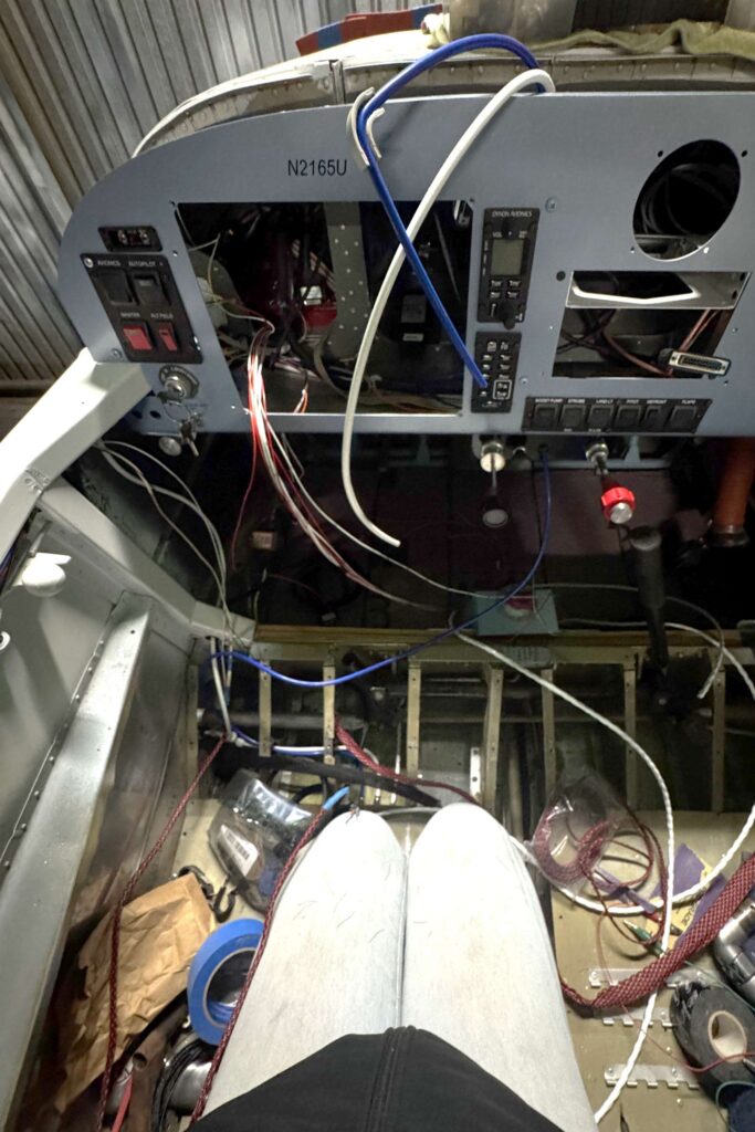

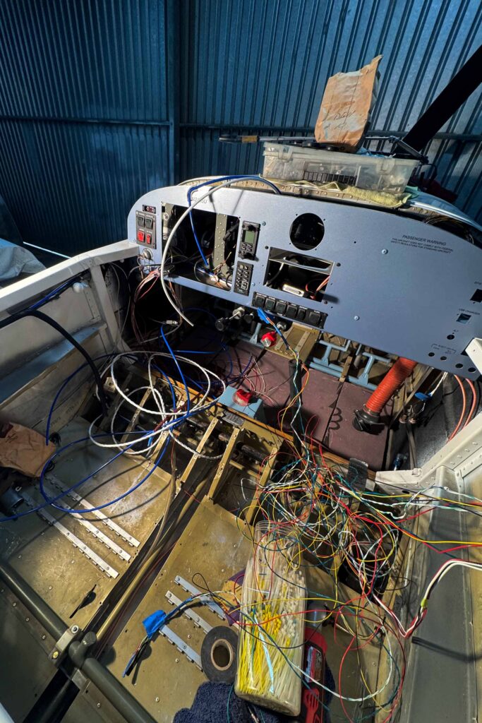

WIRING. Who Trusted me with this??
I never planned to be a wire-er, or an electrical engineer, or anything involving electricity, honestly. My friends Nick and Hal were going to be helping me, but unfortunately they aren’t with us anymore. So I’m figuring it out because it’s my plane. If I don’t do it, nobody will. So, where to start?
So far, we still need to route the wires to the Advanced Control Module (ACM) and attach the ends to their respective places. This includes the lights (navigation, strobes, and landing), autopilot servos, pitot and static lines, control stick wires, ADAHRS, comm and ADSB coax cables, all ELT wires (remote control, power, ground, and GPS data), GPS wire, trim, and flaps.
I have since been looking and analyzing, even to the point where I literally dream about it… Builders, you know what I’m talking about. And I wake up the next morning and have a plan. It’s wild.
The entire central valley was trapped in a thick layer of fog for most of November, so I had no choice but to work on my plane instead of fly. Sitting in the cold hangar for hours with the heat from the light, mapping out where all of my wires will run, was surprisingly meditative and cozy. Occasionally, airport friends would stop by and peel open the hangar door to check in. I love getting my friends’ thoughts and advice. Theres a lot to learn as I’m not only routing the wires, but I’m also figuring out the right ways to protect them, deciding whether or not to use standoffs vs grommets, drilling the holes for said grommets, and figuring out details as simple as the zip tie size for the standoffs.
Once I know what to do, I can do it. So Stan showed me how to read the wiring diagram to verify each wire and label. We checked each pin and soldered and crimped as needed. Then, we realized that three ELT wires and the canopy latch also needed to be connected to the aircraft rear connector, added those wires to the D SUB PINs and labeled everything. We called up Jonathan at Advanced Flight Systems and he was very helpful. I had so many questions but he told me it’s better to ask now than have to go back and try to correct them later.
I spent the evening diving into the memories in the back of my mind from that one time that Kyle had showed me how to attach these pin things to wires. After comparing it with some others, I figured it out. I ran those wires to the back of the plane with my other ELT wires.
One day as I was finishing securing the ELT wires, I was struggling with keeping all the wires on the left side of the fuselage together and away from my canopy latch. “Those should all be protected. And if you did protect them then it would be easier to keep them up and out of the way,” my friend Tommy Ishii said. That sent me down a wiring rabbit hole, because I realized I needed to protect all of the wires I’d already run. And, for the ones I had protected, I’d used the wrong size sheathing.
Tommy came back to help me run my autopilot, static line, re-pin my ELT wires, and secure the headset jacks. We then ran out of expandable sleeving, so I ordered more.

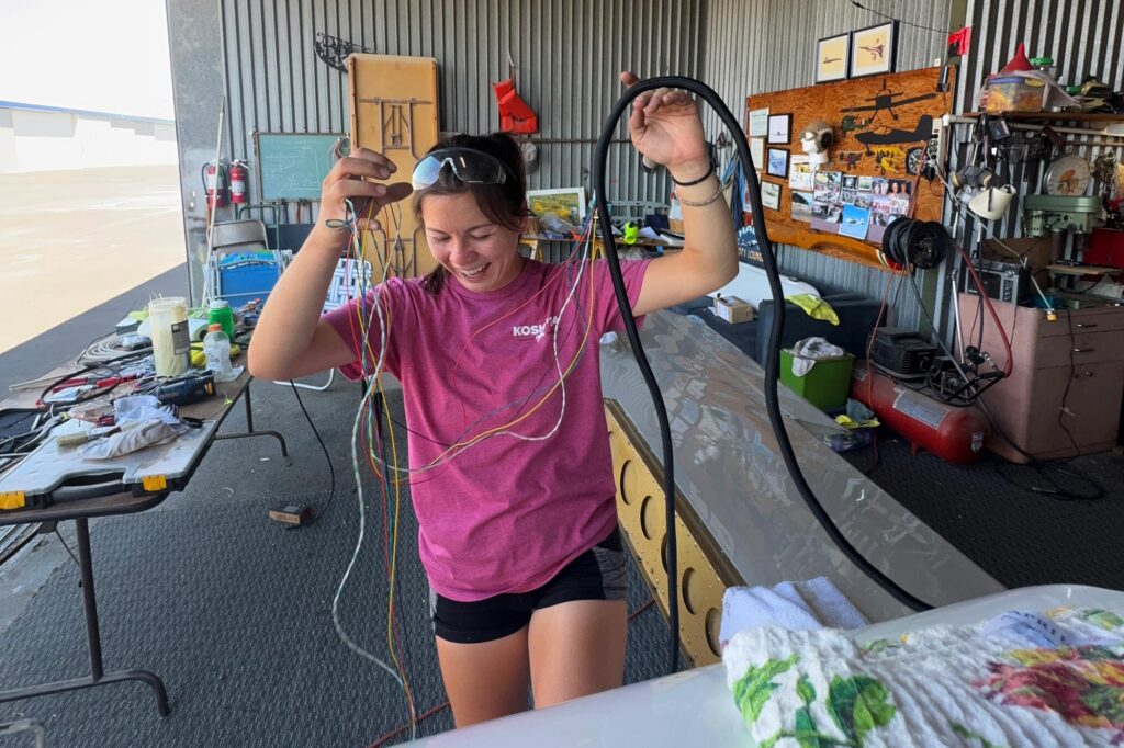

Running Wires for my Lights
Back in July, Tommy helped me with my lights and we secured everything with twisted adele clamps. Then my young pilot friend, Matthew Howell, helped me cover my navlights and map out where to run my wires. That was also huge.
Hal had started on my lights and I needed to go back and continue his work. For the lights, there’s a 25-pin connector that connects to the “Aircraft Rear” section of the ACM. The navigation lights, strobes, strobe sync, landing lights, pitot heat, ELT wires all connect to it. Some wires, like the pitot heat, require the use of two pins, then you solder the wires together and it becomes one wire. I learned how to solder the wires and we differentiated left from right, then mapped out how to run them.
