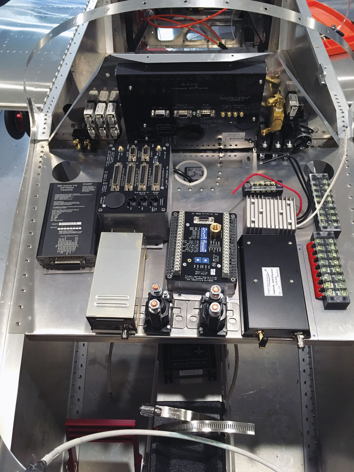

So far, there have been several jets completed with different avionics packages—Garmin, GRT and Dynon are reportedly all represented. Because the panel was originally designed around the MGL, some modifications are required of course—nothing out of the realm of ordinary work for a typical homebuilder, but as those typical homebuilders know, one mod leads to another, which leads to another—and so on and so forth. What you originally expected to be a quick and easy change trickles down through numerous levels, and before you know it, hundreds of hours extra have gone in to the project.
Complicating these modifications in the SubSonex is the fact that the avionics shelf and center console are complete when the quickbuild kit is delivered—if you are going to change the panel depth, then you have to cut into this structure—again, not prohibitive, but something that has to be considered. If you cut down space in the center console, then something else has to give—the factory uses that space for the engine panel, radio head, com outlets and oxygen system. All of these can be moved—it just takes time.
Along with space limitations, one has to consider weight and power requirements as well. The engine puts out a limited number of amps—30 is the quoted number. The engine itself requires 9 of those amps to run, leaving 21 for everything else. But, you never want to load to full capacity, so if you shave that to about 80% (good industry practice), you have about 15 amps to use for avionics, lights, and instruments. This is one of the main reasons that IFR is challenging in the jet—none of the popular IFR navigation boxes operate comfortably within this limitation (and none of them really fit in the available space). Remember that the landing gear compressors draw 10 amps all by themselves, so low-power, efficient avionics are important. Yes, you can rely on the batteries for peak loads—but not forever!
I chose to go with the standard MGL package for these reasons and found that everything fit—but just barely. Adding ADS-B In and Out require additional boxes, and ADS-B Out will be required just about everywhere by the time any project started in 2019 is going to fly—so keep that in mind. I fit most of the avionics on the shelf provided, but the ADAHRS sits on top of the nosewheel well, and the magnetometer is on the floor under the crotch strap attachment point. I also mounted the ADS-B In box on the forward bulkhead—a convenient spot that gave me good Wi-Fi capability to the iPad on my knee.
The kit comes with a complete wiring harness that matches the drawings and includes the necessary contactors, junction boxes, and DC/DC converters. Each part of the harness is labeled and very nicely built. However, there are many short segments of wire that are used to interconnect parts of the system, and while these could have been very handy to use, the fact that Sonex doesn’t give you a physical layout for the relays and boxes for which the short jumper wires were built means that most of them simply won’t work. It’s like building a jigsaw puzzle out of random puzzle pieces and no picture of what it is supposed to look like.
Fortunately, the wiring system is extremely simple, and the major wires for the engine and other critical elements are more than adequately sized for the job. You’ll have to rebuild short jumpers, but all that takes is some crimp-on ends and a couple of rolls of 20-, 18- and 16-gauge wire. The kit comes with circuit breaker switches for the critical airframe functions (fuel pumps, air system, etc.), but you’ll have to add circuit breakers and switches for things like lights and radios. I pretty much filled up the blank right side of the panel with these additions and just barely had room to add a flap switch over on the far left side of the panel. I didn’t add much—and there wasn’t much more room to play with.
Chasing Wires
Most wiring in the ship is either confined to the space ahead of the panel (the avionics tray) or runs all the way back into the aft fuselage. The path for those wires running aft is down through the center console, then out to either the left or right lower longerons, underneath the seat pan. Since this is completed when you get the jet, you’ll be fishing wires for a while, building up bundles as you go. The easiest thing to do is know all the wires that you want to run down each side up front, build a bundle, and run them all at once. This sounds like a great plan, but there will always be something else you didn’t think about beforehand that you have to add. Remember also that the pneumatic lines for the gear, the sensor wires for the landing gear up and down indicators, and antenna wires have to be run in this space as well. It fills up fast!
Antenna mounting is also a mild challenge, due to the jet’s size and low belly clearance. In my case, I needed three antennas—one for the com radio, one for the transponder, and one for ADS-B In, in addition to the two GPS receivers—one for the EFIS and one for the 2020-compliant GPS for ADS-B Out. The GPS pucks were simple—they went on the generous glareshield real estate. Using blades for the transponder and ADS-B In was also simple, but placement has to be carefully thought out so that you have appropriate separation—the necessary ground planes—and you have to leave room to insert a jack to lift the plane and places for supports for maintenance.
For the com antenna, the factory uses a bent whip installed inside the nose cone—a clever solution, but one that is probably blanked out to the rear. I wanted a belly antenna, but none of the common ones fit in the available 12 inches between the belly and the ground, I had Delta Pop, maker of antennas for homebuilt aircraft, make me one that was bent to fit in 9 inches of ground clearance and tuned to provide as good of an SWR as possible. You’ll want to get all of the antennas in place before finalizing your wire bundles, of course, so plan ahead!
Building up the avionics on the SubSonex was physically one of the easiest wiring jobs I have done on an airplane because with the windshield removed and the jet on sawhorse stands, you could sit on a stool and work at desktop height right on the avionics shelf. The prewired harnesses for the MAGL CAN buses made signal wiring a matter of plugging things together, and all that had to be routed were power and ground, plus a few serial data lines. There was some fiddly work hooking up all of the landing gear sensors to light the custom LED panel provided by Sonex for gear up and down indications, but if you’re handy with crimps and solder, it is nothing special. Sonex also provides terminal blocks for the ground, plus 12- and 24-volt buses, which makes hooking up the various power wires very neat.
