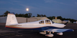

buzzwords aventura
The self-correcting tendency of an airplane to pick up a wing with input only from the rudder is called dihedral effect.
