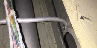

practical electrical 001 2
Many builders achieve functional reliability by including a variety of components that can do the same job.
