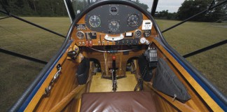

Another memorable airplane is the Hatz biplane built by Ron Sieck [“Hatz Classic,” KITPLANES, June 2010], not only his first airplane but also his first major project. The craftsmanship was impeccable, but the plane also implemented a theme—it was built to look like a classic Waco biplane, with custom details such as three-panel windshields with one-piece surrounds. The instrument panels, front and back, look like fine woodworking, and the fuselage stringers are mahogany instead of the conventional spruce. He built seven ailerons to get four that were absolutely perfect, with stiffening corrugations and upsweeps at the tips. Over the years, there have been a number of Grand Champion Hatz, showing that excellence in a simple airplane is enough to win.
